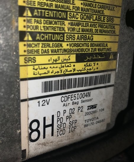

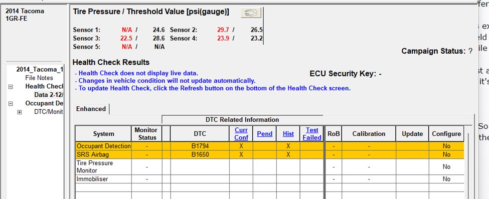

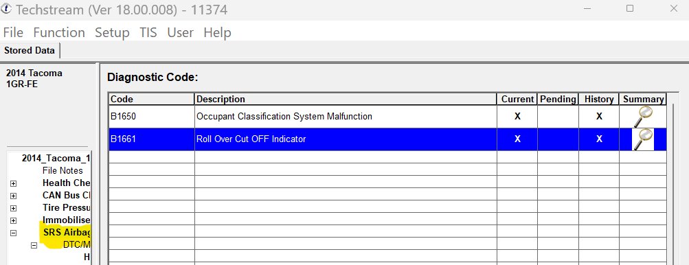

    Sweet - thank you for making that considerably easier than if I'd tried that on my own.
    For the airbag sensor - it would actually show up in Techstream when everything was plugged in.
    1.) Is there a chance it isn't fried or since it interfered with communication overall it should just be replaced?
    2.) If replacing, are there suggestions for it, as my searches turned up a number of avenues to have it reset, not replace.
    3.) Is getting a replacement from a salvaged truck that has been in an accident even possible or feasible? Seems like a working one that is used would be few and far between.
    4.) Can it just be bypassed? :)
    More part numbers:
    CDFE5I004N
    233285-104
    89170-04580

    If it's talking and not affecting communications with other stuff it may be ok, the B1650 means there's codes in the Occupant Classification ECU so you need to check that and see what those are.
    The B1661 is probably because the Meter isn't connected.
    If it does end up needing one being a critical safety component I'd probably go new, looks like they are around $350-400.

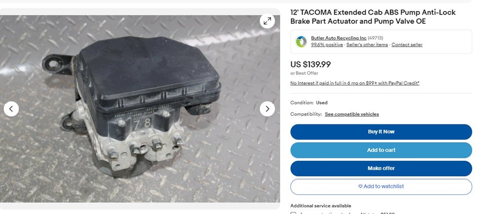

    The AIRBAG SENSOR only seems to talk when the BRAKE ACTUATOR ASSEMBLY (SKID CONTROL ECU) is connected.
    With everything connected, the CENTER AIRBAG SENSOR ASSEMBLY has always reported for duty, along with the Immobilizer and the Tire Pressure Monitor. I've never seen the BRAKE or the COMBO METER (old one) connect. The replacement Brake part is on the way. I ordered the entire assembly, but to answer our question about whether that assembly comes apart, lookie at what I stumbled across:
    Ebay Link
    It looks like it will come apart, but I'm not sure if that is enough to prevent a re-enactment of Spindletop in my workshop :) I won't stress over it just yet.
    I decided to wait on the Airbag sensor to see if by some fluke the canbus gods will have mercy on me and allow everything to connect when the brake part is replaced. I did get the new Combo Meter installed. The meter has the same indicator lights on or flashing as the other one, but they are probably valid since some of that stuff is disconnected. I can see it on Techstream though, which is a first.
    I still have the blasted Blower Motor connector to fix, the DLC to reassemble, and that clip by the alternator, plus the trailer lights, re-wrap some wiring, and basically put the whole damn thing back together and that makes me tired thinking about it.

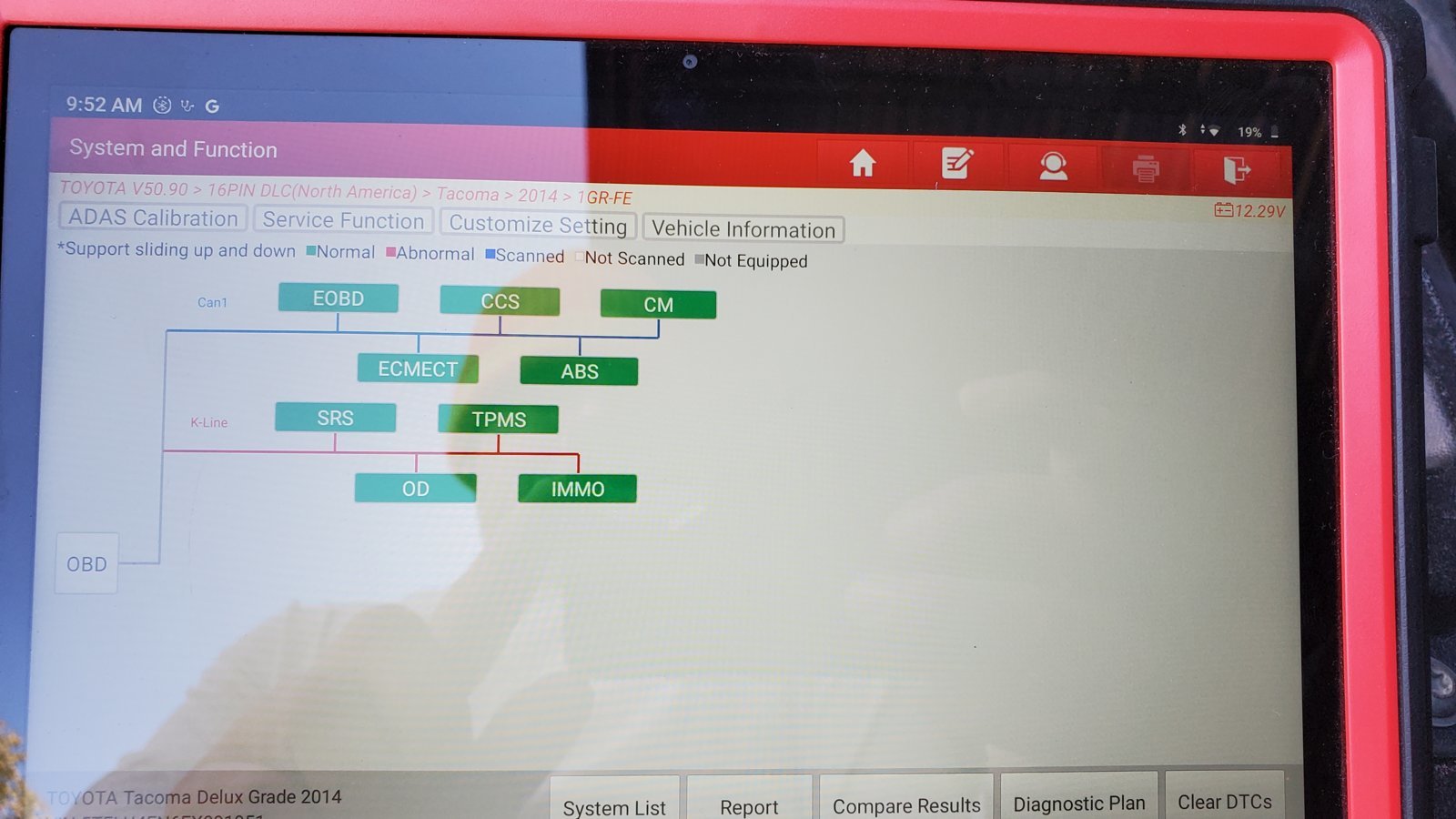

    Interesting I'm not 100% sure which line the scan tool talks to it on, if it talks to it on CAN or on the K line (SIL terminal) (Pin 7 of the DLC) or if it tries on CAN and falls back to the K line if it can't talk on CAN.
    I may plug in my Launch scanner that shows network topology tomorrow and see what it shows.

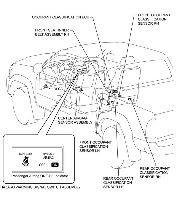

    Can you talk to the Occupant Classification ECU?
    I know it comes apart, the question is whether or not the screws will come out so it can be taken apart. The nice thing is you can plug it in first before doing anything and make sure it talks.

    Ok so according to my tool the SRS talks on the K-line so makes sense it still talks when the CAN line is messed up.

    I don't recall ever seeing an Occupant Detection module with any of the Techstream scans. There was a reference to OD in the Airbag codes, but the driver seat is out of the truck and the passenger seat has something unplugged under it as well. I just caught that a couple of nights ago and need to ask why he unplugged it. Seems like it was related to a seat heater or something. I actually didn't realize there was a separate ECU for it - is it called something else that I can search in the FSM?

    Not super crazy, I got it on sale for $969. There's plenty cheaper options out there that do all the same functions but don't have the network topology.
    I wanted one with topology, it can make troubleshooting no-coms easier on these newer vehicles that have 20+ modules running on 3 or more different networks.
    Yea the SRS is on both, according to service info and my scan tool it talks to the scanner on the K-Line. It's curious that it won't talk with the ABS Disconnected though (I may have to do an experiment;)).
    As for the K-Line (Toyota does not call it this, on the wiring diagrams it's labeled SIL) it's just another communication bus but it's single wire and does not use terminating resistors. On 2nd gens it's only used for module diagnostics and for the modules to talk to the scan tool, it's not used for module to module communication.
    The TPMS, SRS, Occupant Detection, and Immobilizer modules are on the K-Line.
    I'm not sure what we could check there, the CAN signal looks like garbage with the SRS connected weather or not the ABS is connected. I think get the replacement ABS plugged in and see what we can talk to.
    It's called the Occupant Classification ECU in service info, it's under the passenger seat so I bet that's what's unplugged.
    It's job is to tell the airbag system if someone is sitting in the seat or not and how much they weigh so it can decide whether or not to deploy the passenger airbag in a collision.

    Nice. The truck knows how much I weigh :) So I stand corrected on this Occupant ECU. It looks like it was there on 12/31, but hasn't made regular appearances in Techstream though. It was always the same 3 modules TPMS/IMMO/SRS. I didn't disconnect anything on passenger side myself, but next time I'm out there I'll get a better look at it.

    This is the truck it came out of lol:
    or better yet, maybe this one:
    I forget how she (FedEx support) worded it, but there was inclement weather in that area and most likely the package fell off the truck at one of the hub stops.
    This is the photo of what I bought...
    ...which is the same part I got with the same writing and tag on it. The seller refunded me, so I guess I'll let her know everything in case she wants to pursue a refund from FedEx.
    I guess I have a week to read up on bleeding brakes and replacing this thing as a whole unit. I look forward to my first 'torque' if applicable.
    TnShooter likes this.
