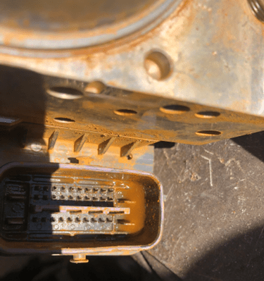

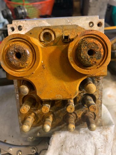

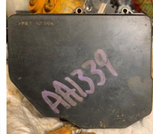

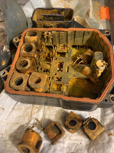

    Wow they must have stored that in the aquarium lol.
    That's not the fault of the shipping company, whoever pulled it and boxed it wasn't paying attention that it was full of water.
    Normally it would come right apart with the screws out but it was rusted solid lol.

    I wasn't sure if it was some kind a mud-water vaccuum holding it together or, as you mentioned (something much more realistic), rust :)
    I'll just write off that whole disassembly attempt as a one-off on things the way they really should not have been.

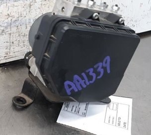

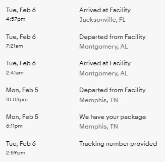

    So after a week of waiting on the new part to actually ship, but not getting notice of shipment, I decided I would try a third time to procure this thing. I log in to start searching and see notice that the part I purchased last week has in fact shipped, and will be here tomorrow.
    This shipped UPS Ground, possibly in a DeLorean judging by the tracking timeline. That is some seriously fast shipping that was included in the $100 price. I guess we'll see what arrives tomorrow. I do have a 3rd one lined up just in case.

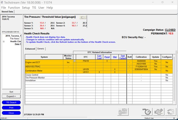

    I saw the options related to it in Techstream, but for everything I've watched and read this past week, I never came across anything about having to use it.....but I've also been searching the generic 2nd Gen Tacoma Brake Bleed, etc. This qualifies as a double-the-moron effort on my end because I never searched Techstream Brake Bleed OR Brake Actuator replacement brake bleed. Did not check manual either duh. Used Techstream in search just now and omg there it all is. I'll be reading a little more tonight with hopes of attempting tomorrow. Thank you for the reality check :)
    The Brake Actuator part arrived on Wednesday, just as the tracking indicated. It is clean and pristine, almost like it was never installed. Plugged it in and it seems to work. This was just the test plug-in and not any type of installation of course.
    Regarding the wires under the passenger seat, I looked under there and it appears I was wrong about them being disconnected. They are all connected, but just kind of hanging there. I’ll double check all the connections and at least get them tucked away this weekend.
    In case there are codes related, the driver seat is still disconnected and out of the truck. I hope to be putting that back in this weekend after I get the carpet all cleaned up

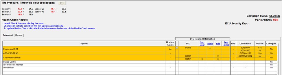

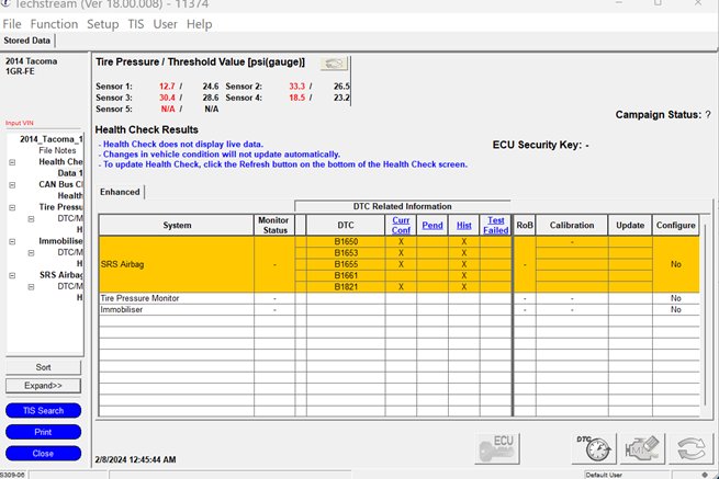

    Below are some screenshots from Techstream; I must have missed one of the screens because I’m pretty sure I saw the Occupant Detector in there somewhere.
    Results of the brake actuator test:
    Brake part connected | airbag disconnected: Communication worked.
    Brake part connected | air bag connected: Communication failed for Canbus, but was ok for SIL(?)
    Brake part disconnected | air bag connected: Communication failed.
    Common denominator for failure = SRS Airbag part. I’ve hunted down a few and presume I should get one ordered, but will ask for confirmation from the experts first :). With all of the $500 price tags I see, I just want to make 100% sure.
    These 2 screenshots Brake part connected | airbag disconnected:

    I mean from all the tests it sure looks like it's bad, weather or not the Occupant Classification ECU is alive and ok I guess we'll have to see. Looking like almost every module in the truck got fried unfortunately.
    Where are you finding them for $500, I dropped that part number into google and quite a few dealers show it in the $375-$400 range shipped.

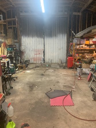

    Hello TacomaWorld. I’m still here and so is the MiracleTruck that rose from the dead. Just passed 18 months since the lightning strike, which has me wondering which TacomaWorld thread would have the longest time taken to get a non-running Taco roadworthy again..?
    We left off with the brake actuator install/brake system bleed, both of which were completed by spouse because he was tired of waiting on me to do it. I helped with the actuator bleed using Techstream. It seems to have worked as there are no codes and the brakes appear to work. Afterwards, I got the truck reassembled with only 3 bolts left over, and I know where those go
    The next day we were able to start it and drive it out of the workshop. Although the mess in the shop is embarrassing, I thought it was neat to see the empty space, so here’s a pic of it:
    I’ll get it cleaned up again one day and post a redeeming pic that doesn’t look like something from one of those Wrong Turn or Final Destination movies.
