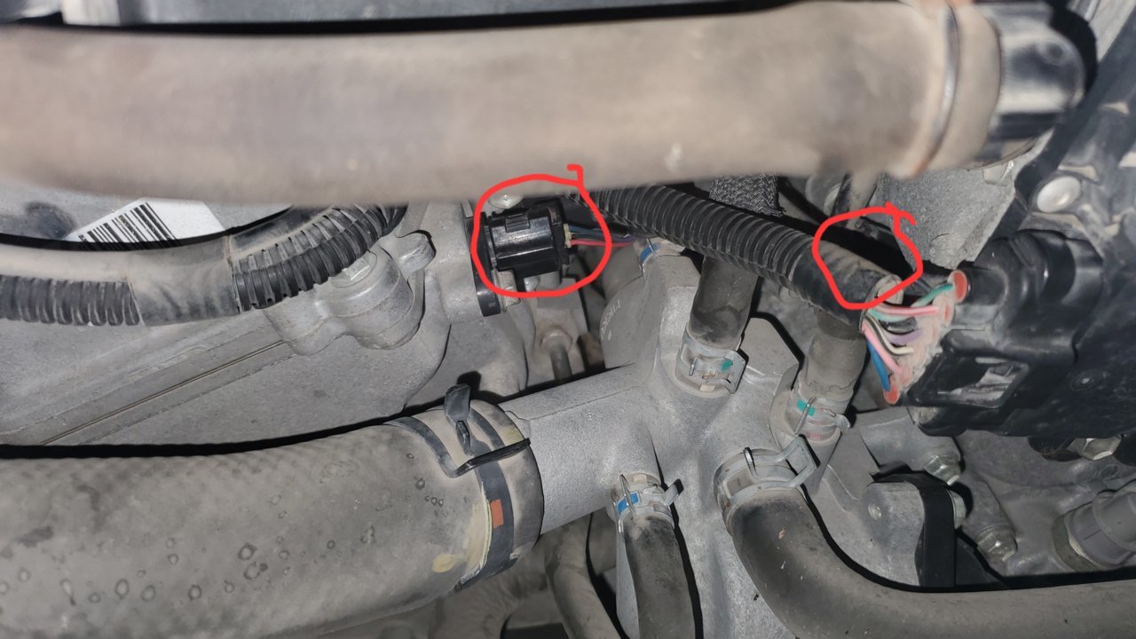

    Next step is to start unplugging 5v sensors while monitoring the 5v ref circuit, we can start with the Secondary Air Injection switching valves on the right side of the engine.

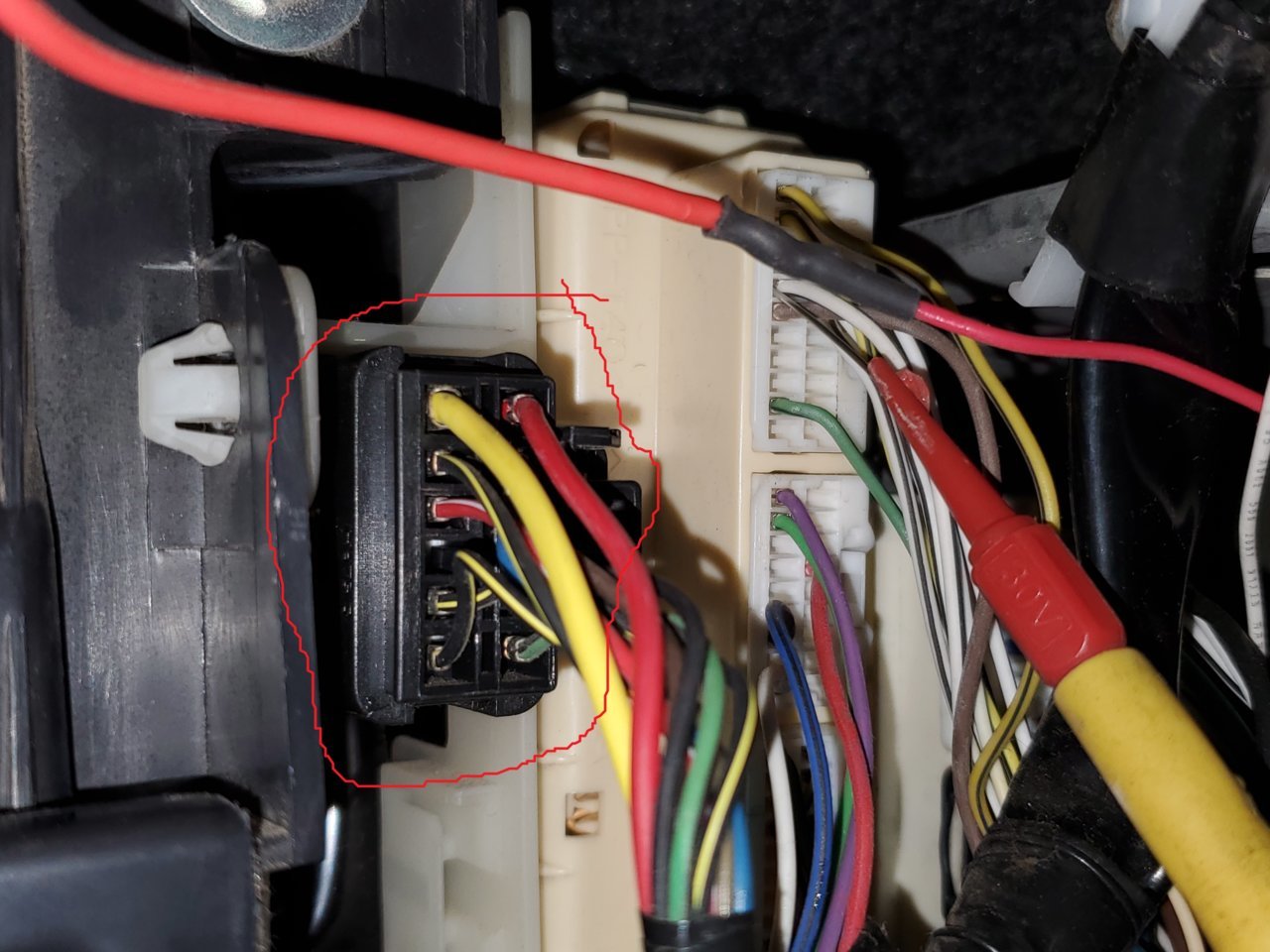

    Correct, I would also expect if you clear the short the CEL should come back on but this may take a key cycle.
    Yes, left is driver's side and right is passenger's side.
    Picture of the valves for reference.

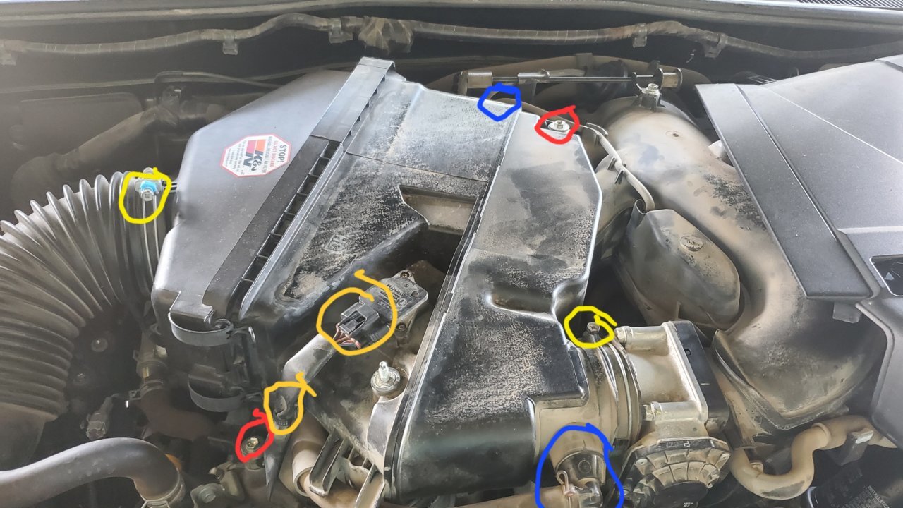

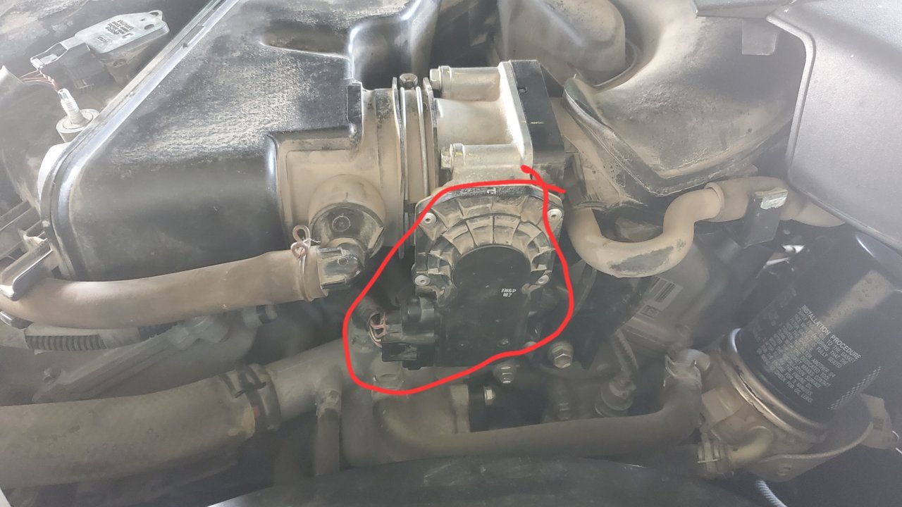

    Throttle body is on the front of the engine, you have to remove the appearance cover to see it.
    The cam sensors are under the throttle body, you have to remove the air filter housing to access them.
    To remove the air filter housing loosen the 2 clamps circled in yellow, the 2 bolts circled in red, 2 hoses circled in blue, and unplug the connector and clip circled in orange.
