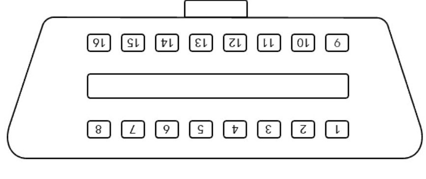

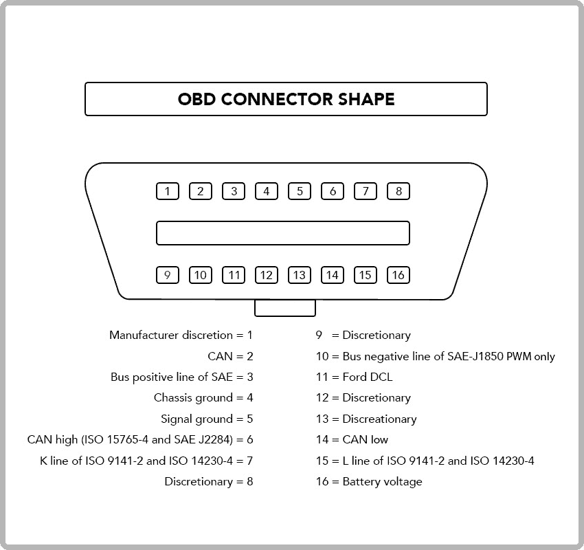

    Are you sure your on the right pins on the OBD port? It's upside down on the Tacoma.

    On the truck it sits like this though.
    Yes pictures of where your testing would help me make sure your in the right spot.

    …….Houston…we have a moron. You are right . It is upside down. I feel like a blooming nitwit.
    one moment please.

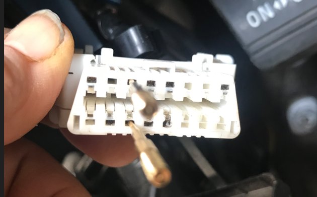

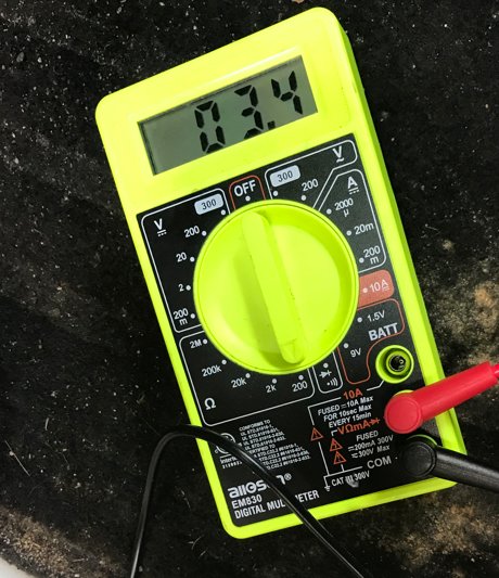

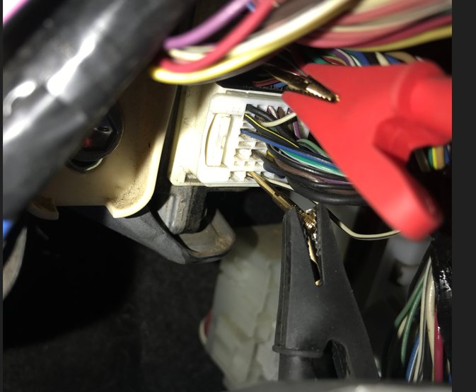

    Here are the pics of the resistance testing for the OBD Port, showing the pins I was connected to and the reading. WARNING - PHOTO DEPICTS FRONT PROBE. Please know the connector was already warped with the one pin hole broken. I have a kit to replace it, along with the blower motor wiring, both of which I located today yay!!. I removed the OBD port from where it is mounted under the dash initially to tighten the pins way back when, but found it was a lot easier to get to this way. Once all of the probing is done, I'll replace it. Also attached is an example of how I was re-testing the 5v. As mentioned before, I only did a few and decided it might not be necessary since I was getting the same readings.

    Yea front probing is never a good idea unless you have the proper front probing pins or something the same size or smaller than the male terminal.
    Yes you want to go from each of your 5v circuits to ground.
    You want to be on your higher ohm setting when checking for shorts to ground, you should see OL or a very high reading.
    You could double check your powers but it's looking like a bad PCM.
    We are also going to need to see what's shorting the CAN bus.
