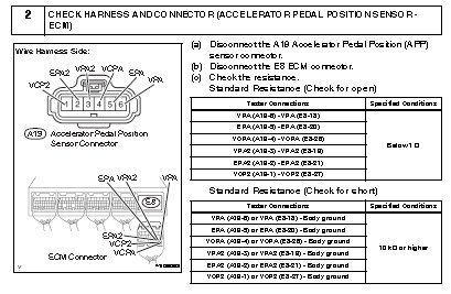

    You had indicated when checking for shorts to ground I should see OL or a very high reading.
    Zero isn’t high nor is it OL… and that is what I got for all 5 of 5v wires when testing resistance, with batt disconnected, meter on 20m ohm the highest setting, black on ground and red on 5v. Any time I removed one of the leads meter would go to 1, so it was making good contact I think.

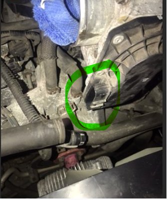

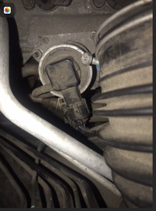

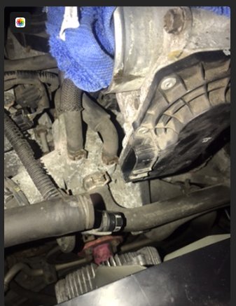

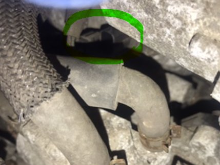

    This is with the sensors unplugged, but not the PCM - I didn't see PCM referenced for this, or maybe I misunderstood. In compiling this response - and thinking I really had it all together with my pics and stuff - I see I left out the Canister Pressure Sensor on the Leak Detection Pump, which required me to disconnect IH1. Is IH1 considered part of the PCM or is there something else PCM related to disconnect? Seeing as I have to go back out already to retest, because I didn't take my complete set of notes with me last night. I swear I get on my own nerves sometimes.
    Below are the pics of the sensors for reference. Would missing that Canister sensor be the reason all of the readings were Zero?
    Secondary Air Injection switching valves - before I unplugged it
    Throttle Position Sensor
    CAM 1
    CAM 2 hiding back there

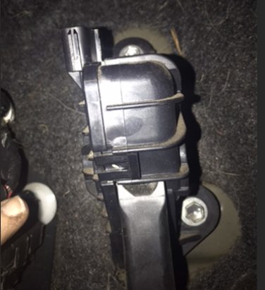

    Whoever designed the install of this accelerator pedal position sensor needs to be drawn and quartered.
    Of course, I still have one more to go.

    Apologies I should have been more clear, I didn't specify unplugging the PCM and sensors. But yes you essentially want both ends of the wire isolated when checking for shorts to ground.

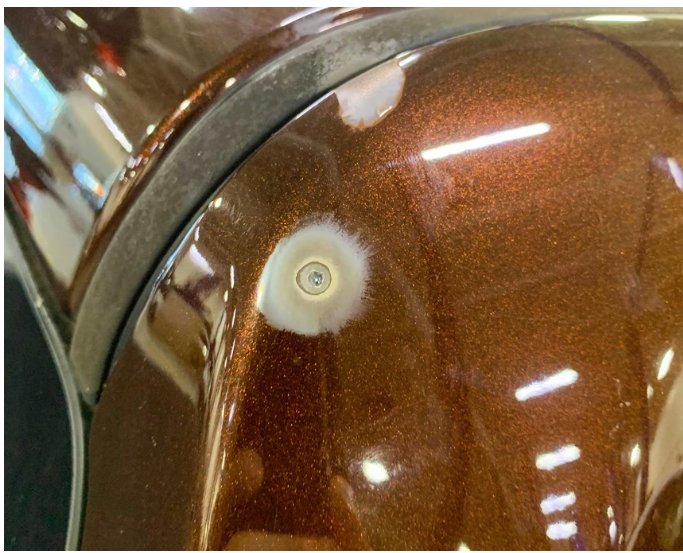

    Back to the Tacoma - I beleive I had this all wrong so I'll make my way back out for a do-over, but it may be over the course of a couple of days. I did want to mention though, in researching testing for short to ground, I began reading up on grounding issues and the havoc it can wreak. A short video posted by Uhaul demonstrated how grounding issues can prevent your Uhaul trailer lights from working. I got me to thinking about how trailer lights never seemed to work when connected to the Tacoma. I tracked down spouse and he confirmed that at some point within the past 3 years, for any trailer pulled - Camper/Boat/Scrap - he could never get the lights to work. I recall him troubleshooting the plug and the trailer, but that was about it. That all being said, I see a diagram in the service manual showing locations of the ground wires on the frame of truck. I know I've seen a few of them; I was going to locate others and see about testing those. If anything, so I can learn about these as well.

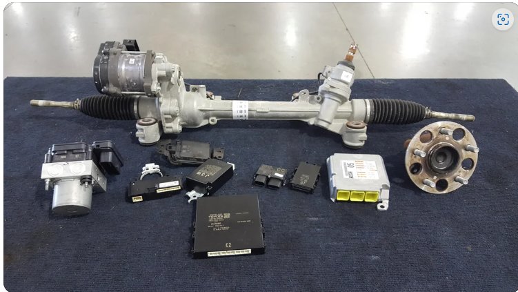

    Last, I also researched a bit on lightning strikes on vehicles, and found an interesting article noting that even an indirect strike can inflict damage. Pics of strikes go from the extreme where the front end of a truck almost melted, to a tiny mark that was barely noticeable. I went back out to the truck to look - still didn't see anything indicative of a direct strike.
    Lesson Learned: Here’s What Happens When Lightning Strikes Your Car | AutoTrader.ca
    Below is pic from article on how minimal of a mark a strike can leave.
    In the article is a link that momentarily had me feeling defeated.
    A small collections of ECU's from a vehicle that got hit by a lightening strike but not directly. : r/Justrolledintotheshop (reddit.com)
    Thanks again for the assistance; I will get the short to ground tested again and report back in the coming days :)

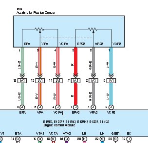

    Actually - you are correct in that I have the incorrect service manual, but surprisingly, I actually took into account the manual being older and the potential for differences, but that can only get you so far. However, I do have current versions of the important wiring stuff right now, courtesy of the 2014 wiring diagrams you had provided at the start and info kindly provided by TnShooter. These are the ones I've been trying to work from:
    2014 4.0L Engine PCM Pinout.pdf
    2014 4.0L Engine Wiring.pdf
    I figured it would be easy enough to correlate the wiring diagram (that I'm still learning to navigate) with a section in the service manual (test this wire and this wire with a picture of the connection).
    Spoiler alert: It isn't.
