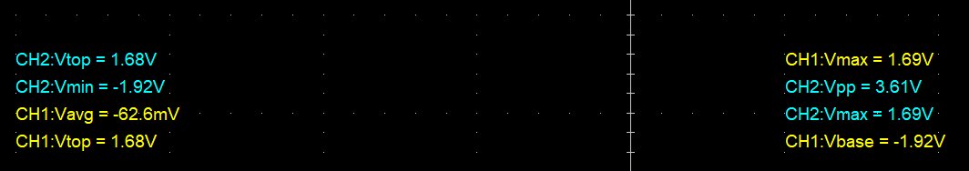

    Hello again - I'm heading back out fully equipped, and to make sure I have this right:
    • I'll leave the scope on the default settings for the Canbus testing, maybe adjust horizontal zoom setting to somewhere around 50-100 us/div. Whatever the setting, will leave it the same for anything tested.
    • Test with all ECUs connected for baseline.
    • Disconnect the relevant ECU - test for 1 (?) minute. Is that long enough?
    • Leave that relevant ECU disconnected and move to the next one. In other words, don't plug it back in when done.
      • Do airbag first since battery is disconnected.
      • SRS (Airbag)
      • Steering Angle Sensor
      • Yaw Rate Sensor
      • ABS
    • Combo meter will have resistor in C9 connector.

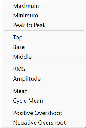

    Here are some of the settings on the cheap scope that I can add to the screen if you think they are of any value:
    This is vertical....
    It's what produces some of these numbers in a more effective order if I add them properly:
    Last, there is an option to export some kind of data from this thing, but it was in a format I didn't recognize. When it is set up, I'll send info on it if there is any benefit to collecting that.
    Thanks again - be back in a little while.

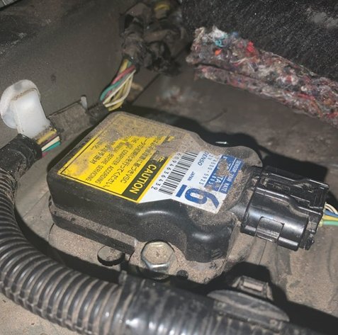

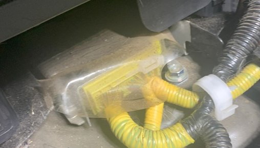

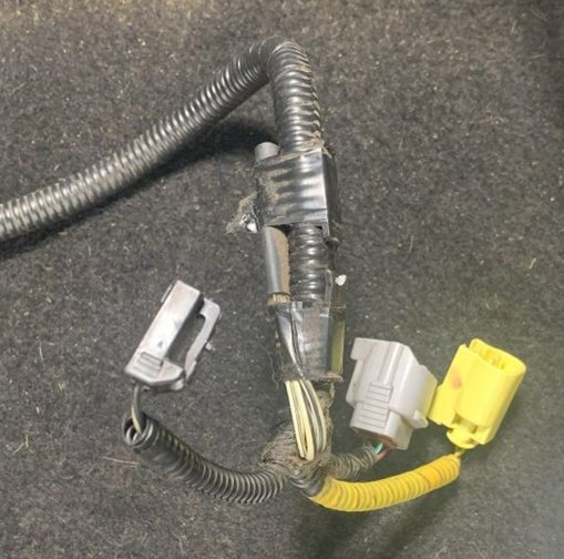

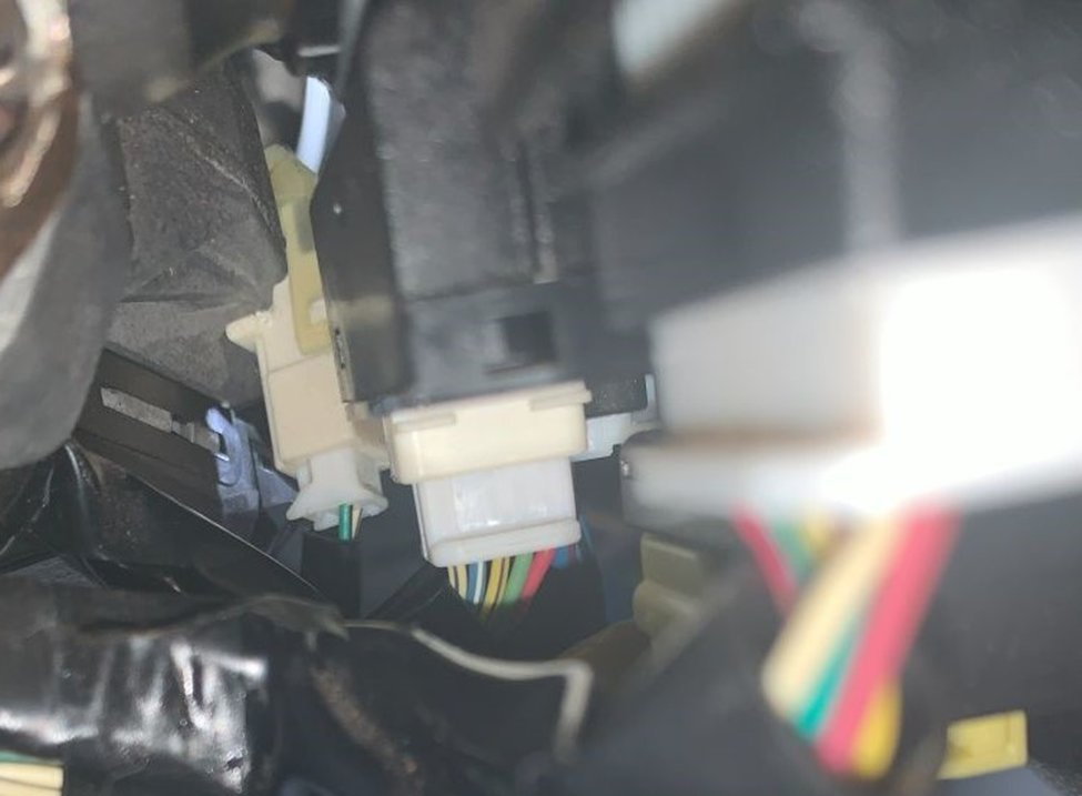

    And I'm back. Here are the things to be unplugged:
    The steering one I was questioning because it seemed to look different in service manual.
    The one in the middle:
    Airbag - underneath where stereo and A/C controls are
    Dirty Yaw - I've vaccumed twice under here if that is any testament to the dirt in the carpet.
    Last, DRC was the file format available for data export. Can't say that I've heard of it.
    Also, these are unplugged from the driver's seat, in case that affects anything. I don't think it does.

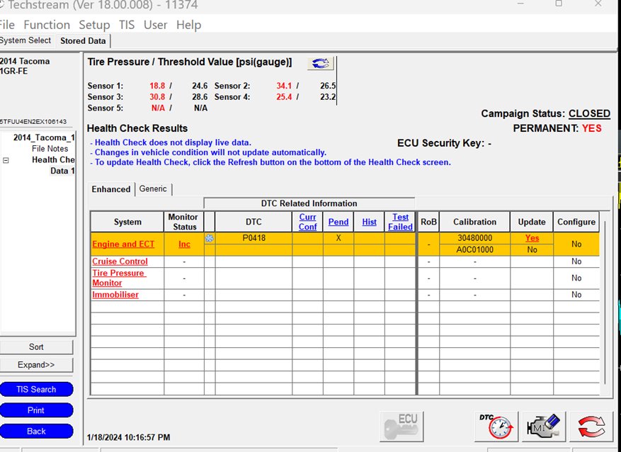

    After unplugging all 4 modules, I can see the ECU in Techstream. Is this part of what we are after?
    Dm93[QUOTED] likes this.
  17. Jan 18, 2024 at 7:30 PM
    #177
    Dm93
    Dm93 Test Don't Guess
    Mar 3, 2015
    #150066
    13,698
    Texas
    2014 DC OR 6spd 4x4
    Predator tube steps, Ranch Hand grill guard, Magnaflow CatBack exhaust, Toyota tool box & bed mat, 2LO Module by @Up2NoGood, Rearview Compass/Temp Mirror, Tune by @JustDSM.
    That's that main goal, now to see about getting it to run.
