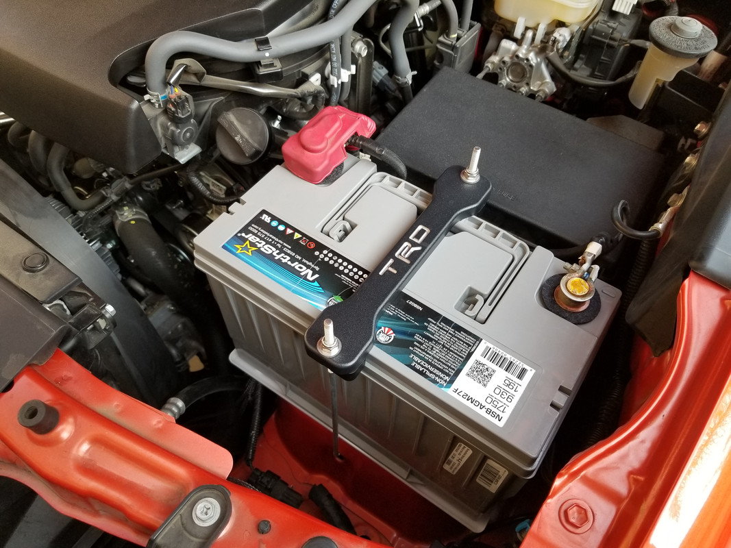

    Dealership replaced. Bad battery, nothing was draining it and alternator functioning as designed. Just a bad battery.
    First dealership (stopped by after getting jumped and on my way to work) acted like they didn't want the work... kept telling me they'd have to keep it a mininum of 2 hours and that it might be overnight in order for them to charge the battery... i said ok, you got a rental for me. They reply "all out". I tell them I'll come back after work, around 3p.
    After work, i decide to try a different dealership and they got me in, confirmed bad battery, and replaced inside an hour. Makes me think I'll need to start using this new dealership with issues in the future.

    Where'd you find the tray?
