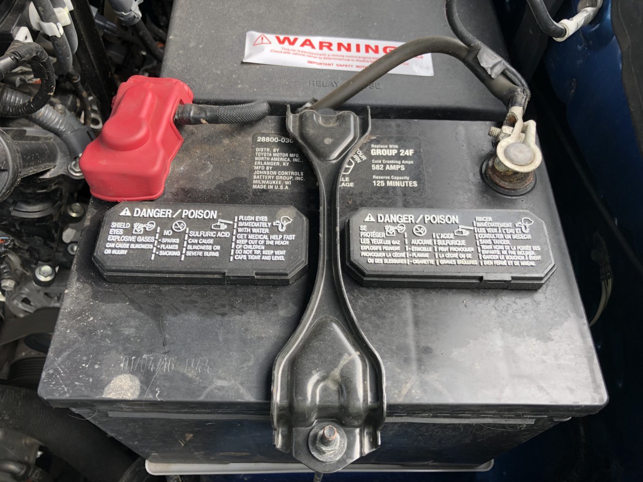

    I'm at 34,000 miles. Noticed the battery is seeping so took it to the dealing to try and get it replaced. They said the battery tested good so they wouldn't replace. I asked about the seeping and they said you have probably been offroading which caused it to spill over.

    I went in for my 15,000 mile floor mat inspection today... I told the receptionist at the service dept that the battery was leaking...
    When I went in to pick my truck up I was informed that the battery was fine. (Topped off the juice and checked out at full charge) I informed her that a leaky battery is not at all "fine"
    She took back my key and paperwork...Ten minutes later I picked up my truck with a new 84 month TRUSTART. They also replaced the Neg cable since it was starting to rust.
    They cleaned up my hold down bracket that had also started to rust.
