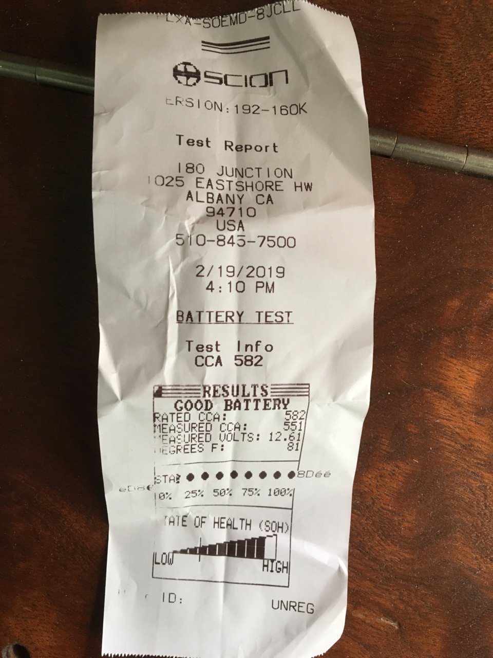

    Stopped by another dealer for a test. The guy said it was fine and handed me this. Died this look like a proper load test?
    Truck barely started again this am. If I leave the lights on for two min it will not turn over...

    You're down 31amps and your batteries at 75%-80% of normal

    Understood, but it’s struggling. As stated earlier, I’m down to under 10v after sitting with the lights on for a couple min.
    The water is down a hair in a couple cells so I’ll pick up some distilled and top it off. I suppose I’m going to just go ahead and buy a replacement.

    A healthy battery should also be 12.8 volts or higher
    If it's struggling to start it could be a bad cell where the plate is starting to sulphate

    That print out is from a Midtronics GR8.
    All manufacturers are going to this type of battery tester. This is something the manufacturers are requiring, not the dealership. If the battery fails there is a warranty claim code at the bottom. The dealership needs to submit that code to Toyota for reimbursement. It will also charge the battery if needed before it will run the test. I’ve seen up to two hour charge time. That’s why the dealership said, drop it off.
    Ok to answer your questions.
    No that machine does not do a proper load test like testers of the past it’s all electronic but it’s what Toyota requires.
    It’s stupid and it causes false tests sometimes but the dealerships hands are tied.
    All that said, as already stated in here.
    The quality of lead acid automotive and motorcycle batterys as been on the decline in the last five or so years. It’s not all of them it’s hit or miss. Some are junk and some last a ridiculous amount of time.
    I would get a load test at a auto parts store, after dealership hours and buy a battery if it fails. Then submit it to Toyota.
