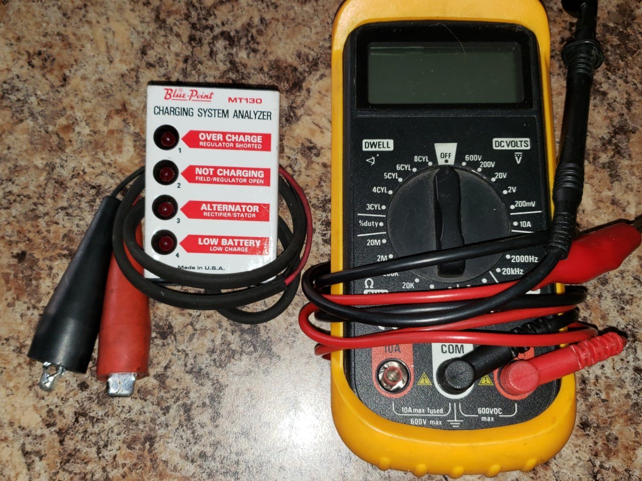

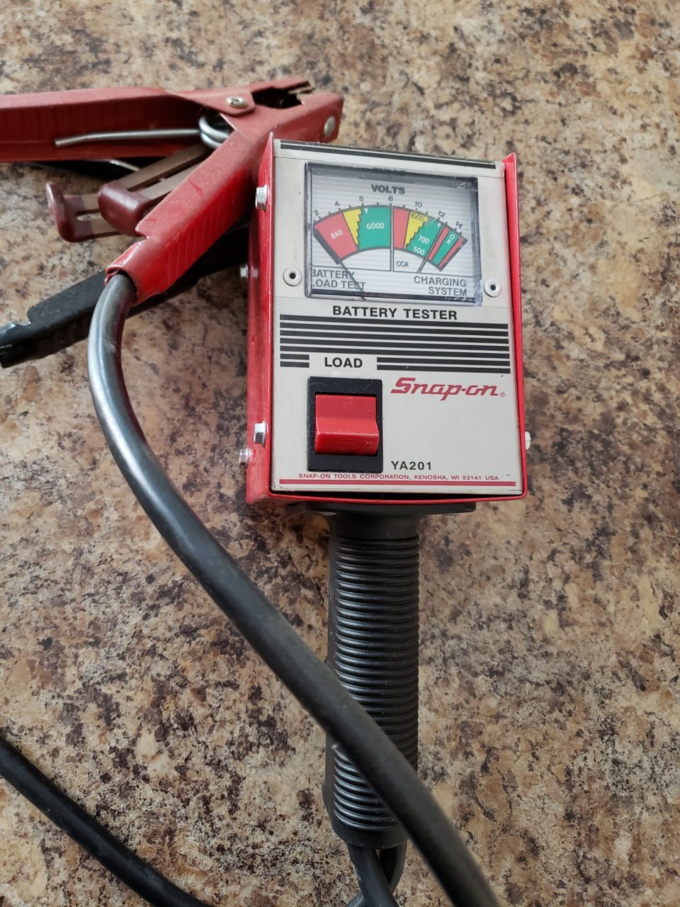

  18. Feb 20, 2019 at 12:52 PM
    #98
    US Marine
    US Marine Semper Fi
    Mar 24, 2016
    #182227
    14,746
    Chuck
    Gallatin Tennessee
    02 Pre Runner supercharged 4cyl
    TRD supercharger , Doug Thorley header , K&N CAI 265/75-16 Toyo open country mud terrain , 15x8 Method Racing wheels , Rancho 3" lift , 4.88 gears , Detroit Locker
    This is all I need to test my charging system and all are very accurate !!!
