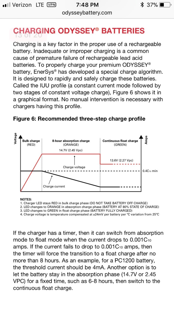

    No, no I wasn’t. Any AGM battery needs a higher voltage to be charged up to 100%. If you have an AGM you should be throwing a smart battery charger on them periodically to ensure they are being charged fully every so often. So, they are not really maintenance free, unless you only want a battery that will eventually only hold 80% charge of what it’s really capable of.

    So I’m trying to figure this out for AGM batteries. If our alternators (less than 14.0v) only recharge to 80% after deep cycle or you run it to say 60%, you’ll need a battery charger that’s ideally 14.7v to get it back to 100%?
    And my next question, if the battery is 100% charged and you never run it below say 90% will the alternator keep it in float 13.6v? at 90-100%?
    Sorry for all the questions, trying to make sense of this.
