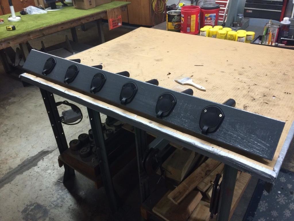

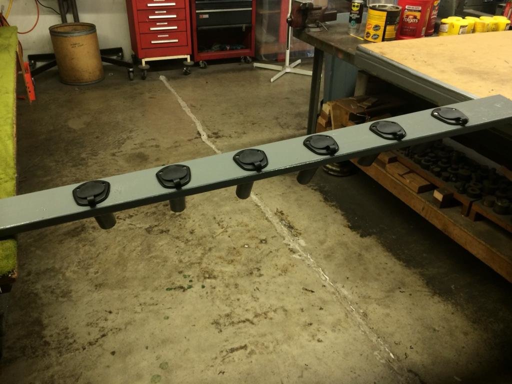

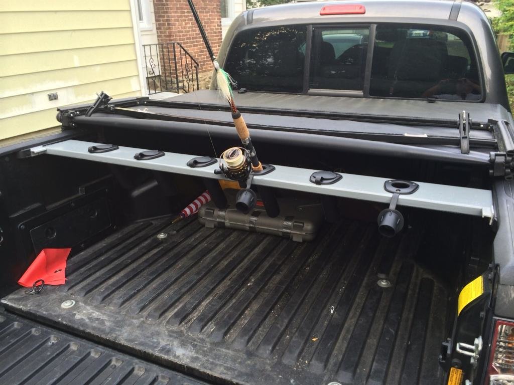

    Just finished this up for my truck.
    I used a scrap piece of 1x6 PT and notched the ends so they would fit snug inside the rails. Cut the holes on a 30 degree using a drill press and 2" hole saw. Finished it up with a few coats of rustoleum I had laying around. All in all it cost me $50 for the flush mounts, 1x6, and ss #10 screws.
    I'm pretty happy with it. Fits really snug in the rails so I might sand the ends down so I can slide it back to fit my bed extender.

    that is real slick :thumbsup:, no issues with them driving down the road and not wanting to bounce out?
    nice work man

    90% of the time I'm just transporting rods to my boat a mile down the road. For longer trips I'm going to add some type of bungee system to strap them down.

    Genius idea!! love the fact i can still use my tonneau cover without taking it off everytime.

    Well done. So what's holding the board down on the corner?
