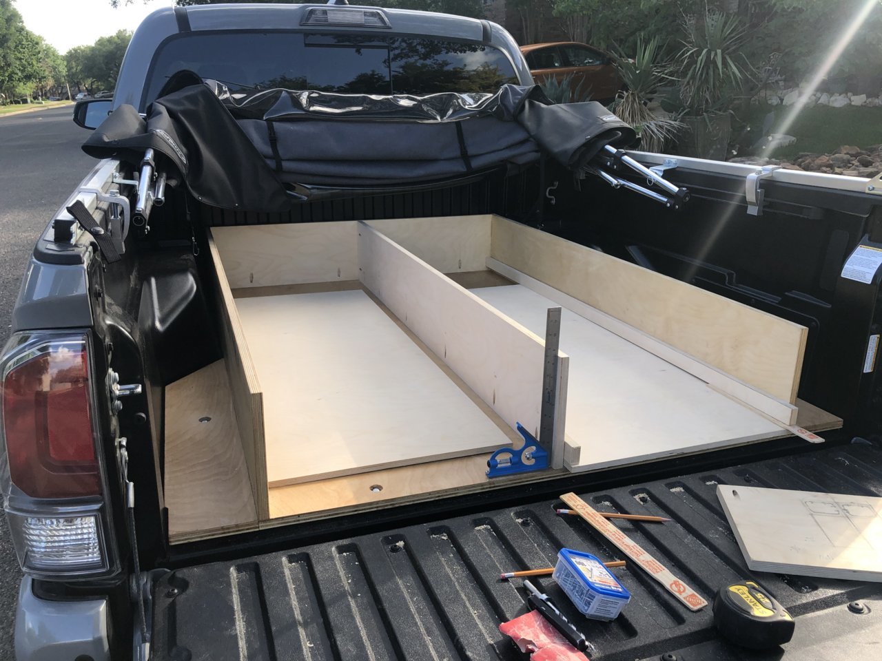

    Figured I’d document my build in the hopes of getting ideas and spreading any knowledge I can bestow onto anyone.. though little.
    This is another drawer build but I wanted to take inspiration from goose gear and tackle my own comprehensive slide build and pick up some more tools along the way.

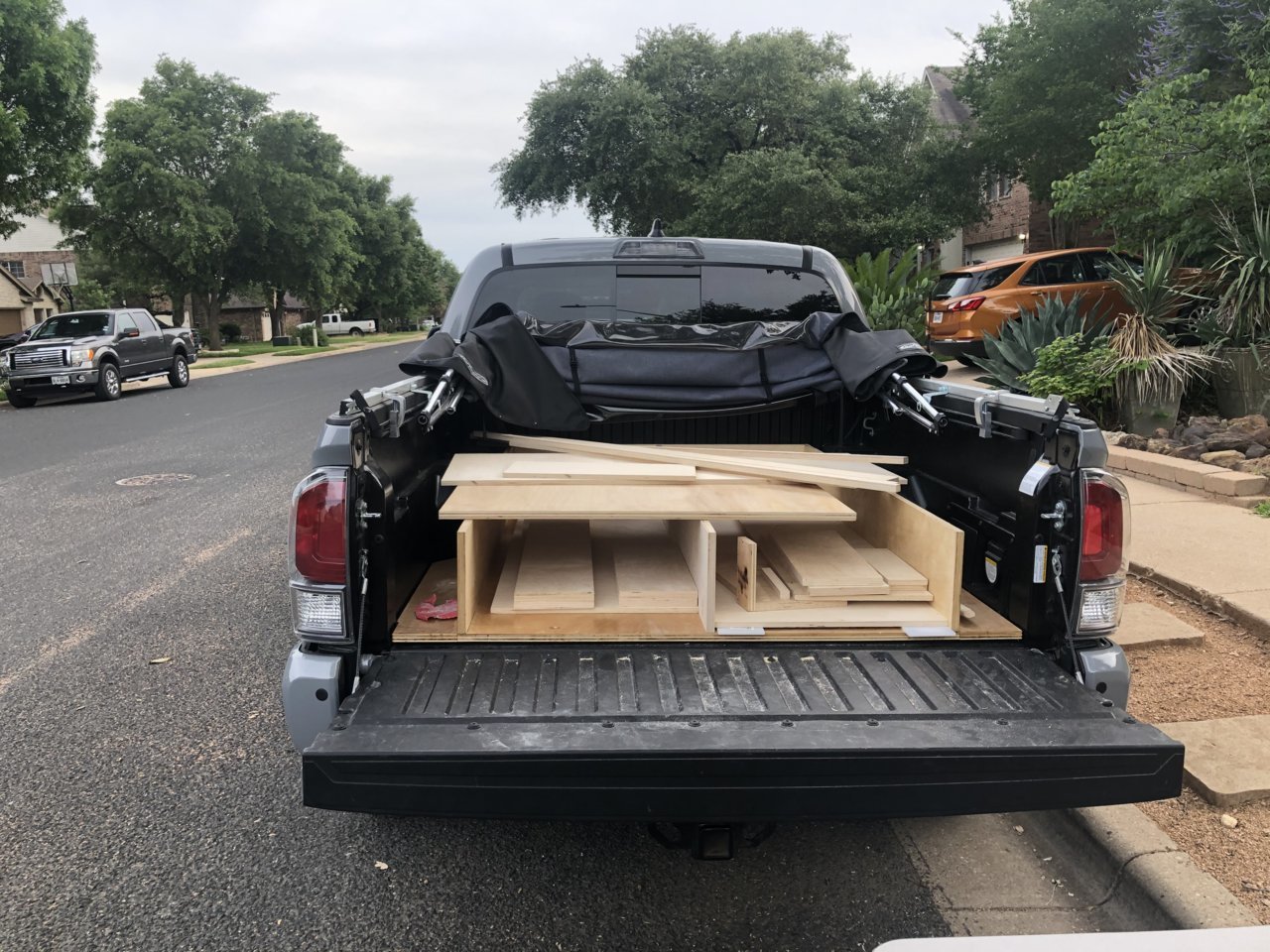

    Day 1
    (This will be short but I created the base to what my entire build will take shape on.)
    the foundation
    Yes I own two cement off roads
    Tools used;
    Skillsaw
    Router
    Dowel jig kit
    Assorted hardware
    Drill
    Fostner bits
    Drill bits
    straight edges
    Levels
    Clamps
    Glue

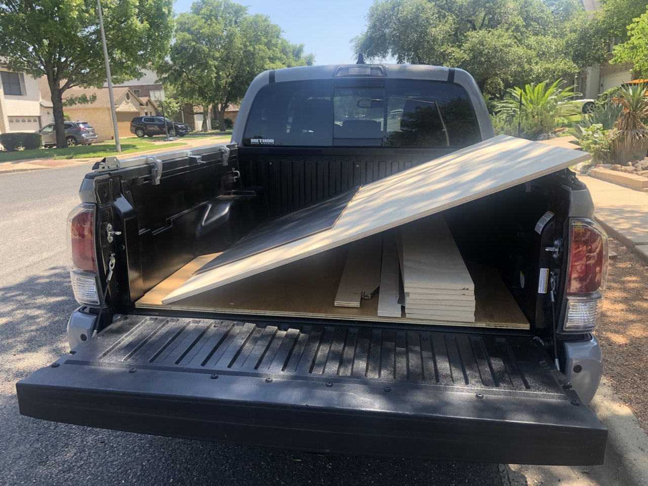

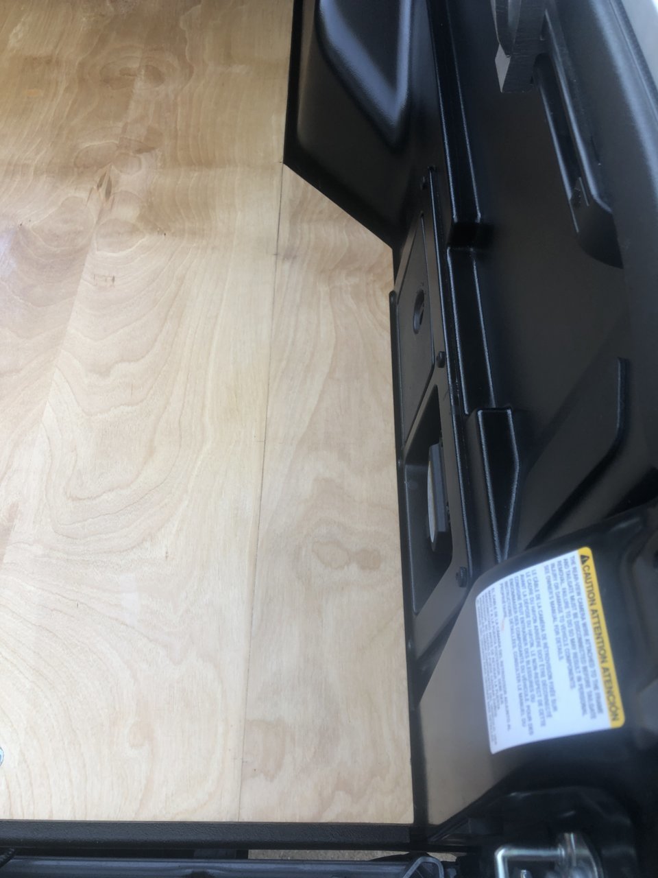

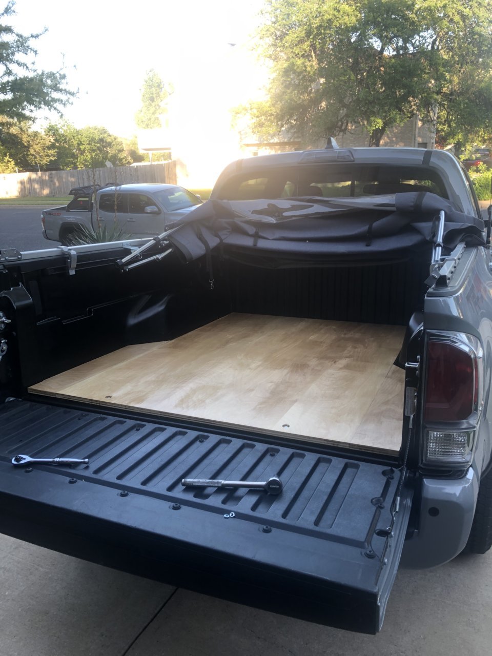

    I had to make a few runs to woodcraft, a Local supplier of awesome wood working tools and Fine Lumber to pick up some more Baltic Birch.
    I was originally going to build the supporting structure with aluminum extrusions but now that I’ll be lifted with the OME Heavy duty kit..I’m not so scared of the extra weight. I also wanted to build with wood.
    I was able to source some 60x60 sheets of Baltic birch which made it easy as far as building supports and creating a monolithic bed platform. I didn’t want to have two separate boards for this.

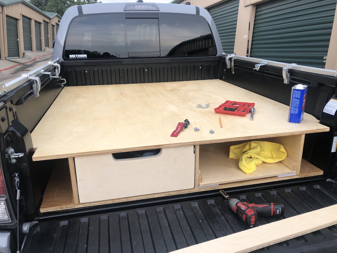

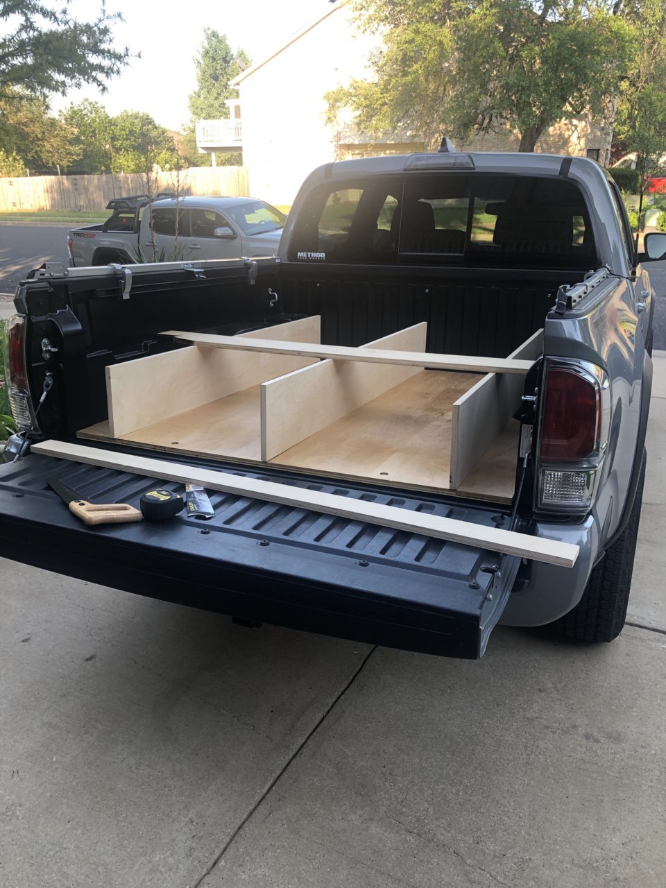

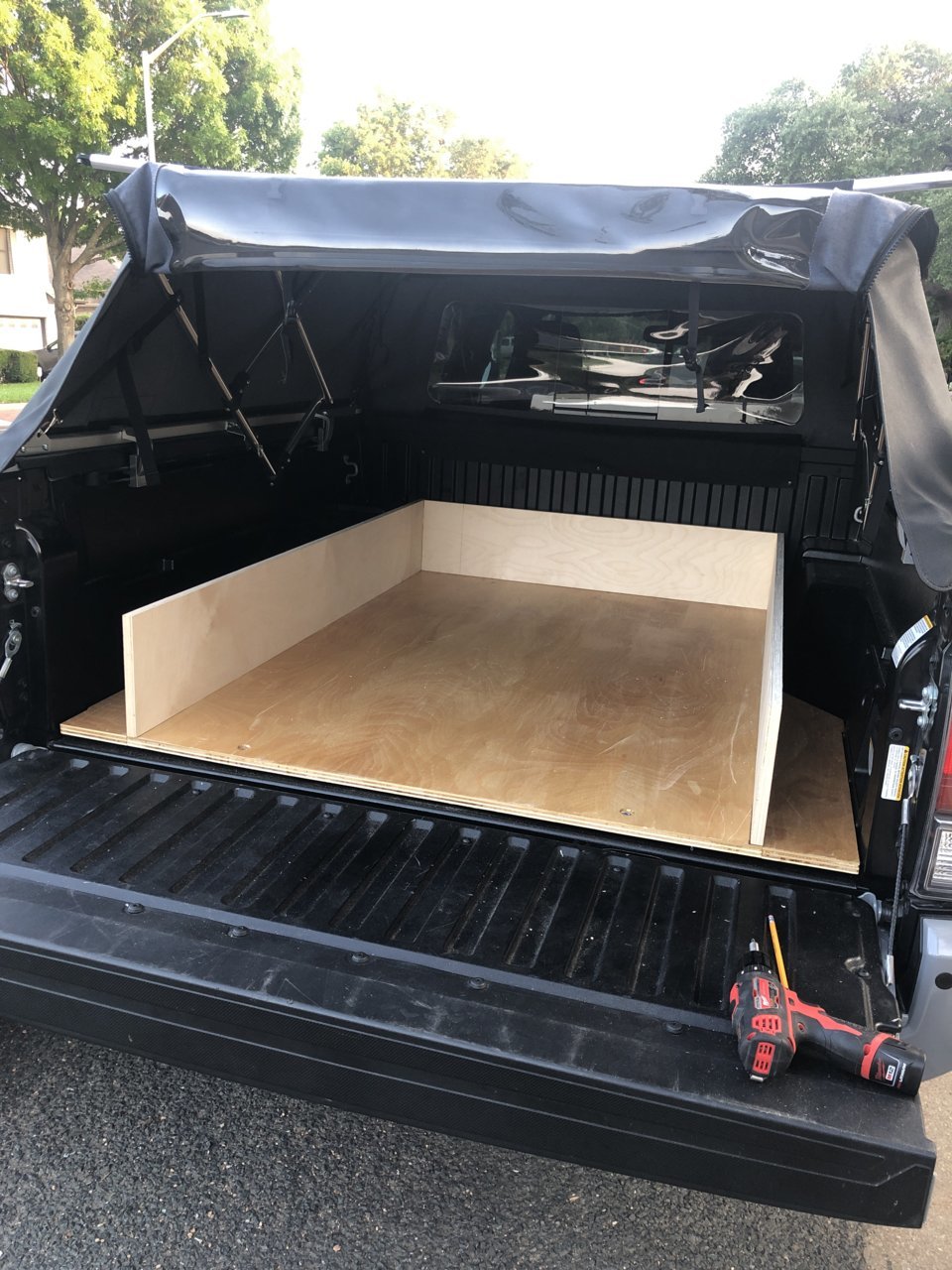

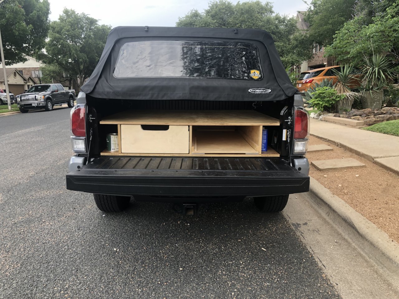

    it’s been a hot one in Texas! I got 6 hours yesterday on the build and boy was it productive. I finally took off the sled and coated the underside with spar urethane and reinstalled; this time anchoring it completely on all four corners and center to the bed. It ain’t going anywhere!
    I’m using a “Krefeld Pocket Jig” to secure the verticals to the base and now that I have all of that done the cabinet is next! The cool thing is that I got those pieces pre cut with my hand saw and should be set to build and mount with my 500 lb bed slides.
    the left compartment is going to be on bearing slides and the right will be a platform slide on low friction plastic and wood guides.

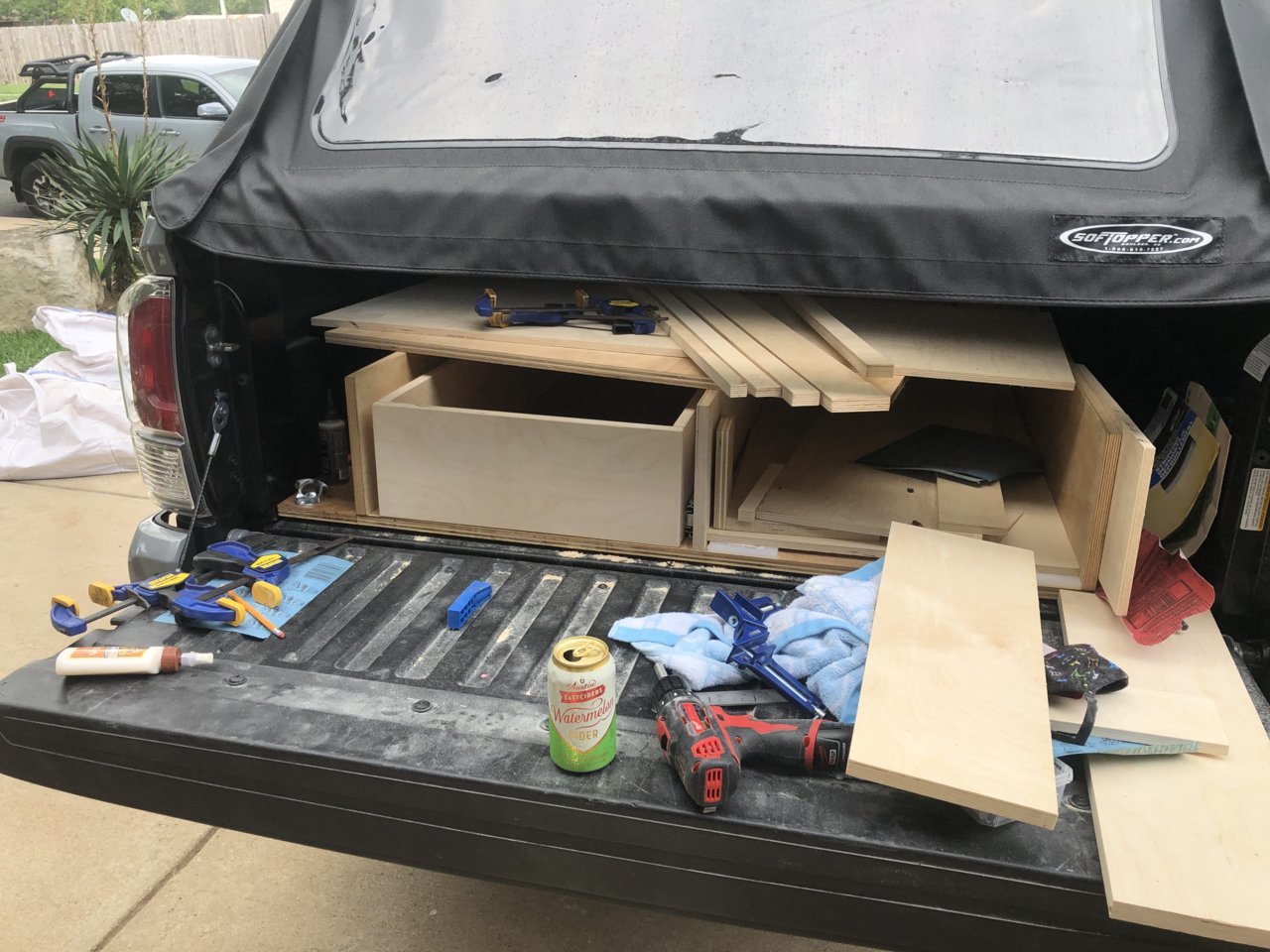

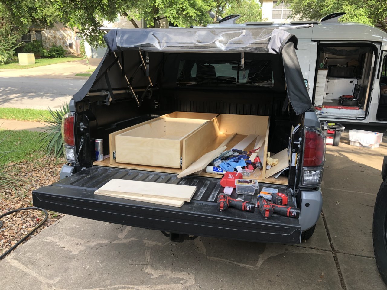

    Day 4,

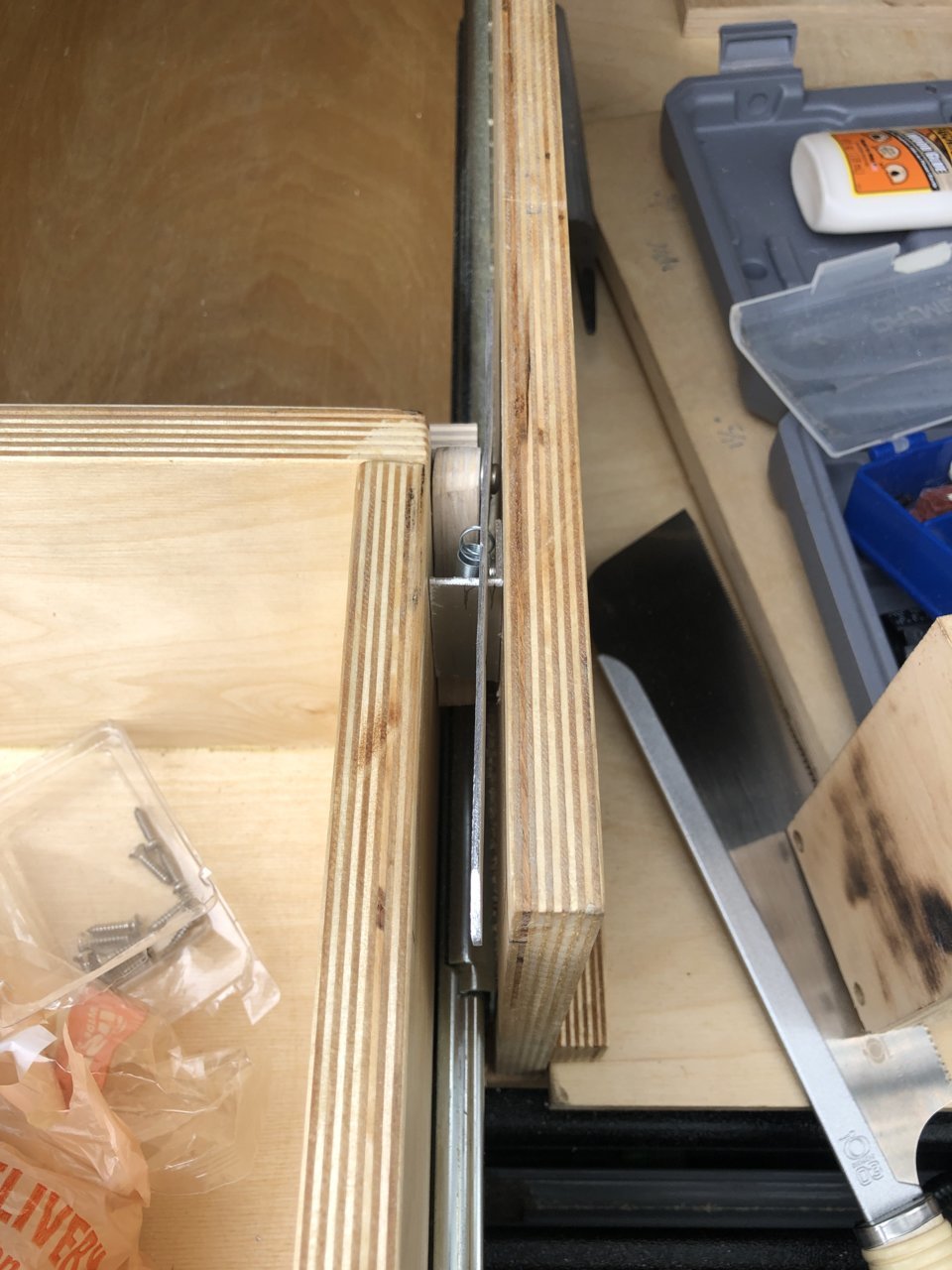

    had to help the misses around the yard but I had a few chances to mess with the truck! I got the drawer frame built and it slides pretty effortlessly with the slides not even mounted with hardware. I still need to plane out the sides a bit to make it glide but I think she’s almost done!!
    The components are coming together and I cannot wait to see this come together. I’m going to spend the next couple of days trying to get some work done but it’s going to be hard with all the forecasted rain.

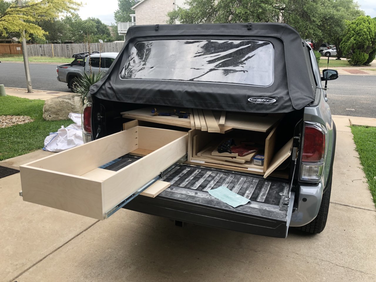

    I got some great progress in!
    drawer slides installed. Coatings roughed in and will be adding coats over the next couple of days.
    Going to get the platform slide installed during the week sometime.(right slide is a plastic (self lubricating) slide.

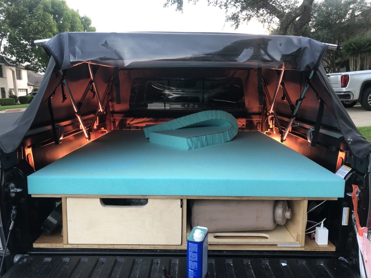

    Today was awesome... I don’t know what got into me but I got some big milestones complete today.
    first off...

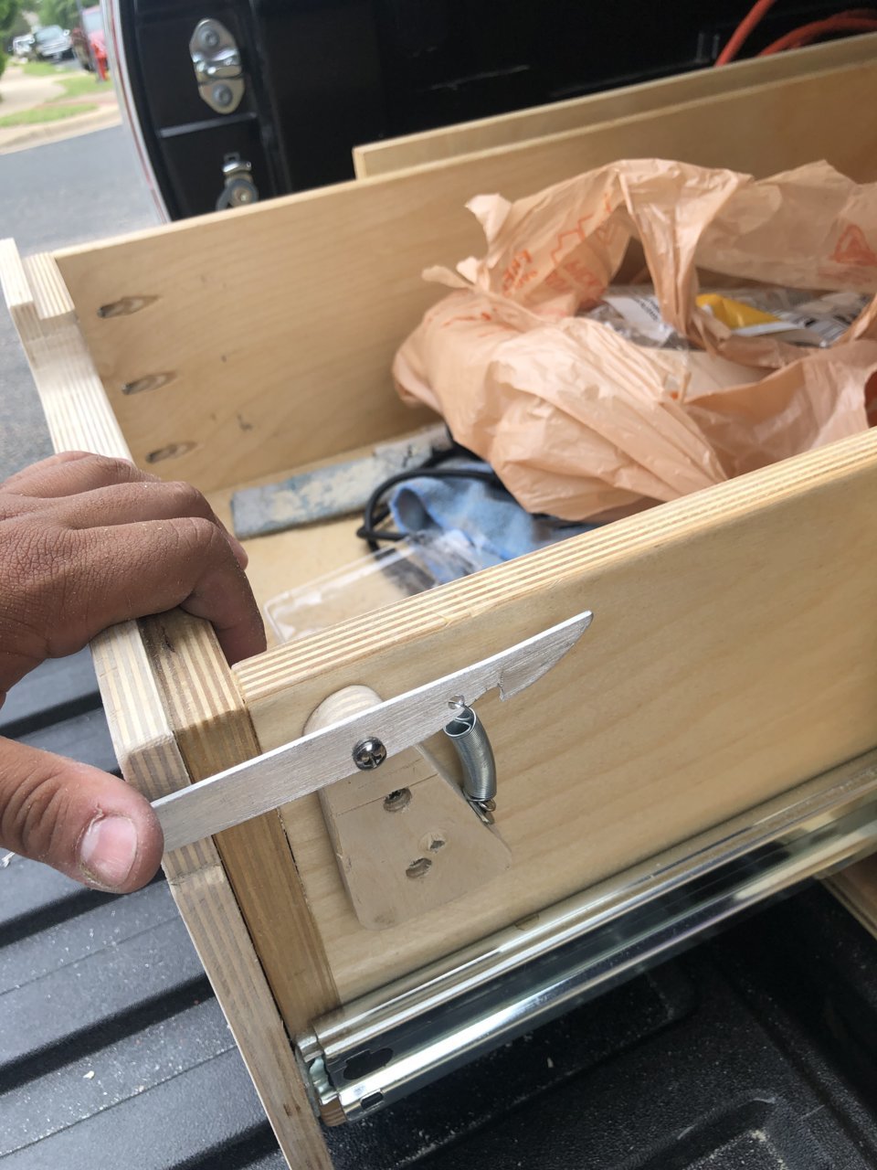

    drawer pull cut out..
    Drawer hardware locks fabricated and installed. Now I can slam lock it and pull out and it will auto lock.
    The bed top has now been officially installed. It is one piece and I had to take everything, including the side rails to put it in.
    I’ve started screwing it to the verticals however I will be taking my time with this to allow everything to settle.
    Pictures....

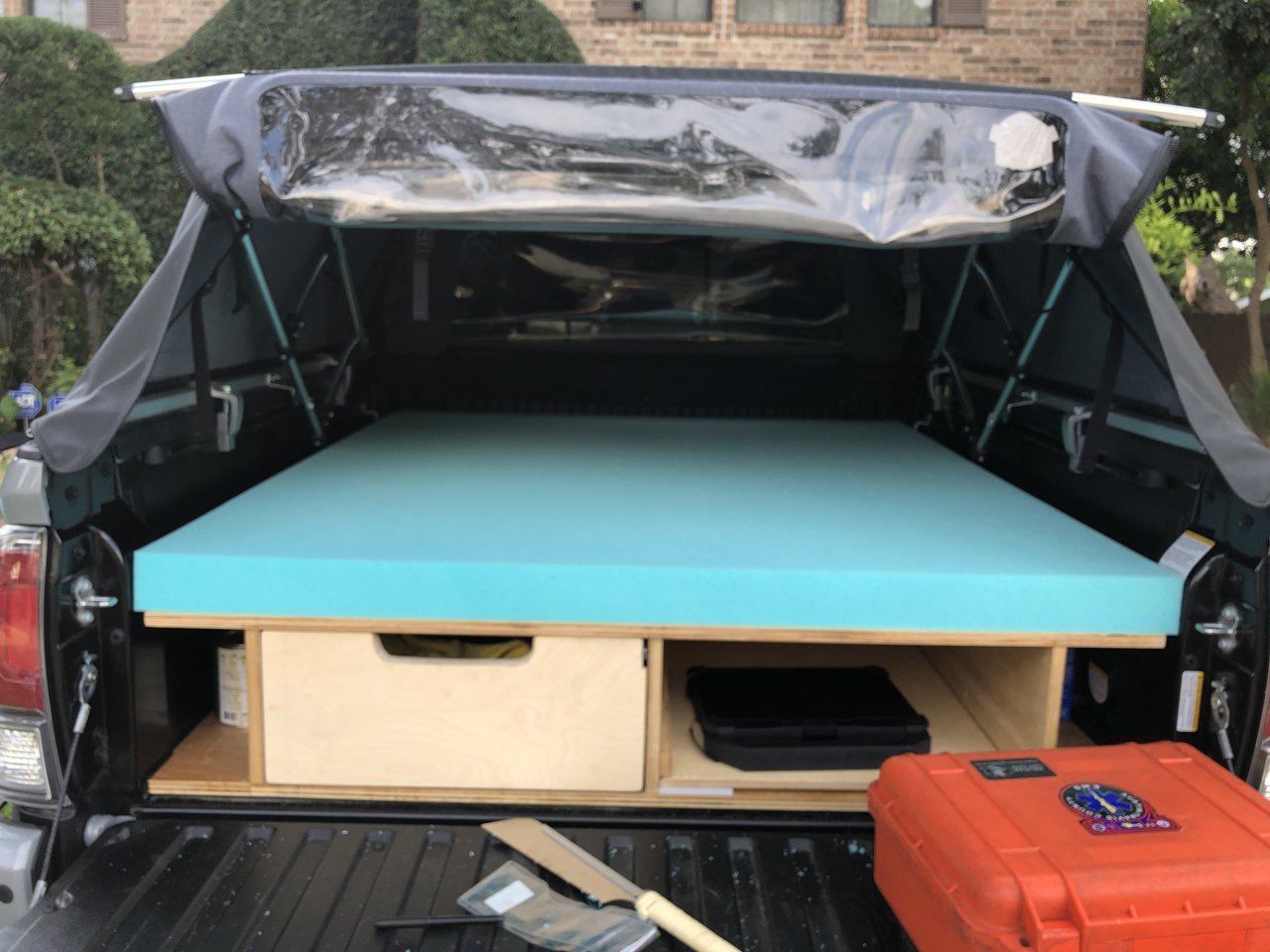

    And the mattress is in!
    Bigdaddy4760 and bulleit95 like this.

    On the right-hand opening, what's the white pieces of material under the bottom of the sliding piece of plywood?
  17. Jul 14, 2020 at 4:46 AM
    #17
    TexasCementTac
    TexasCementTac [OP] Active Member
    Apr 15, 2020
    #324860
    39
    Richard
    2020 Cement TRD OR
    Ultra High Molecular Weight (UHMW) plastic.
    It’s the same self lubricating type plastic used to make table saw sleds glide with ease.
    It’s awesome stuff and the right sled even with around 50-100 pounds of gear on it just slides effortlessly.
