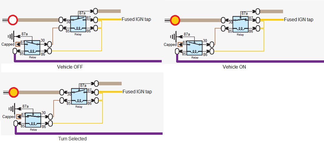

Another DTRL mod for those without.

    4 relays of 5 pins and one Hella H44452001 6 diode "block", wires and terminals.
    Vehicle OFF - Blink with lock and Hazards.
    Vehicle ON - DTRL ON until Left or Right Turn is selected.
    No Hazards Function while vehicle ON...unless an ON-OFF added to Fused IGN tap.
