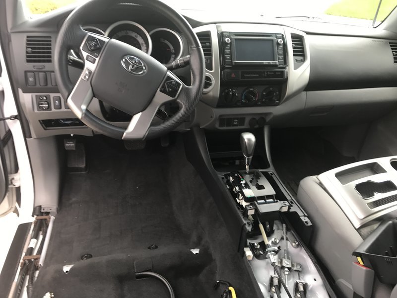

    Step 1!
    Disconnect your battery and follow this thread!
    https://www.tacomaworld.com/threads/center-console-removal-w-pics.57895/

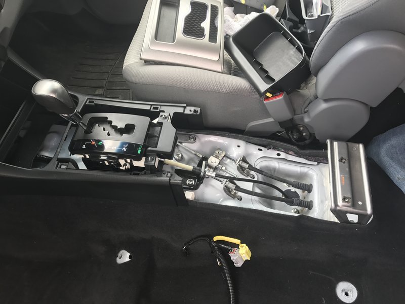

    When you are done with your ten minute removal, it will look like this:
    Drink a beer!

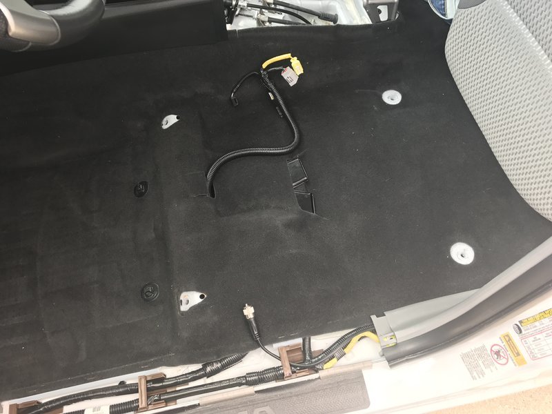

    Step 2!
    Remove your front seat CAREFULLY!
    There are sensors down there that you do NOT want to break!
    Do not plug your battery in until the seat and sensors are put back into place!
    You now have enough room to play around. Optional: Drink a beer!
    Step 3!
    Run your antenna wire below the truck! The antenna wire goes from the center console, under the carpet. Ignore where it is in the picture. There is a grommet (under the carpet, behind the front-left seat bolt hole) that you will need to repair with the gasket maker and re-tape. Pop off the door plastic very carefully and peel the carpet back a little bit. I cut, ran the wire, and repaired the grommet after the antenna was installed.
    The wire was zip-tied to the wire under the frame, and ran up the wheel well, into the bed. This was done for the shortest wire length-distance for no coils. The truck frame is also rigid, which prevents the wire from flexing and stretching. Optional: Drink a beer!

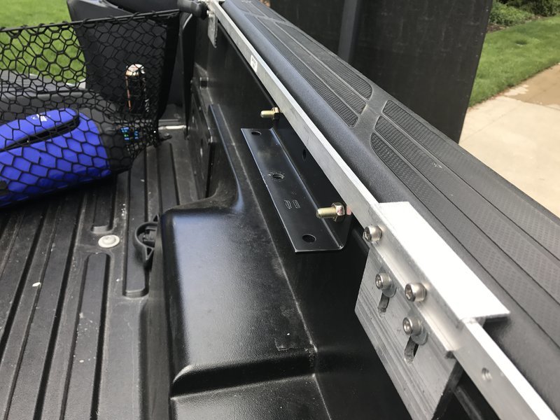

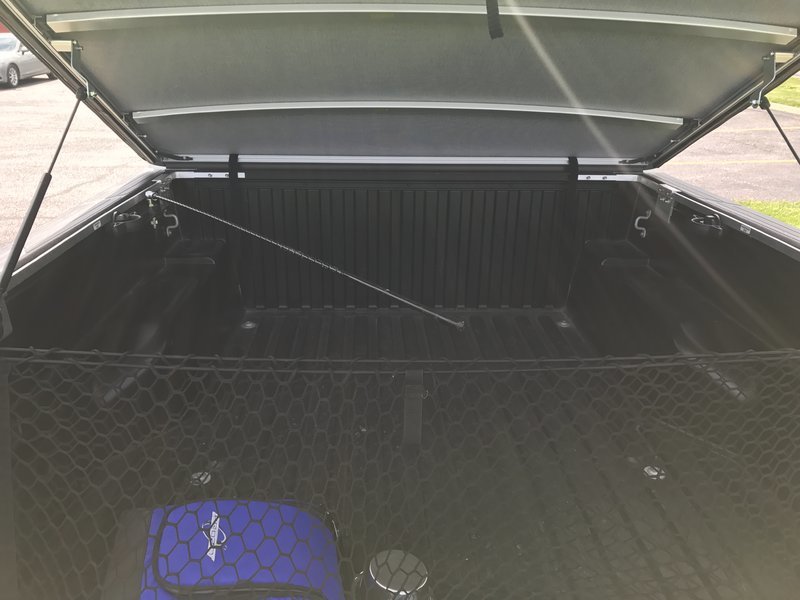

    Place your L-Bracket, washers, and carriage bolts into the bed rails. Carefully tighten, and then install your antenna when ready. I used a folding antenna mount with my antenna to hide it under my tonneau when not in use.
    It looks like this folded:

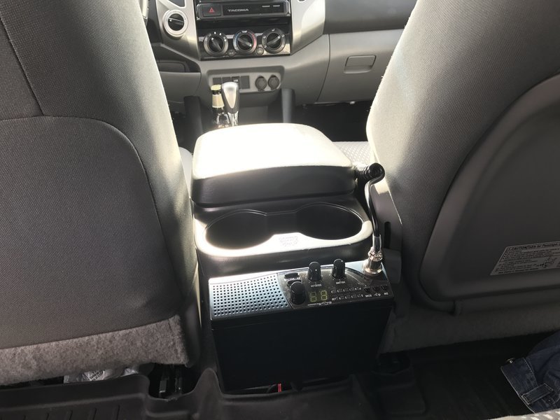

    Re-install your center console, making sure you have enough wire slack to run your radio!

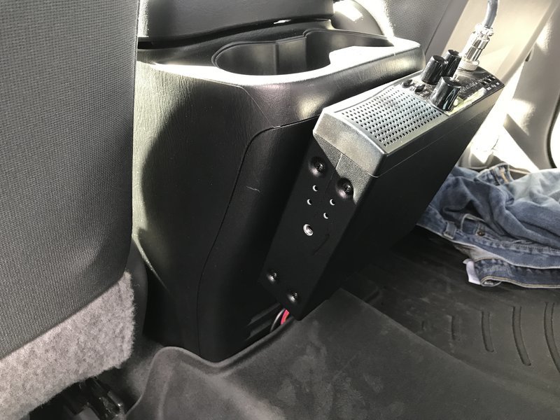

    I used velcro and quick connectors for the power, so my radio can be removed from the truck at any time. Optional: Drink a beer!

    Connect your battery, start your truck's electricity (If you don't have constant power), and test your radio. If you live close to a highway, you will have no trouble. I tested mine using the weather and scan, since that's easiest. Put hard side velcro on the radio, and soft side velcro on the console. Here's your finished product. Drink a beer!
    Now you can talk to the truckers and your off-road convoy!

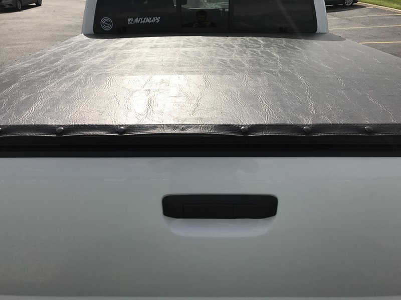

    I do not have to take the cover off to use the radio within a small distance radius. I am currently working on another bracket that will mount to the bed-rail and exit between the tonneau and bedside. I normally run the tonneau over the bed when there's rain on the radar to keep things dry.
    If I like it, I will create a separate post about it.
