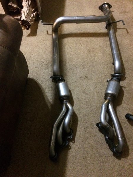

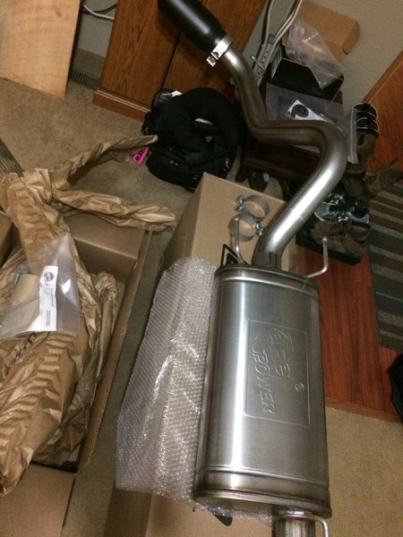

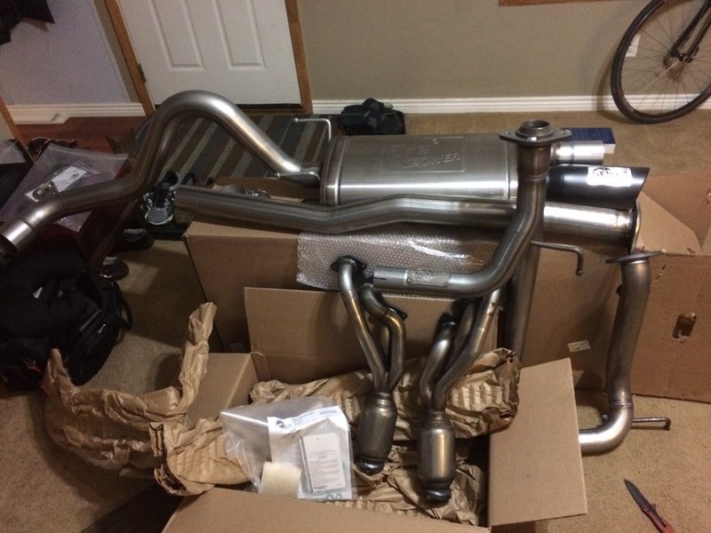

    They finally came in!!! I Felt like a kid at Christmas opening up those boxes!!
    Biscuits, Torspd and Bocsy44[OP] like this.
  6. Apr 22, 2017 at 4:39 PM
    #26
    Tonka08
    Tonka08 Well-Known Member
    Mar 24, 2013
    #100494
    99
    Eugene
    Vail
    08 Tacoma 4x4 offroad DC 6sp manual 5' bed
    TRD Supercharger, aFe Headers & Y-Pipe (48-46001-YC), aFe Magnum Force State II Si Pro Dry S Air Intake, aFe POWER 49-46001-1P MACH Force-Xp 3" 409 Stainless Steel Cat-Back Exhaust System. Firestone 2407 airbags. Toy tech 3.5" Lift w/add a leaf & coil-overs, Helu 17" wheels Modified Skid plate, Bug Deflector, Window Vents, 15% tint, Fold-a-cover (Tonneau) Tub Steps, Adjustable Bed Divider, Weather Techs, Custom Seat Covers, Auto Dimming Mirror & Locking Tailgate. KTV512 Stereo W/Nav Sirius & BT, Kenwood Speakers & JL Audio Stealbox Dual 10" Subs, Powered by KAC7205 Amp.
    Exhaust
    Biscuits and Pirhett like this.

    Y-pipe & headers.

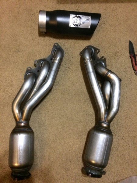

    Headers & exhaust tip

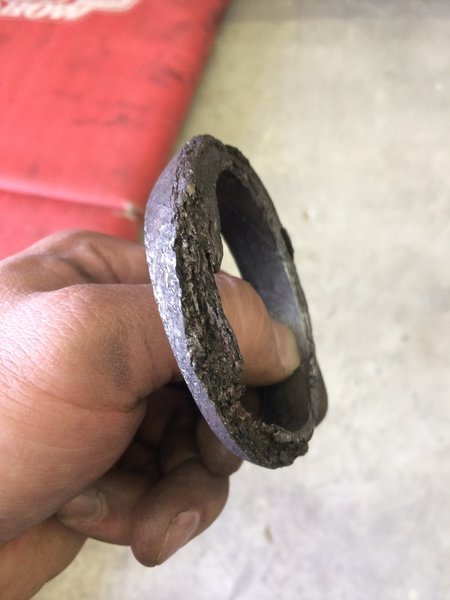

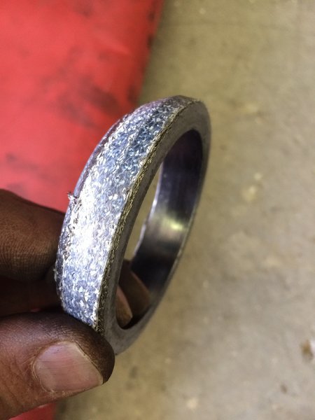

    UPDATE:
    This isn't a build thread but there are some important things to be noted that I ran into while completing the install. Also sharing some pix, before and after videos of sound so those of you who were in my shoes know what you are getting before you decide to upgrade since this isn't cheap.
    To start off why the upgrade? I personally wanted more low end and mid range torque since I tow (my toys RZR & atv's) a decent amount and I live deep in the Rocky Mountains. I have 7% grades to climb constantly so any added HP increase also helps. The throaty sound is just an added bonus.
    I decided to do the install with an experienced mechanic buddy of mine because most if not all shops I spoke with quoted a 2 day install (8 hours each day) so it would have cost me nearly $2k which is almost the cost of just the parts...No way in Hell!!! Also most other shops straight up declined to do the work as they don't want to warranty it due to their experience of continual leaks with headers and they'd want the headache. Well after hearing that I wouldn't want them to install it if they aren't confident in their skills!
    We had to make a few alterations in order for a solid install even though this set up is made specifically for my taco. Although aFe claims that you have every part you need for install, you don't!! I would recommend if you are going to do the same set up you take these considerations into your install. This isn't a knock on aFe as I love their products. Maybe aFe feels that some parts can just be reused to save $ IDK.
    Things to consider when installing is how old your tacoma is at time of upgrade? Mine is 08 with 95k miles so I opted for all new hardware, gaskets, seals etc... to be on safe side to prevent any leaks. If I would've done it years ago maybe I could've reused all original hardware like aFe suggested.
    Things to note:
    1) You'll need new header gaskets! If you are spending this kind of $ then spend a few more bucks for new gaskets.
    2) You'll need new donut ring/seal where y-pipe and muffler extension meet (see pic of old one deteriorating)
