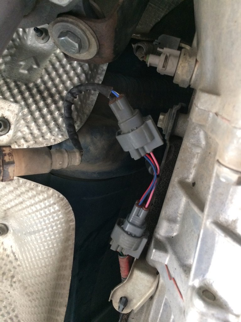

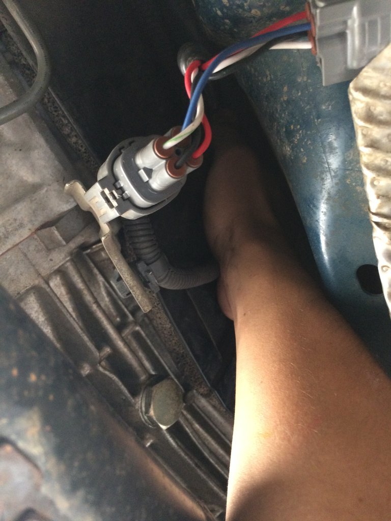

    Ok now I'm at a loss! I was hoping the O2 Simulator from URD would solve the check engine light. I hooked them up see pix, very easy install. However check engine light still on. I used my OBDII and tried to erase code and not even 30 sec later check engine light back on. Disconnected negative terminal for 15 mins pressed horn for min and then few mins later reconnected negative terminal and still check engine light. Im pissed bc Im out of ideas and aFe guy who has a tacoma said buy the 02 simulator. Other aFe techs said you shouldn't need it but couldn't hurt.

    Passenger side

    Driver side & I touched the module

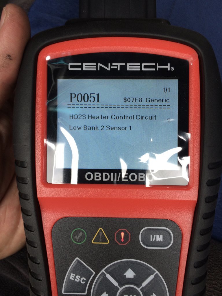

    New code after hooking up O2 simulator

    Seems like you have a sensor malfunction, this one is associated to the first O2 sensor in bank 2, before the cats (see the attached TSB). Was this code there before? I would suspect that O2 sensor is defective. You may want to try to unplug that module and run again to see if it makes that code to disappear.
    Troubleshooting time I guess

    I think its odd that the "P0051 HO2S Heater Control Circuit Low Bank 2 Sensor 1" code tripped only after in connected the O2 simulator from URD.
    The 2 codes that came up prior to this (and reason for me buying O2 Simulator) were "PO420 Catalyst System Efficiency Below Threshold Bank 1 & 2".

    The real question is: is it the Rear O2 Simulator kit being at fault, or the O2 sensor has gone bad?
    I am definitely curious to know the result.

    Just asking, did you reused your old sensors or you installed new sensors? And also note that the pre-cats sensors are not the same as the post-cats.

    This may seem as a jab, but it is not. Did you install the sim correctly? It has a specific orientation, or it won't work.

    I don't see how the rear 02 simulator could be at fault but its too coincidental that once installed code P0051 popped up seconds later and the previous 2 codes P0420 are gone.
    My understanding is PO420 code is no longer showing up because of 2 reasons
    1) The P0051 is A/F sensor (prior to cats) trumps P0420 since more sever (according to several mechanics)
    2) O2 Simulator is connected (less likely as I've now disconnected it and no longer appearing)
    I'm thinking the sensor prior to cats on driver side is bad (Bank 2 sensor 1). At Toyota for another issue (unrelated... CV boot that they replaced that re-tore in less than 500 miles after install) They quoted the that driver side front sensor part is $220 and another minimum $120 for labor. Found online for $145. URD also tech I talked to said its $163. So I am just going to buy it and install myself.
    at https://www.toyotapartsdeal.com/oem...&Filter=(1=1GRFE;6=6F;7=DCB;0=GRN245L-PRFDKA)
    I more then likely will buy both driver & passenger side A/F sensors (prior to cats) since I bet other will go bad after installing the faulty one. They usually go same time. I may try and clean old ones but with 97500 miles it may not be worth hassle. I'll hold off on rears as hoping the O2 Simulator should do its job.
    Yes I reused old sensors and yes I also disconnected the harness prior to taking O2 sensor so the harness wouldn't twist causing it to fail. But yet somehow (even though was very gentle & careful it some how failed???) I just don't get how these problems didn't arise until 2 weeks after. If I damaged it during install wouldn't the check engine light and that code come on right away? & why after installing O2 simulator would all of sudden Bank 2 Sensor 1 go bad? Just odd and infuriating!!! Keep dumping $$$

    Also the O2 simulator only works on rear O2 Sensors. Different harness connections for front A/F sensors. I knew that but tried to install the O2 simulator on fronts after the P0051 code thinking worth a shot to try. Won't work and after that called URD to confirm.

    Not to worry I didn't take it as a personal jab. We all can make mistakes so worth double checking, so thanks. But to answer your question, yes I made sure it was installed correctly. See pix and description please.
    On top of that the P0051 is for front sensors (Air Fuel Ratio) not rear (just O2 sensor) where the O2 Simulator connects.

    Yes I replaced the front O2 Sensor and then that P0051 Low Bank 2 Sensor 1 code went away. However the original code P0420 came back less than hour later after replacing from O2 Sensor. So I hooked up the URD O2 Simulator to the back sensors and no more codes. Its been a few months and still no codes so I am optimistic that all is good. Thanks for everyones patience.
