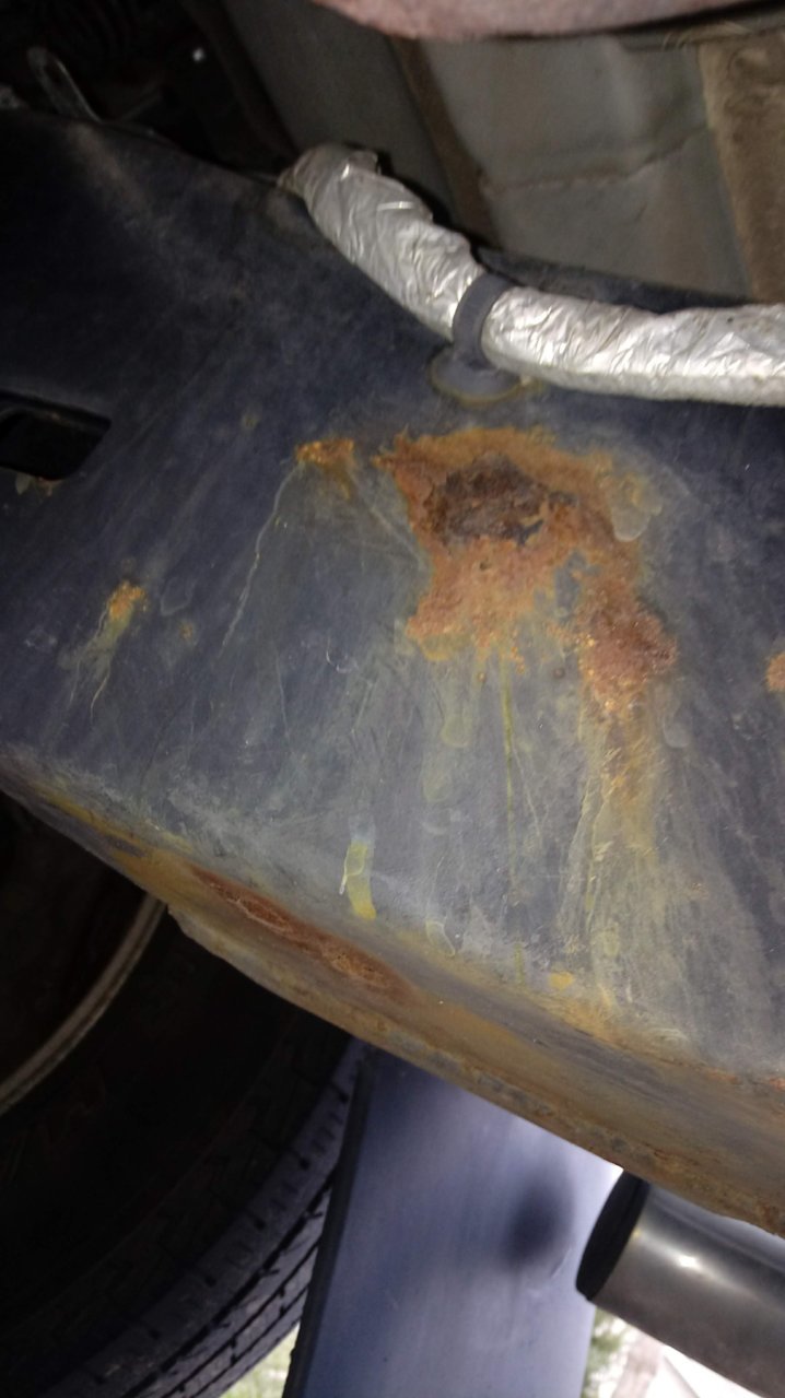

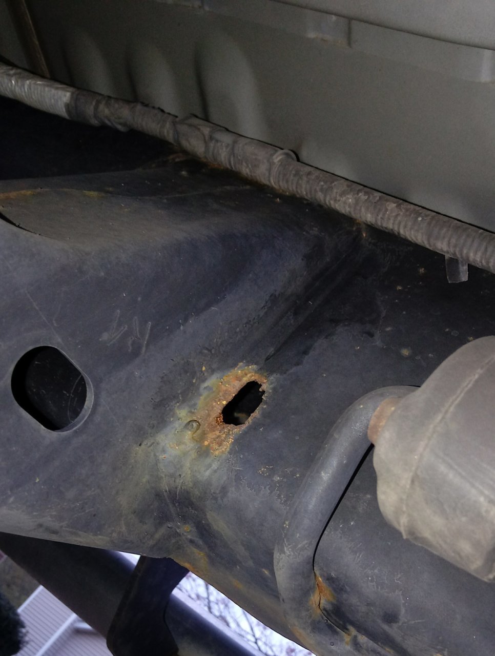

    So, to be clear here, you say you were tapping on the frame to remove scaling...
    What the hammer is most useful for is to listen for a change in the sound. Since the frames rust from the inside-out, if you tap on it and get a nice metallic ping, you're probably fine, but if it starts to sound more like a thud, you've got some serious work ahead of you...
  11. Apr 15, 2019 at 4:09 PM
    Blue92
    Blue92 Well-Known Member
    Aug 26, 2017
    #228071
    4,822
    Daniel
    North Carolina
    2004 4x4 2.7L. 1992 Pickup 22RE. 2008 DCSB 4.0L
    This right here. I was taping on my dads 08, even the worst looking rust spots still had a ping type sound. Then my hammer went right through with minimal effort at this tiny rust spot. Goes in for inspection this week. 0411191942.jpg
