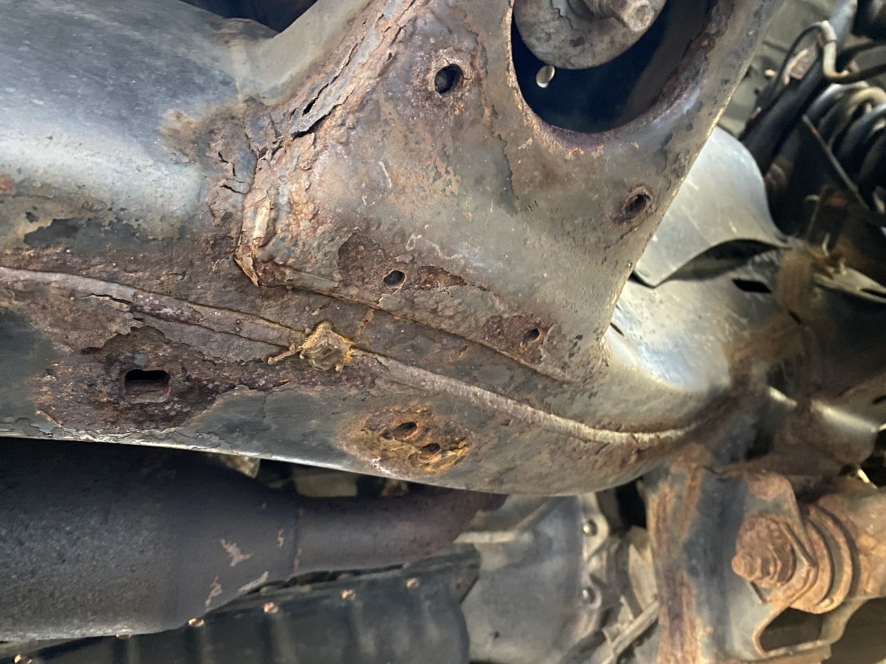

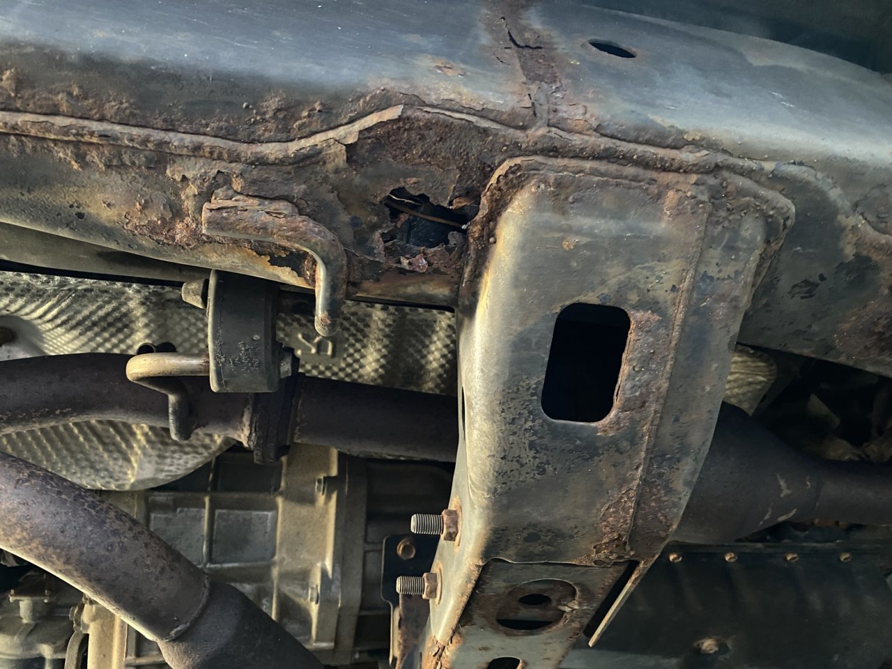

    Had my 2nd gen 2010 frame inspected last year before the deadline as well as the rear spring TSB done. They did the frame inspection supposedly (I specifically asked for it) and said it was fine, I suspect it was actually bad, they did not offer coating. I was working on it last weekend and while underneath I saw some rust flaking off, I poked at it with my finger and then it fell off and I was able to push my finger all the way through. How does a frame go from fine to crap in one year. Do I have any recourse?
    Because I had it inspected is it still und warranty? Im about to head overseas for minimum 3 year assignment and wanted to take the truck with me but I’m worried now because I won’t be able to do anything about if it fails and will certainly only get worse.

  10. Nov 3, 2022 at 10:47 AM
    intheblue25
    intheblue25 [OP] Well-Known Member
    Sep 12, 2017
    #229780
    107
    2010 DCSB TRD Off Road
    here ya go! This is just a couple but it’s bad especially up by the motor. I suspect they didn’t really do much of an inspection.

    Spoke to an attorney friend who said make another appointment for an inspection and then appeal to them to do the right thing because they obviously didn’t the first time.
