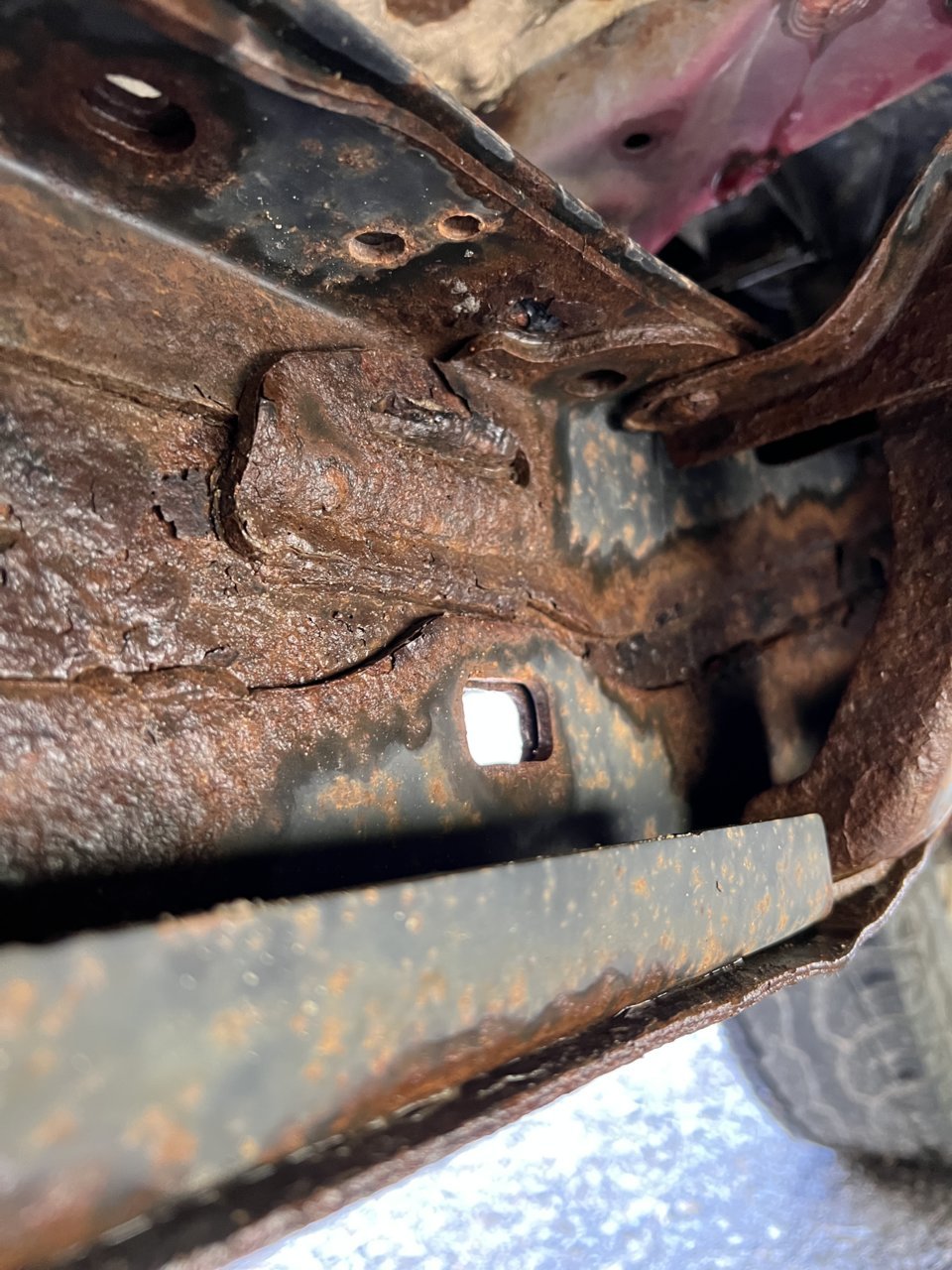

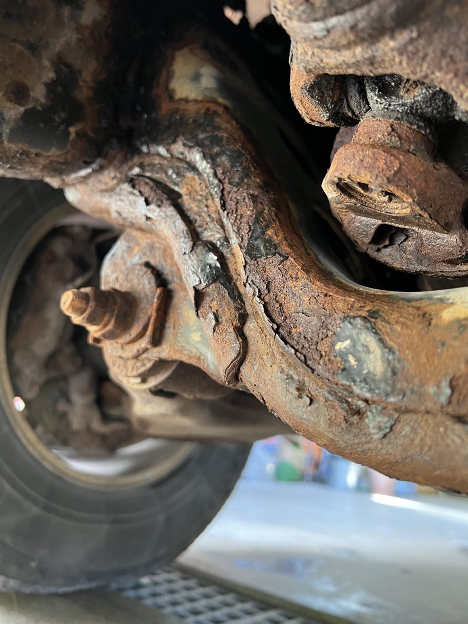

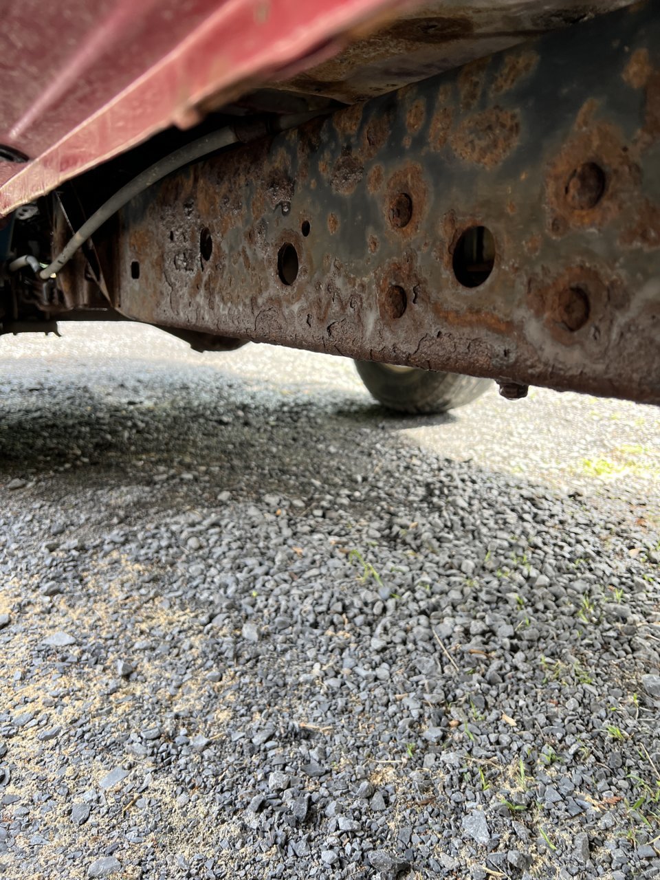

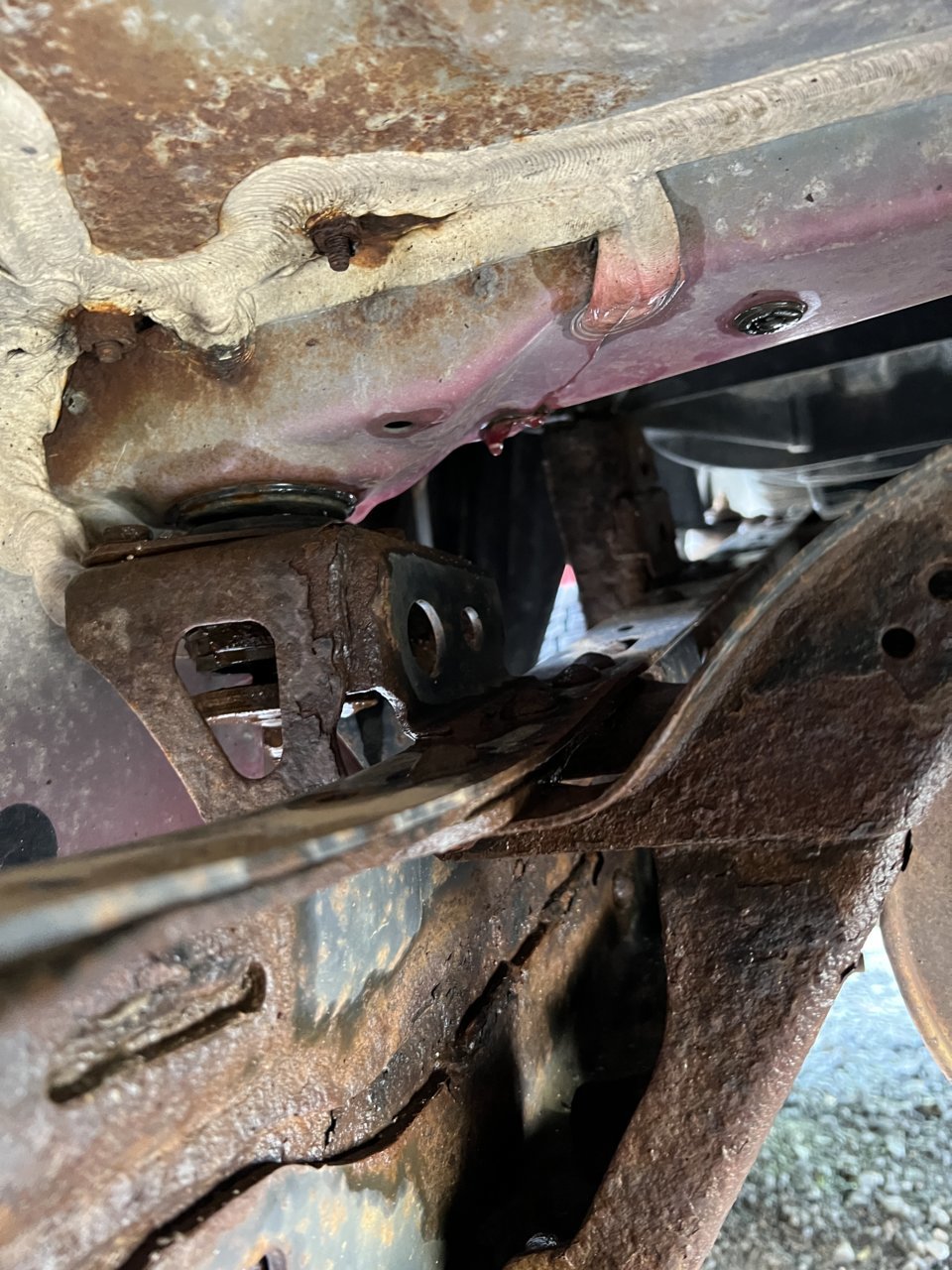

    Hey guys I’ve got this 2010 Tacoma with 180k miles on it or 290km from salty Ontario Canada. Everything about the truck is great no engine issues etc the only thing I’m worried about is the frame given the recall and all. I called the dealership for the free inspection, they said they’d get back to me on Monday but from what I’ve heard and read on here and other places they aren’t too keen on doing the job and try to get out of it ( this was the feeling I got from the dealership almost like he wasn’t aware of the issue). I’ll attach a few photos I’m sure you guys know better than I do and a second opinion would be great before the dealer. Thanks
    If you need to see other angles just let me know ✌️3764D553-79CA-4EEC-B02A-9EAC9DF5511B.jpgBB4D4EF9-A4CF-4063-8F96-484B6915C192.jpg 9D1E5873-9F8D-46E5-AF2C-6D89E423DD4D.jpg BB4D4EF9-A4CF-4063-8F96-484B6915C192.jpgF877B1DB-9C52-44CD-8D1A-47A05792B816.jpg

    You have an advanced rusting issue going on. Your at the point you need to seriously start thinking about the future with this truck. It will become a liability and safety issue, it will continue to rust away. The frame looks like it was never treated or maintained.

    Typical for a 12 year old truck that nobody cared enough to oil spray underneath to protect for the salty winter roads. Hope you did not pay too much for it.

    Thanks for the feed back guys, since taking the photos I’ve take a hammer/ metal paint scraper to most of the frame and luckily it seems hard all the way though bouncing my hammer back, some small rust flakes but bad surface rust over most of it. Just wanted to add that extra info invade it helps paint a picture.
