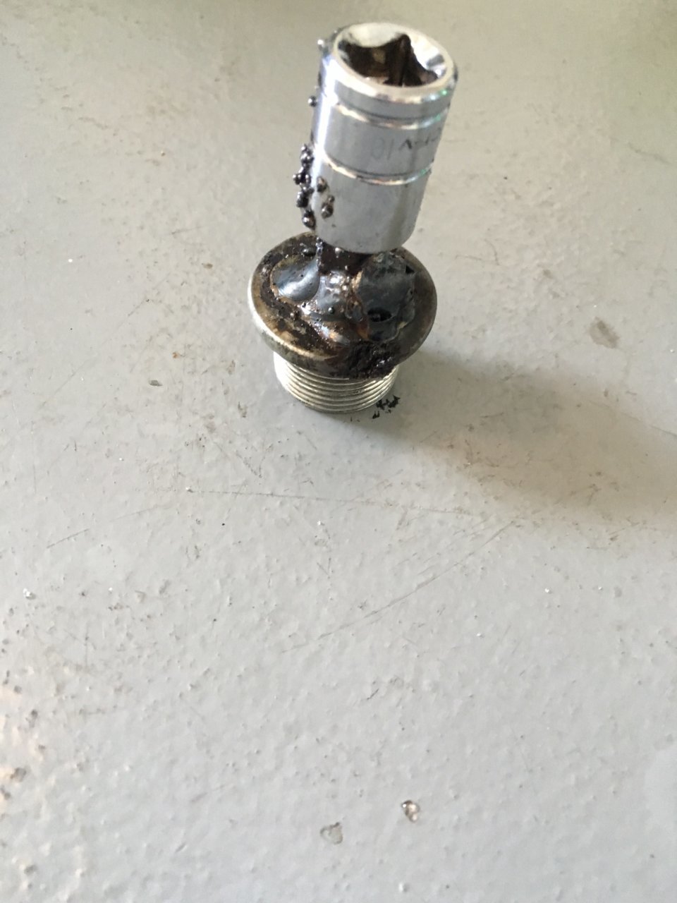

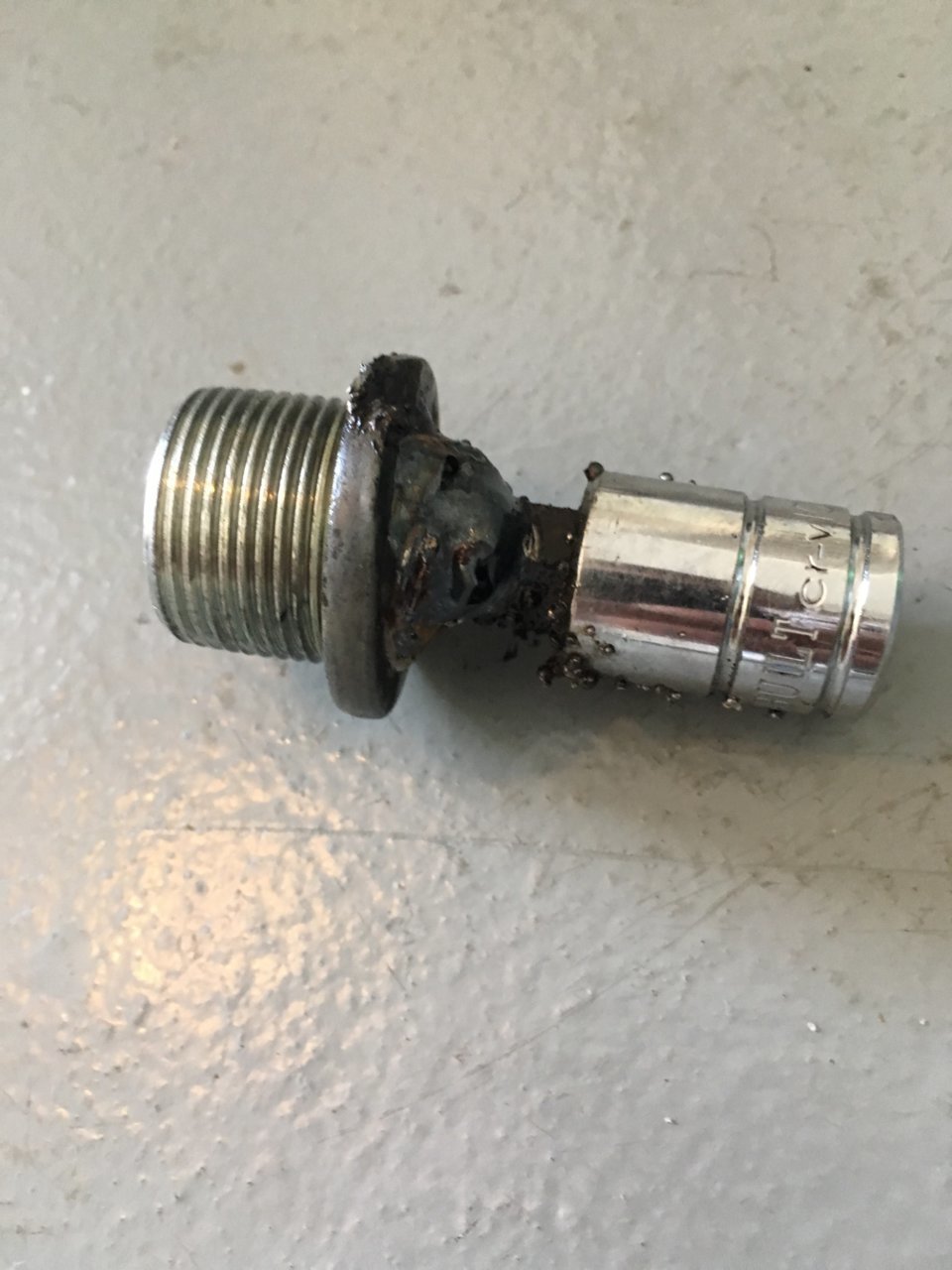

    Had a guy weld a old 10mm hex socket on it for me this morning, and when I got home it came off super easy( guess it was the heat from welding), but anyhow I replaced it with a new OEM drain plug, but next time I think I'm going to get one of these https://goldplug.com/shop/ap24/ like mentioned in above post..

    Shoot, you may as well just re-use that! Good idea to weld old hex socket in there.
