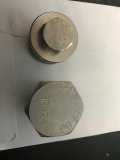

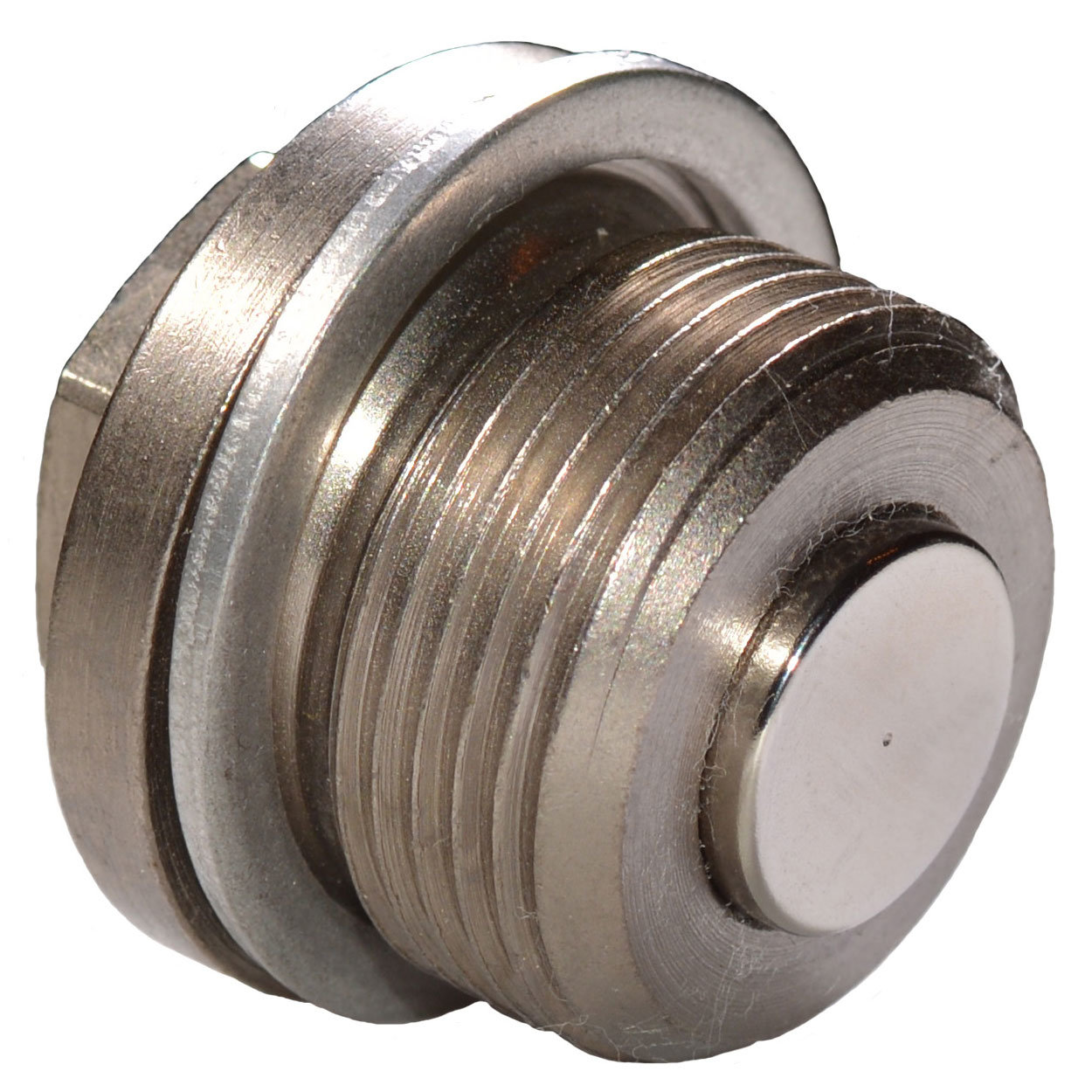

    i made the same mistake ordering the gold plug, i then ordered the dimple
    M24x1.5x14 Magnetic Drain Plug for Toyota
    the hex head is much smaller so you can get a normal socket on it...
    Nothing wrong with gold plugs and i use them in everything else (oil pan, transfer case, rear diff..) Just not appropriate for the tacoma front diff.

    Here is a top photo to show the actual difference..

    Cool. I may get one although my Snap-On 10mm hex socket seems to get my factory plug out no prob.
    Is there anything that the Gold Plug is good for? I got one before I realized it wouldn’t work for the front diff since there’s no clearance to get a socket on it. Will it fit rear diff or xfer case?

    might fit something but not on the tacoma, diff and xfer case are smaller 18mm. I dont have one but maybe the manual transmission??
