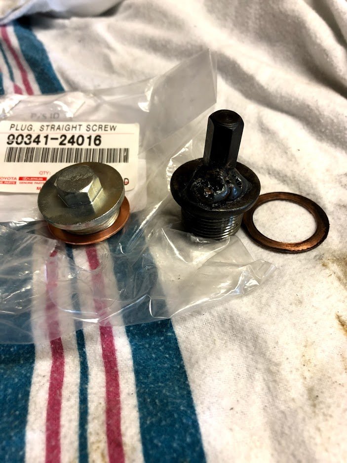

    New Allen socket, cleaned out the old plug real good, hammered it in etc..... still stripped. BTW, Penetrating oil wont help. its a plug. No fluid leaks out, so no fluid gets in! The threads are covered in oil, I see no benefit in trying to use penetrating oil on it. YMMV :D
    no nut here, but I did have a spare 10mm Allen, so I welded that in and used a 10mm socket to remove.
    I think the heat from welding did more then anything else. came out soo easy after the Allen was welded in and things were roasty toasty.
    ACtC-3eGozWoJGdfxehyPLLDR6wrqIQz86tVIeoM_6337ddd59f3570ed8a4d5393a2b603b5ee58b7f4.jpg
    I still have that drain plug kicking around in case anyone in my area does the old chisel trick on a Sunday. I debated on keeping it like that, but went for the Lexus plug instead.

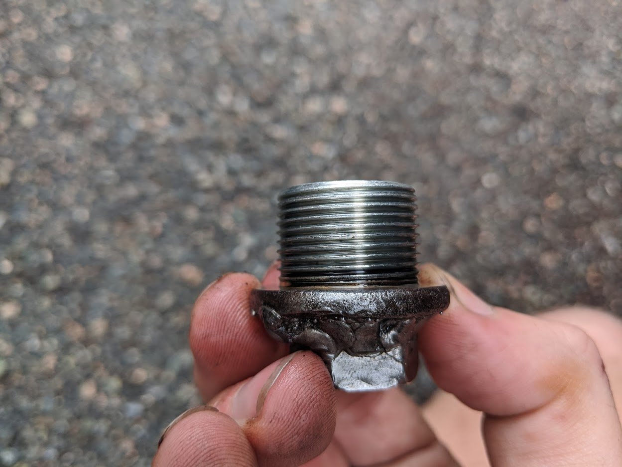

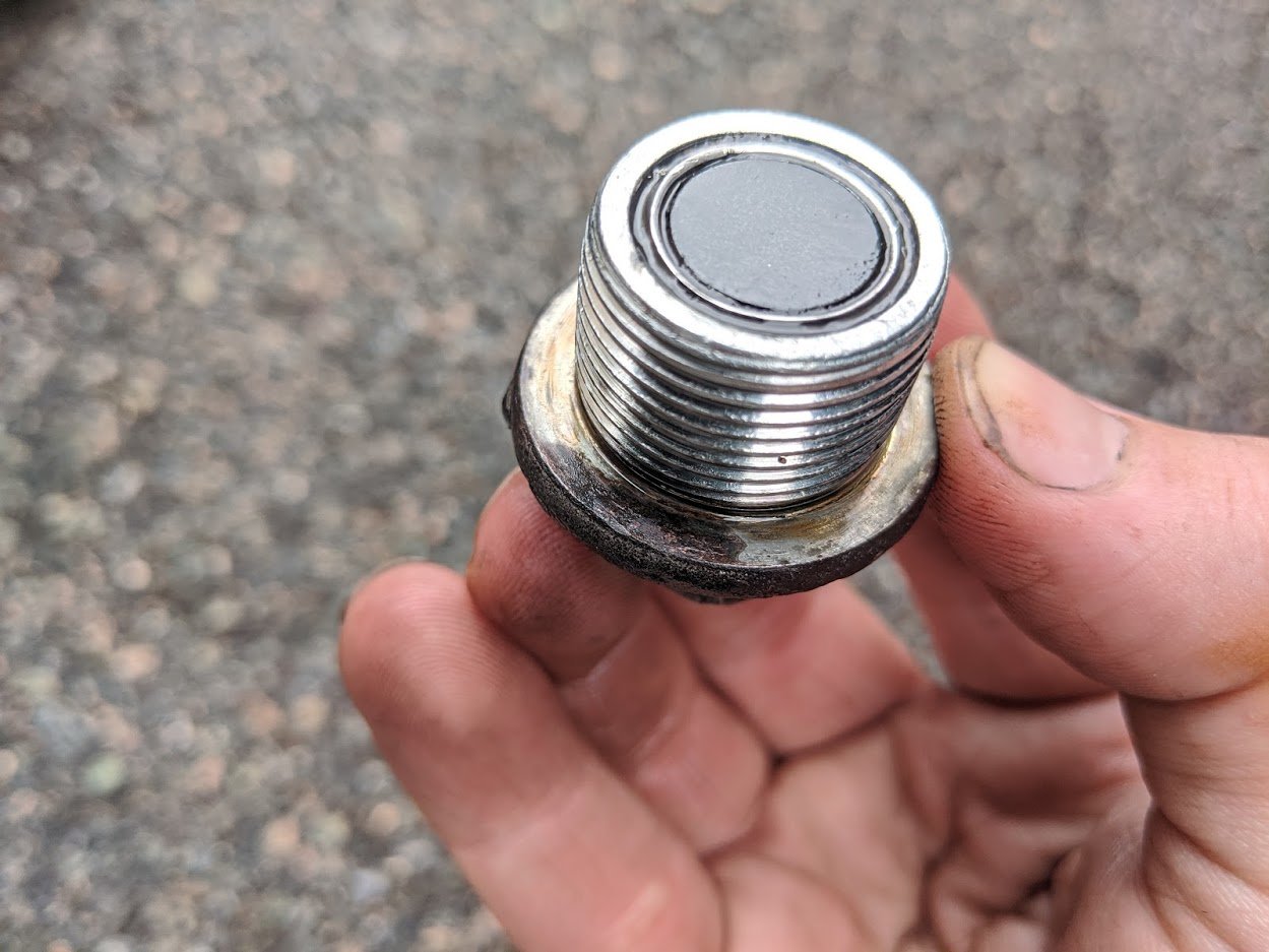

    2005 4runner, but same deal. welded a nut on there and the heat really helped it to loosen up.

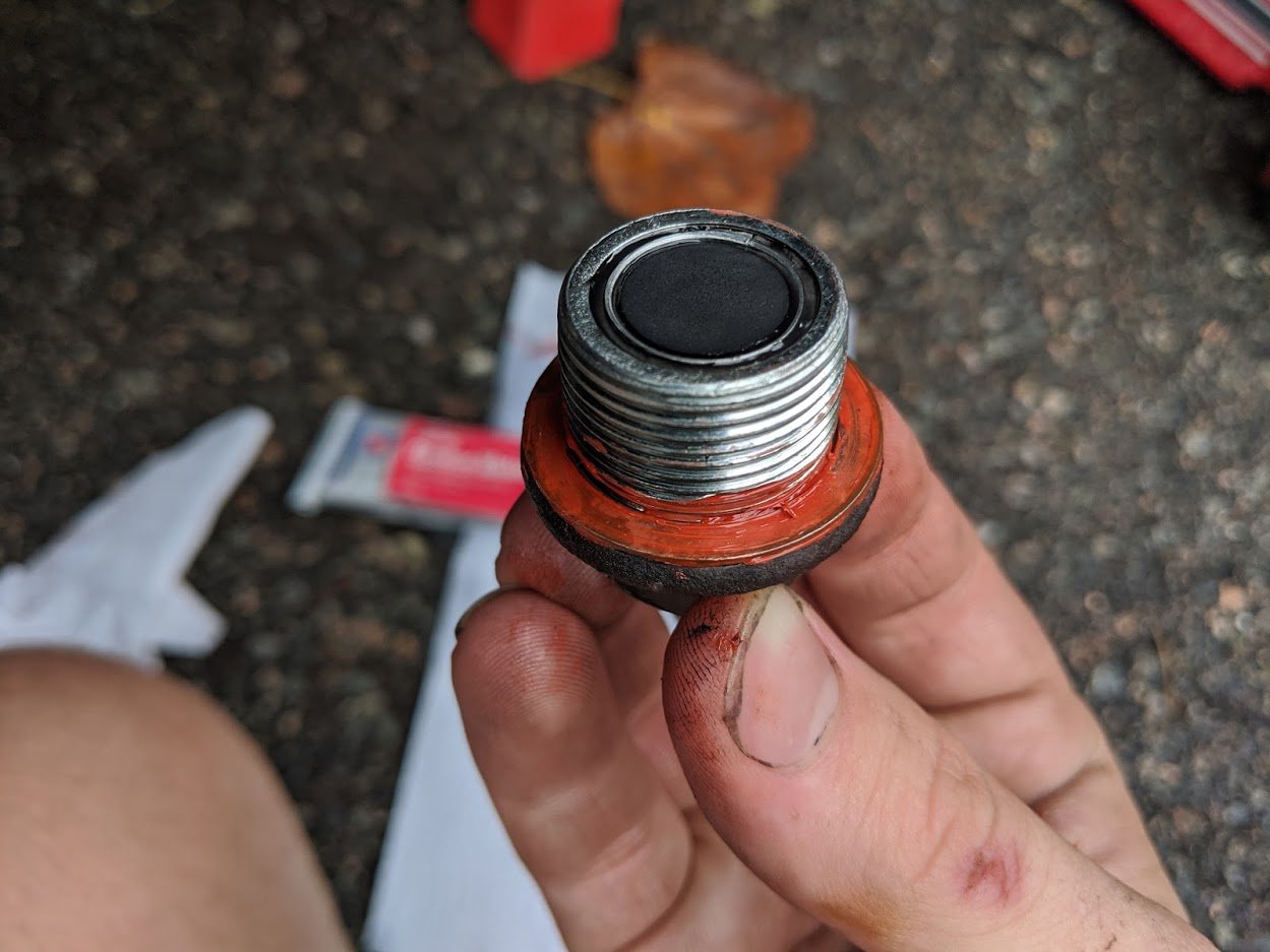

    I did warp the flange on the plug with the heat since I welded on the outside of the nut. Was leaking very slowly, noticed the side of the diff was wet again after cleaning with brake clean. Ended up RTVing the crush was lol and its been mint since with no leaks
