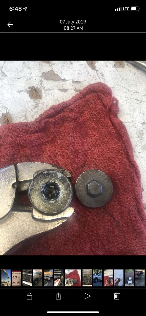

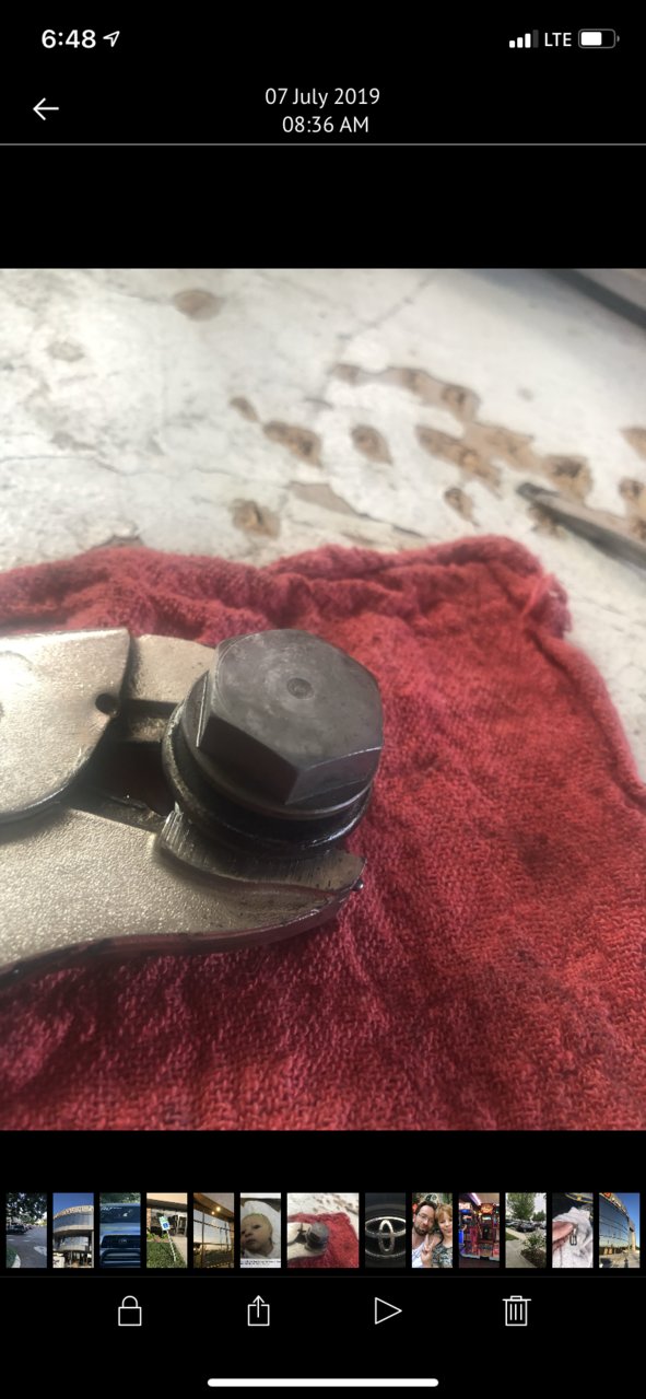

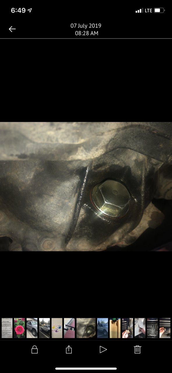

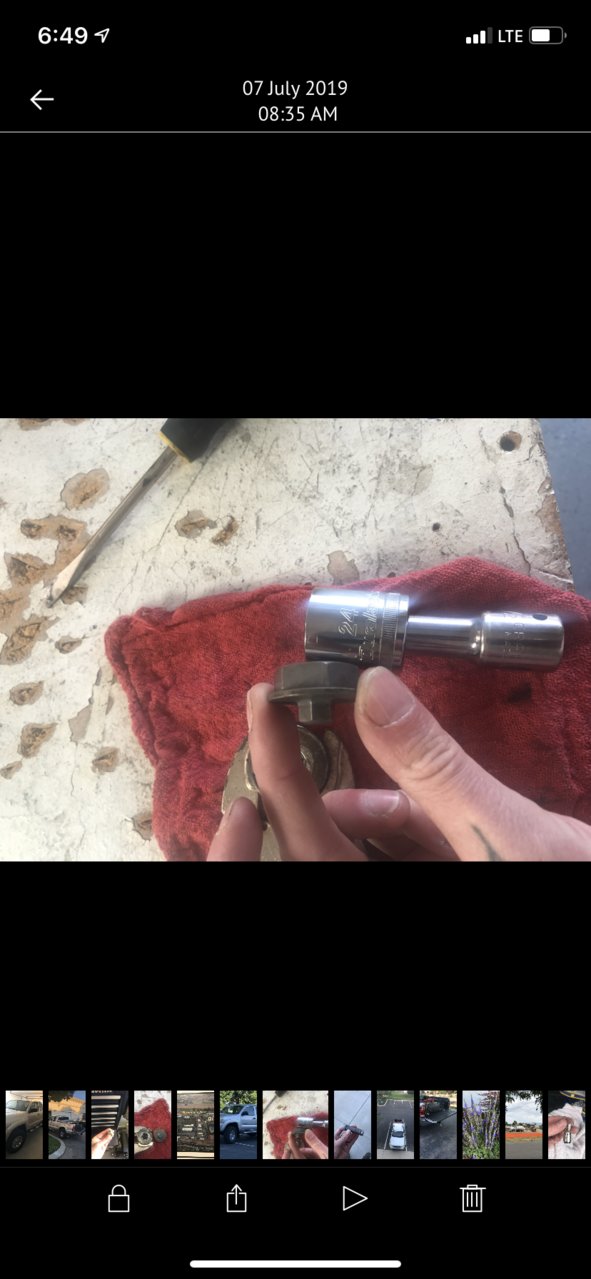

    Found a couple pics of the stripped plug I got out with it. Like I said it was a little pricey for it and it shipped from Australia so it took a bit. Not sure how long it would take now I got mine before all the coronavirus shit happened. Also ordered the new drain plug from them. I got the one from Lexus with the 14mm head but I liked the 24 better. You hammer it in to the stripped plug it’s machined larger so it cuts in and grips extremely well. Used it for mine and also a friend. So far it’s two for two.BC12B8CD-3415-4D25-A507-D55B332966F5.jpgD1CCFC06-2EE7-4C8D-87CD-FA5F7270AABD.jpgD1138C93-18D0-40AA-83D5-FB2165F1D9B9.jpg

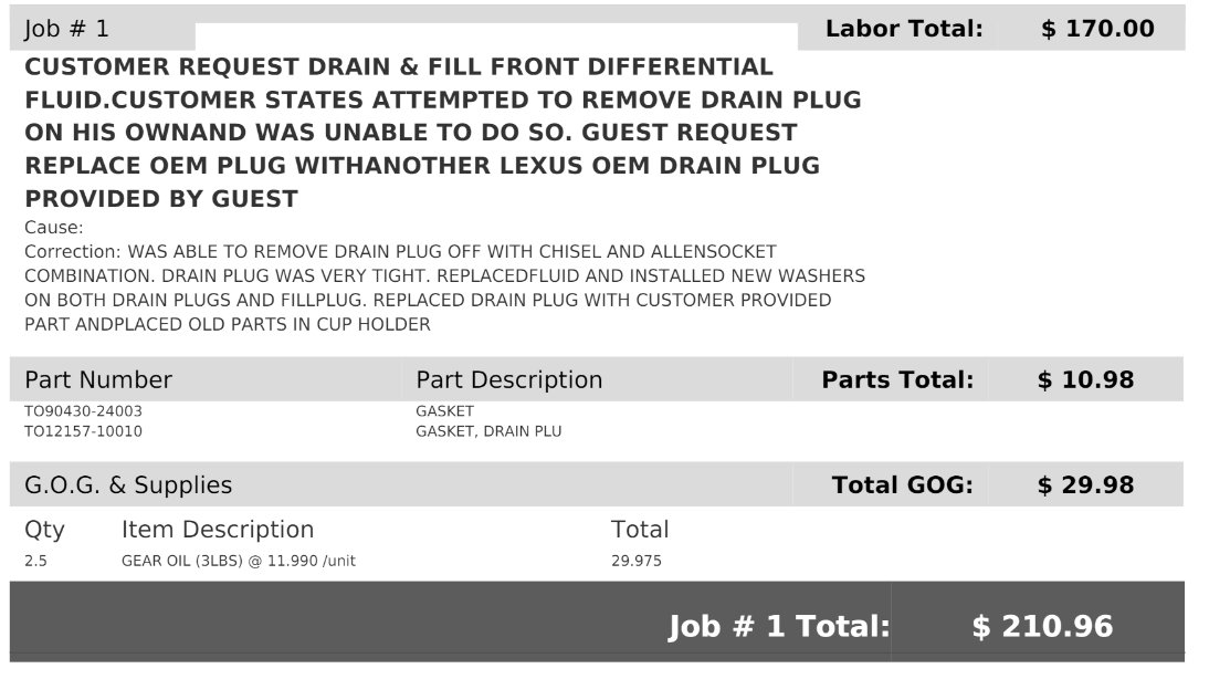

    For anyone else wondering about a bailout option, I went through various attempts on my own with this drain plug in my driveway and did some damage to the allen socket but not all the way trashed. I even bought the aussie tool to convert to hex just to try and be sure of my failure, again no dice despite some (perhaps overly tentative) swings with a hammer. I knew I was risking making a big mess of things due to my lack of familiarity with the various techniques and lack of experience here and didn't want an expensive learning experience.
    Ended up just taking it to the dealer for them to help me out, got routed to an experienced mechanic, all done, no trouble, $211 which is high for pure fluids but they swapped in my new hex head bolt so I should be good to go from here out.
    In the grand scheme of things, while it is a bit of a hefty price, I felt this was one good use of a more experienced set of hands.
