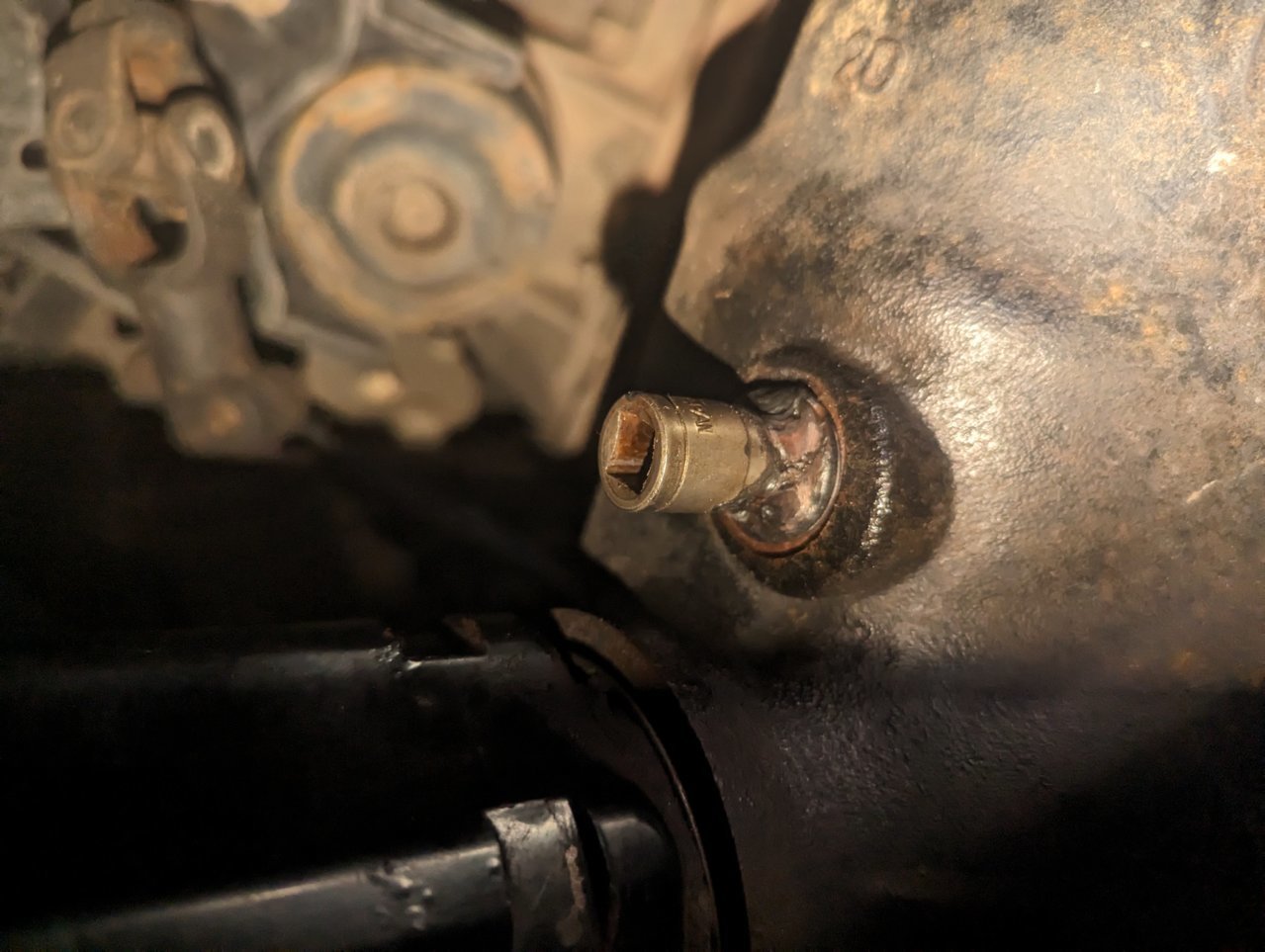

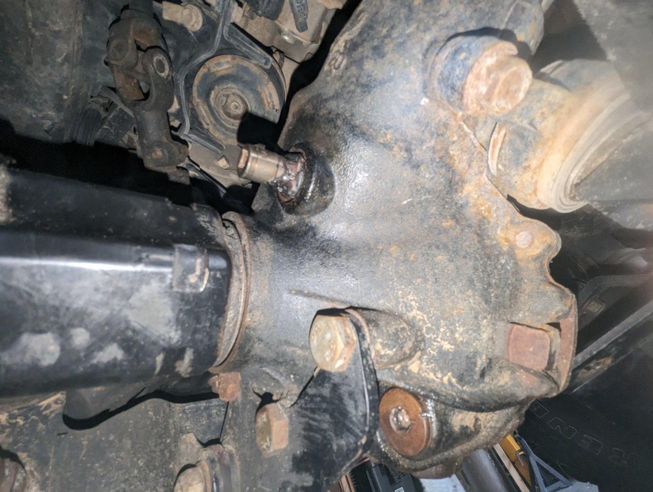

    Hit it with a hammer a few times before attempting to remove. Learned this working on bulldozer final drives. The shock helps break loose anything that is holding it. If it wont move after a few rounds of hits, then get out the torch or penetrating oil.

    I always clean out the recess for the Allen wrench first. Haven't had an issue yet.
    But, now that I have a cordless impact driver, I don't think it'll take so long next time. The bigger 20v DeWalt is a beast!

    Clean out the bolt head first.
    I bought a 10mm 1/2” drive Allen specifically for the front diff. Clean it out, tap it in, 1/2” drive breaker bar.
    Easy peasy, and because you have so much direct leverage you can push in and turn much easier, leading to less slip.

    A couple of days before a fluid change attempt, spray all of the the fittings/plugs with PB Blaster or Breakaway and then give them a few taps with a light hammer. Do the same on game day and then fit up the socket to the plug and tap the socket itself with the hammer. For the front diff wire brush the hex plug and gently tap the socket in until there is no slop. Mine all came right out without the torch. If you know you're going to do it soon, start the ritual a week ahead of time.
