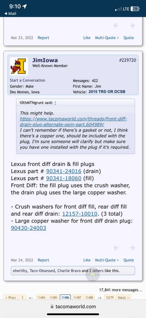

    I think they do,i checked my order and looks the same.
