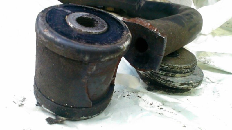

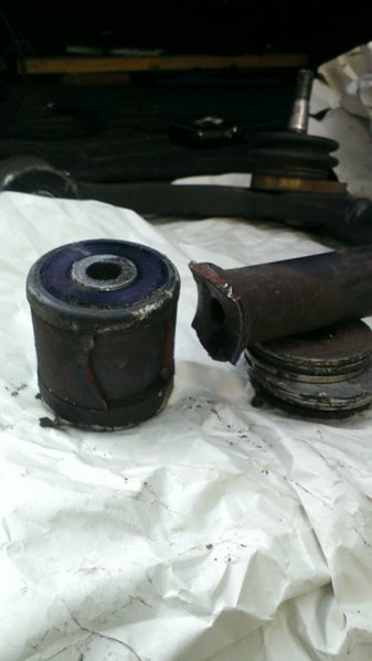

    Here are a couple pictures my dad sent me of my broken LR UCA. I shipped my old factory UCAs to my folks and had the shop put them back on the truck.
    So pissed that two different shops, including the local Toyota dealer, were asked to check out the front suspension in search of the clunk source. Both shops said that everything looked good. Granted I didn't notice the broken arm either, but that's not my day job (at least that's my excuse).
    When I get the truck back this weekend, I'll check to see if the broken arm was the source of the clunk, or if my hometown mechanic just saved my ass from a huge on road failure/accident.
    I'll probably take some better pictures and reach out to Light Racing and see if they have anything to say.
    I haven't put these arms through near the torture some guys on TW do. My rig spends 80% on its time on pavement, the other 20% is on forest service roads and old beat up logging roads.

    Not sure if this is an issue on tacomas (only real noise I've ever had on my front end is from me forgetting the top bushings on the coilover assembly), but on other vehicles you can get a clunk going over bumps if the LCA mount bolts are torqued up fully with the wheels off the ground.
    This shouldn't be an issue after a shop alignment, though since they torque everything with the wheels carrying weight. If you do a DIY alignment without a rack you might be doing all the adjustment at droop in which case just get it back on the ground before fully torquing down the LCA cam bolts.

    wow man that's insane. i bent a pair of Light Racing UCA's and they were great with warranty. sent me a brand new pair. hopefully they do the same with you. i ended up selling them and buying some desert racing ones off of downsouth motorsports. i believe they have another boxed uca that took the desert racing one's place. good luck!
