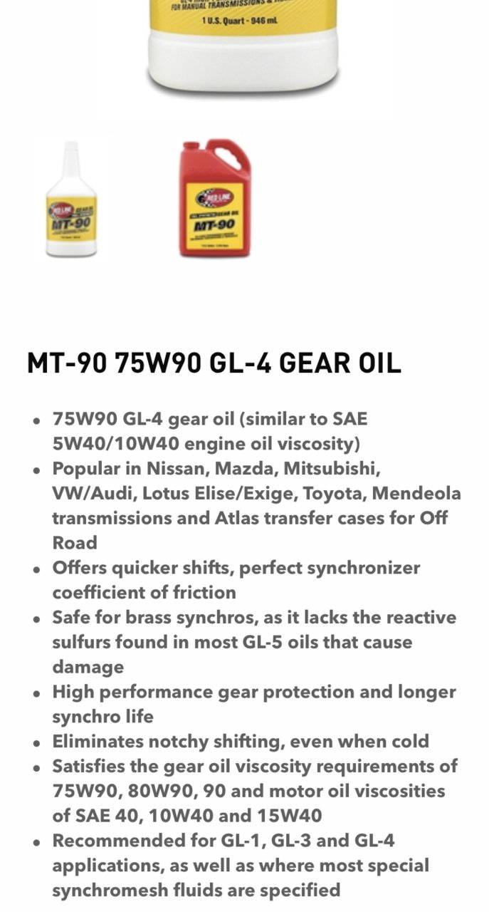

    This is what I have in the truck.
    I was incorrect.
    On paper it sounds great!
    In practice it's not as smooth as OEM.
