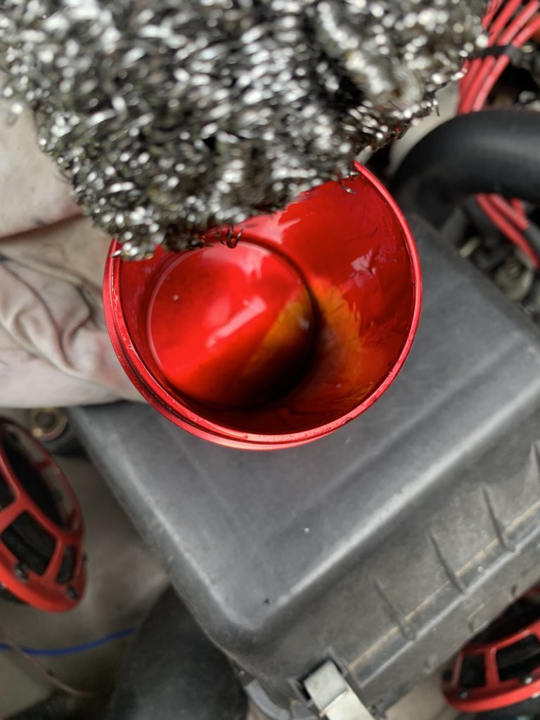

    if I remember correctly, I stuffed half of SS pad inside to the bottom
    now mine has 1500 -/+ miles since OS install
    But
    Saw a thread while back
    Member installed OS…changed oil after 5k
    And was shocked at the crap inside the OS…..as was I
    Showed that $4 part does work

    Straight up oil
    Maybe 2Tbl spoons

    I see, looks functional, and about 50% steel of what was in my kit.

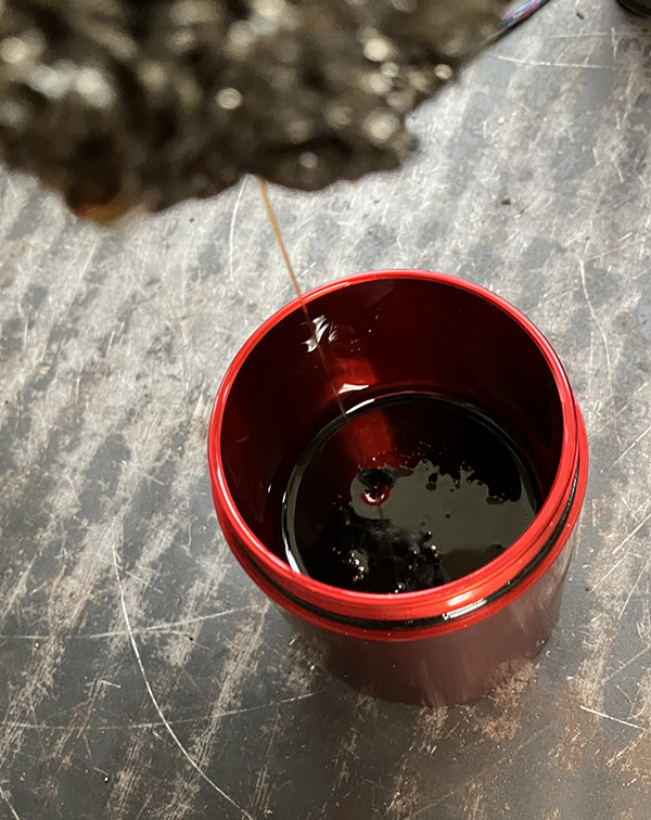

    Indeed, sorry, I forgot to mention this could be dangerous. I was just driving around the block to get some load on, get the oil circulating. I wouldn't want to remove the brake calipers. Luckily I didn't have to slam on the brakes.

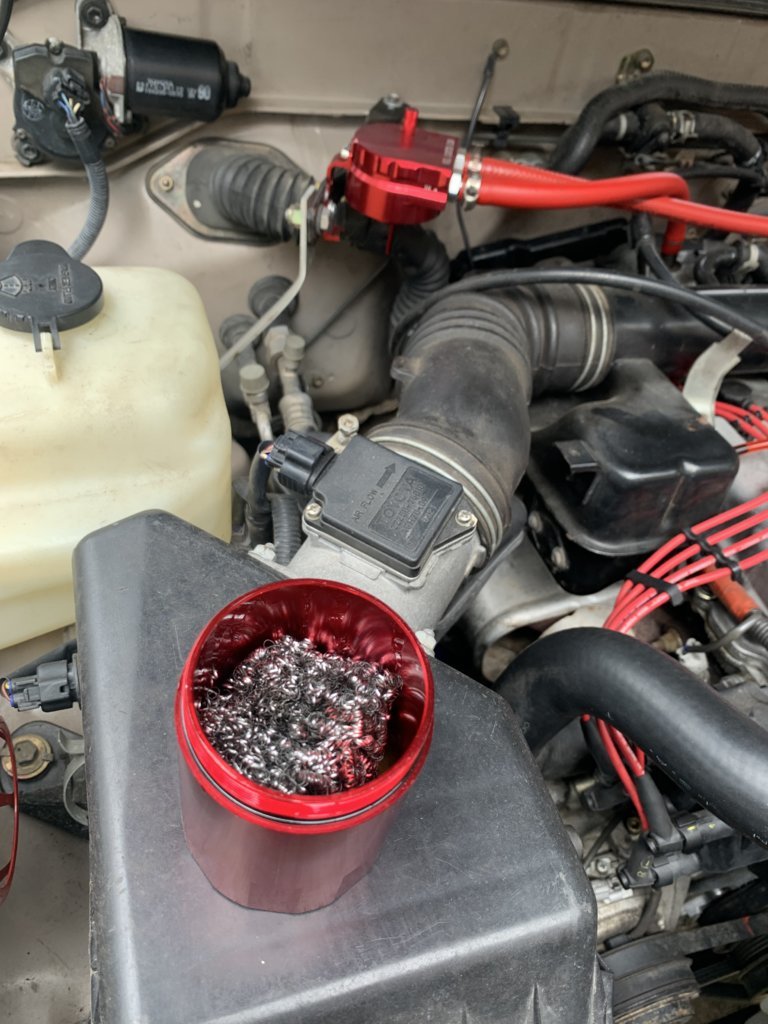

    Wow, yeah, that goo looks ugly, like an elementary school trash can during flu season. Your oil at least looks like clean oil. After I test drive, I can see just a thin layer of mist, I guess indicating that gases are flowing through the system.

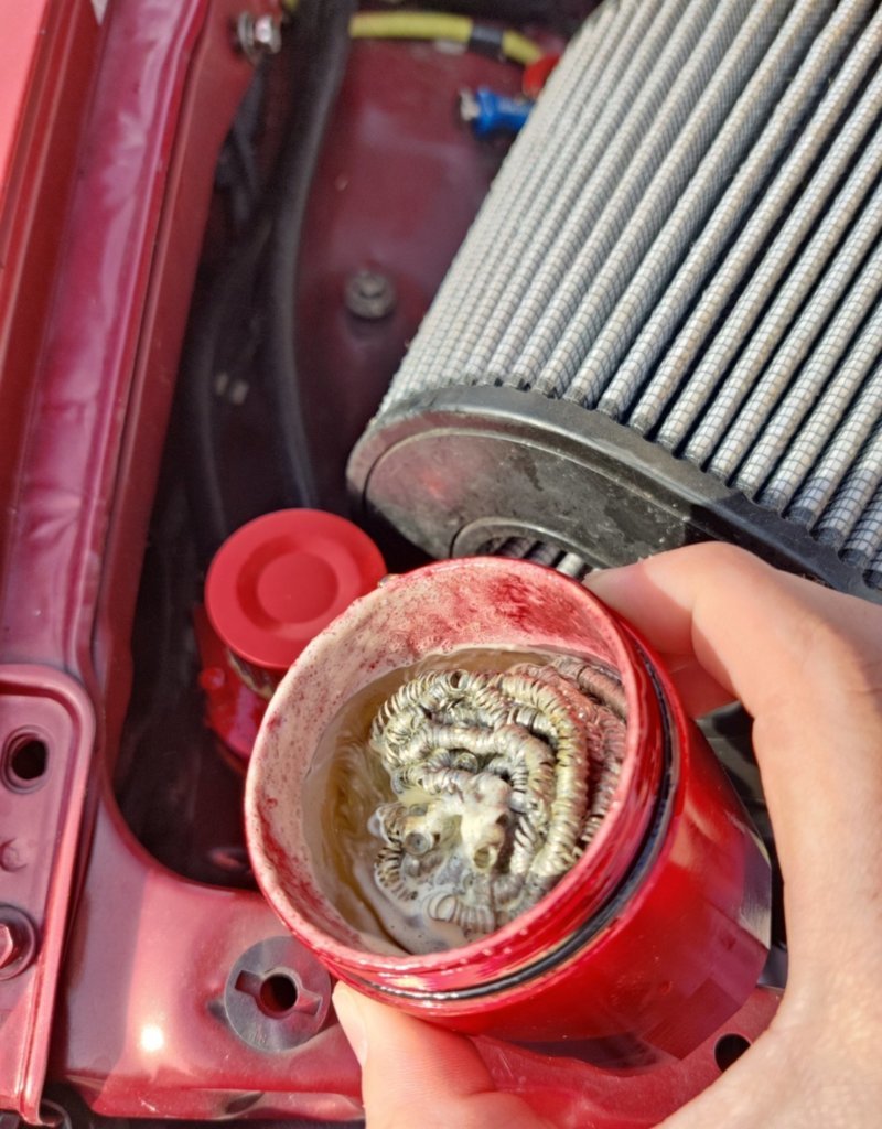

    now I’m thinking…… that the chocolate milk looking snott(!) might not be good
    Unk/puzzled what would cause that oil/water mixture in the catch can

    So today's report on this: The vehicle was put back together after a few errand runs, and a couple of oil drains, filter changes and examinations, which found varying degrees of small shmutz in the bottom of the pan. And the installation of the oil catch can. From my look at it, the Delo is absorbing and suspending the small sludge and varnish as one would expect.
    Then I threw caution to the wind and drove it out to the middle of nowhere and back (which is the need that warrants having this truck in the first place) and upon removing the catch can, found a good 1/2 cup of oil in it after every 90m of driving. The oil looks good, and presumably is not making it into the airbox or throttle body any longer, but jees, that's just too much oil to be making it through the (new) PCV circuit, in my estimation.
    To review:
    1) the engine does not smoke
    2) the vehicle passes smog
    3) the valves are well adjusted
    4) the engine runs smoothly, and has appropriate power.
    5) I have not found that I needed to add a pint of oil every week, maybe a 1/2 quart every 5,000 miles (that's about a year's worth of forest commute for me.)
    So, valve seals ? WTF?

    Screenshot_2024-09-20-11-09-02-11_40deb401b9ffe8e1df2f1cc5ba480b12.jpgwhat collects in mine is definitely more of a thin watery mix which is why it evaporates through the filter better in the hotter months. I also replaced the wire mesh in mine with half of a stainless steel kitchen scrubbing pad

    Hmn, yeah, you got more water in there I guess, just from hot/cold condensation...? My can came with that SS bundle, seems like a lot, nearly fills the can. I could maybe raise it slightly, but it wasn't far below the top of the airbox. The dipstick prevents it from being convenient for sure; I guess what do I expect for $4.25. Dumping oil as a routine is cheaper than buying a new truck clearly. I did replace the PCV valve and hose; that was the first fingers-crossed repair, which did nothing but let more oil into the air system.
