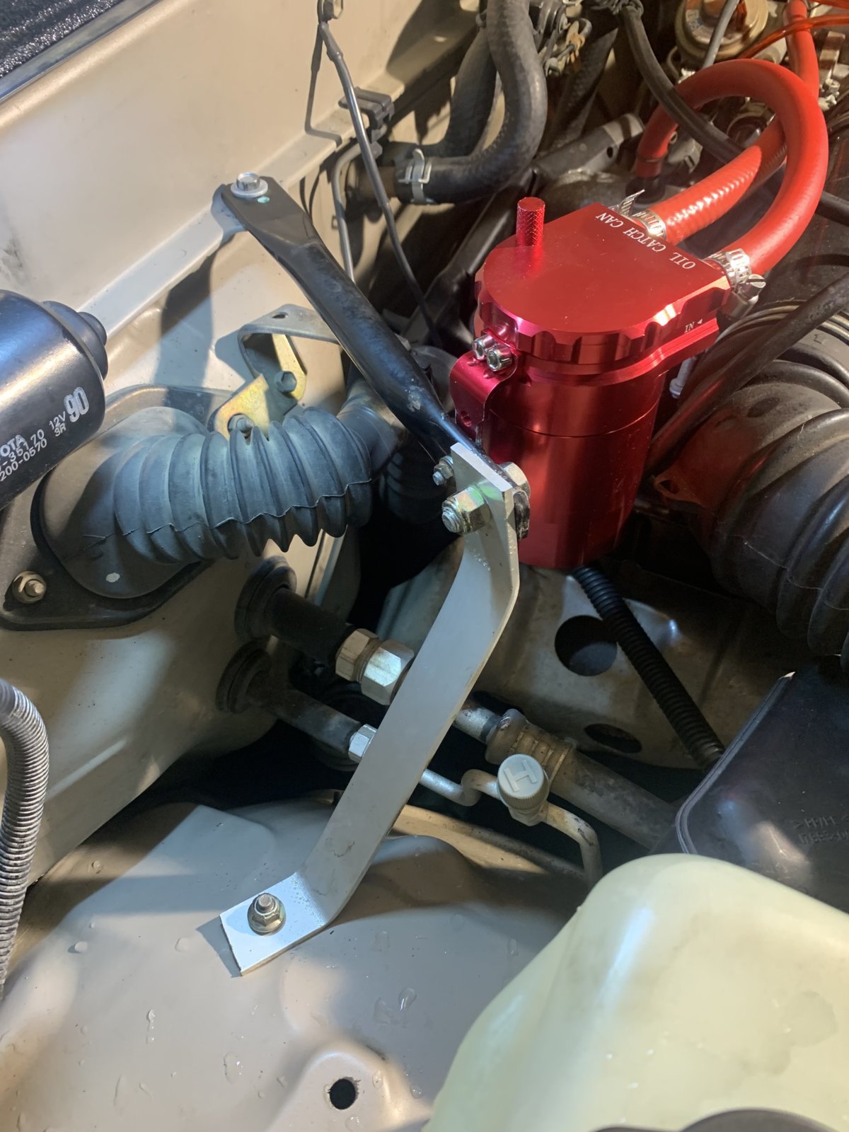

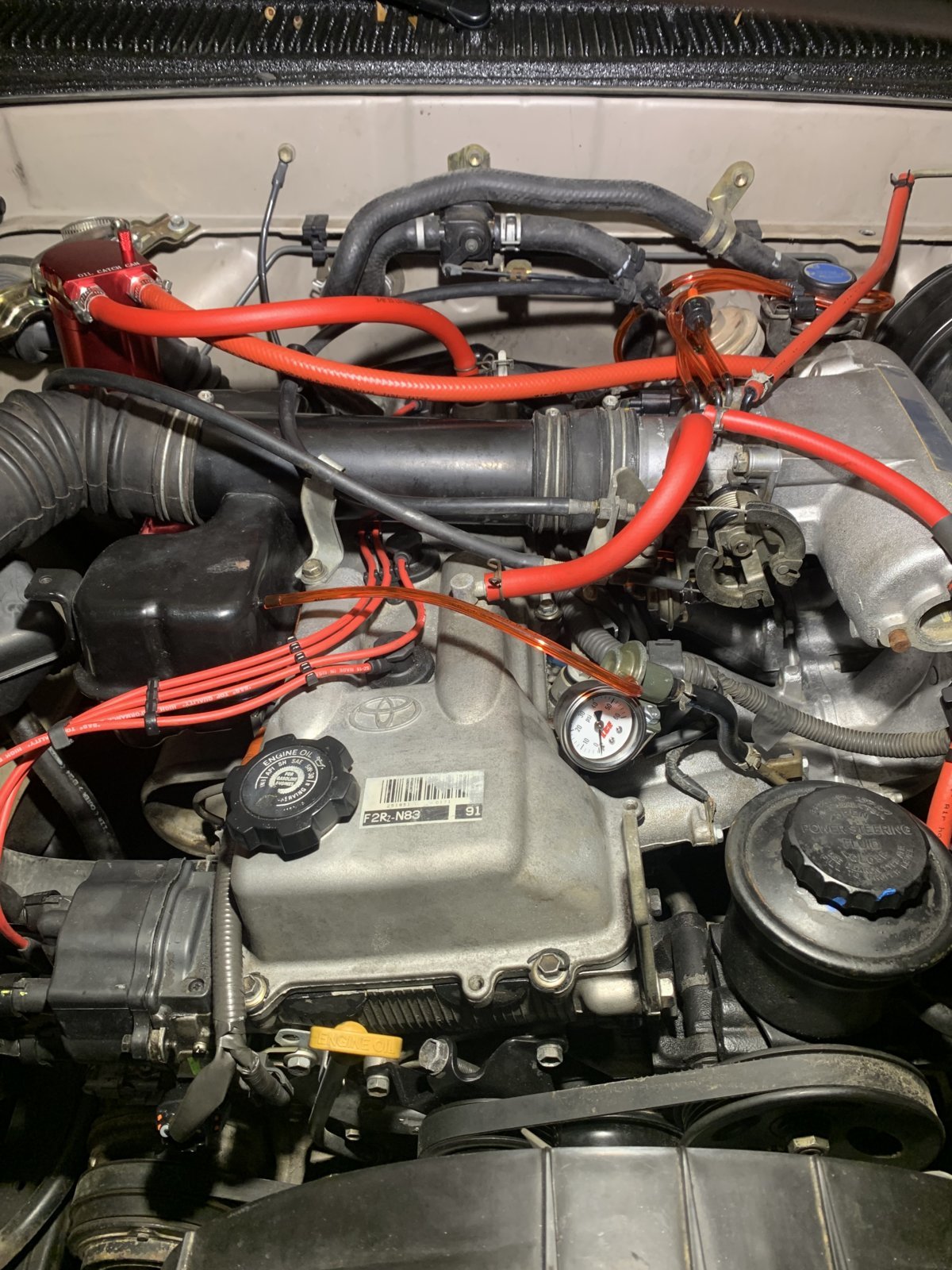

    1996 Taco 2.4L 2wd Automatic
    Clock Volt meter/LSPV Delete/Hyundai 16’s/FP gauge/after 9months of wrenching ZERO oil leaks
    that gauge is actually a fuel pressure gauge from LCE
    im guessing here but pretty sure all import(metric) manufactures have the same oil pressure sending unit(the one that always starts leaking) input (female thread) into the block
