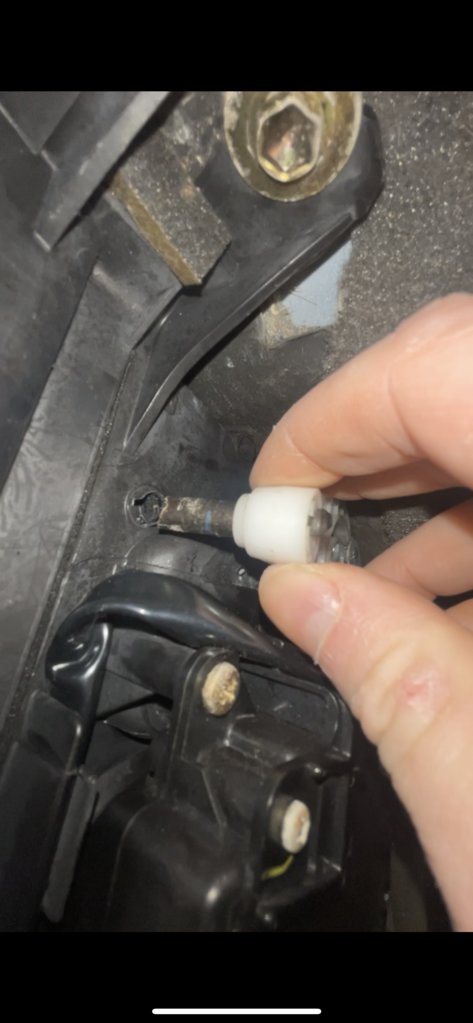

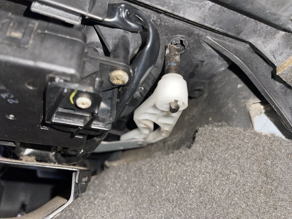

    58A33607-7A88-4EC5-A62B-C87BE79722EE.jpg 58A33607-7A88-4EC5-A62B-C87BE79722EE.jpg 58A33607-7A88-4EC5-A62B-C87BE79722EE.jpg 4EEF4F71-9B44-48BA-A9F9-02942CD91725.png
    I’m not sure why these uploaded twice or whatever. I’m on mobile.
    The actuator is working, the little plastic rod that it hooks to shown is seemingly broken and I’m pretty sure that’s the cause of my issue. If someone could look on theirs and confirm this so I can source a replacement before I tear the dash apart on my daily.
