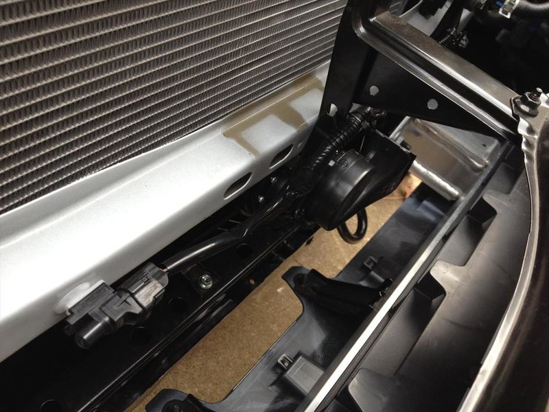

    Unhooked the tie downs holding the temp sensor/horn harness to the body of the truck. being a new truck this was super easy as the clips were not dry and brittle as they become with age

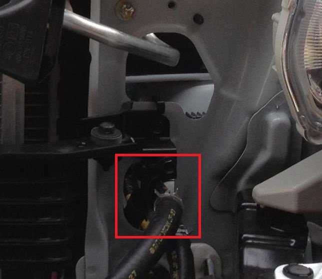

    Some other threads mentioned routing the harness through the hole the air bag sensor harness goes through. i didn't want to risk that so i ran mine through the hole the trans cooler lines go through. just above it
    Don't have a pic of the wires going through it.

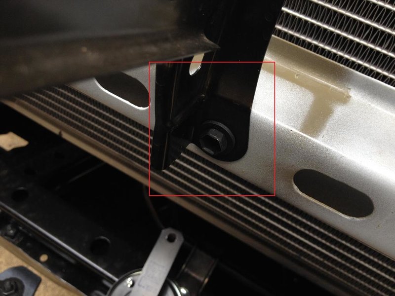

    Then, i removed the bolt at the bottom of the center brace

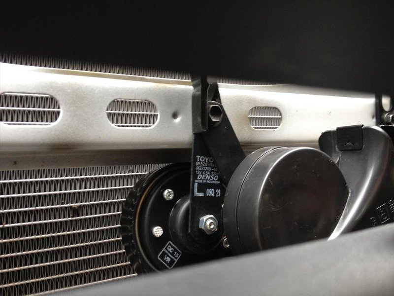

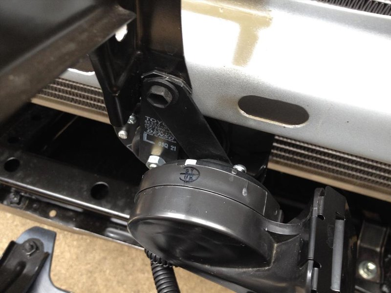

    i mounted one horn backwards and the other facing outward. basically one on top of the other and put the bolt back in. worked perfect. i think the horn i put backwards was the horn originally on the left in the stock location. i am going to go back and rotate the front horn a little downward just so water can drain back out if any were to get into it. this can be done by loosening the screw that attaches the horn to the bracket.
    A few inches to the left was a perfect hole to clip the temp sensor into.
