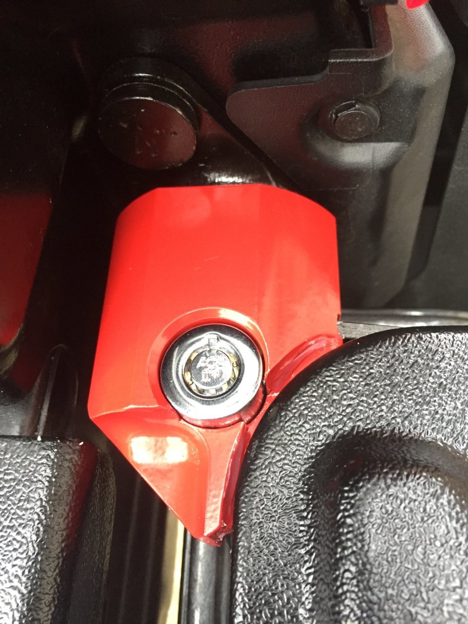

    I know there is a thread that covers this:
    https://www.tacomaworld.com/threads/3rd-gen-2016-tacoma-tailgate-lock.513023/
    However, having used the pipe/hose clamp for the Tacos I’ve owned, this time around, I wasn’t feeling too confident with the 3rd Gen and the price of an OEM tailgate.
    This morning, I was able to take off the clamp with a screwdriver, and Dremel in minutes. With there being battery powered dremels, I got on the sabellco train. Great thought and precision for what it is, went into your design @scleaf. The only problem I encountered was the plastic bushing protrusion piece that has to be broken off and the instructions that are floating around. A small curved needle nose plier will do the trick, so the user doesn’t have to take off the tailgate. It’s simple to break off, but to the first time user, it appears like it’s more than that. I tried looking for a picture, and forgot to take one, as the initial snap did not fully break it off and that’s the last thing I was thinking about.
    Good luck to you with future instafans and thank you!!!!

    Looks good and should be hard for a thief to break quickly.

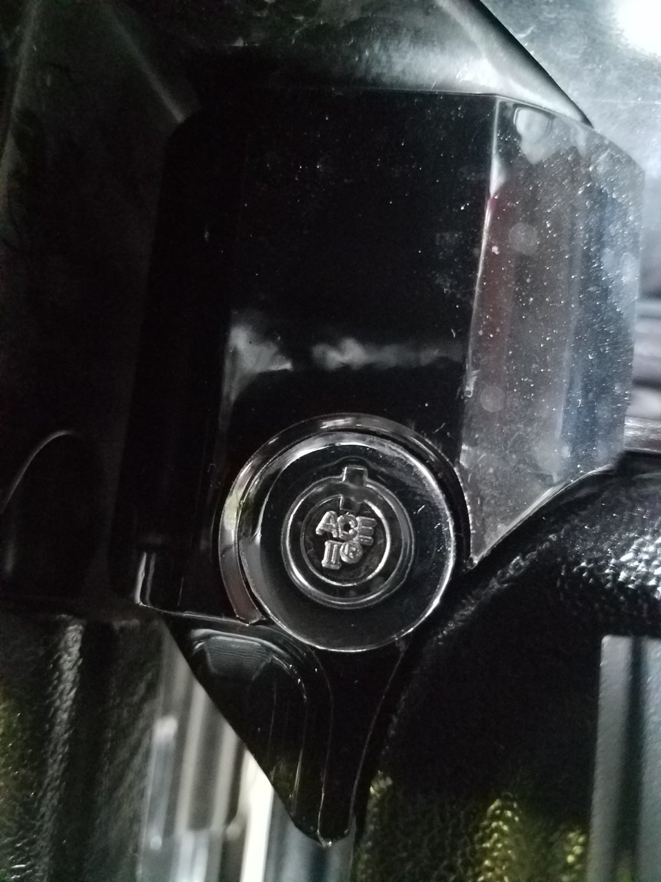

    I've had my Sabellco for a few months now and I was concerned about water/dirt going into the keyhole but so far it's been clean. This lock is badassScreenshot_20180414-155625.jpg

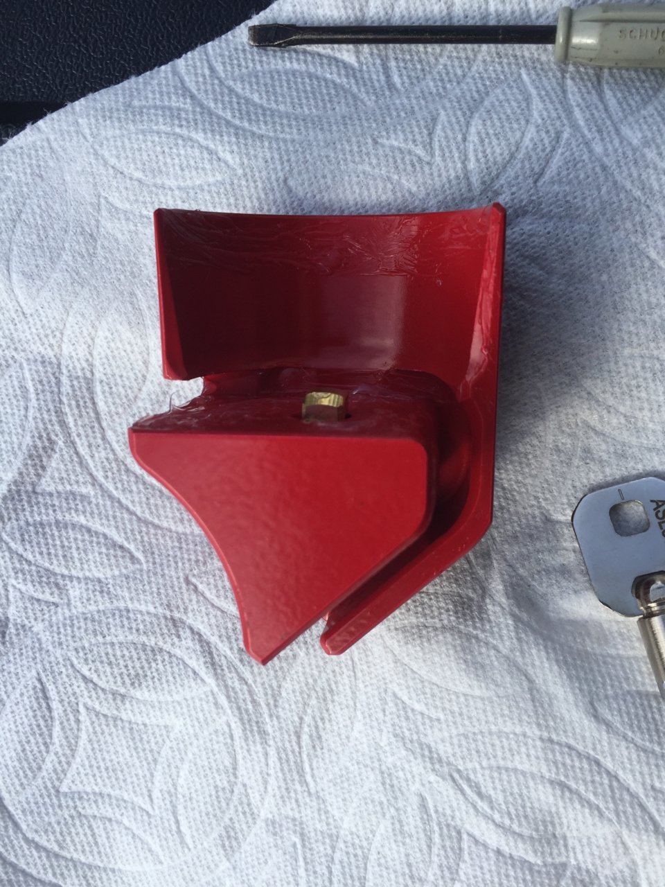

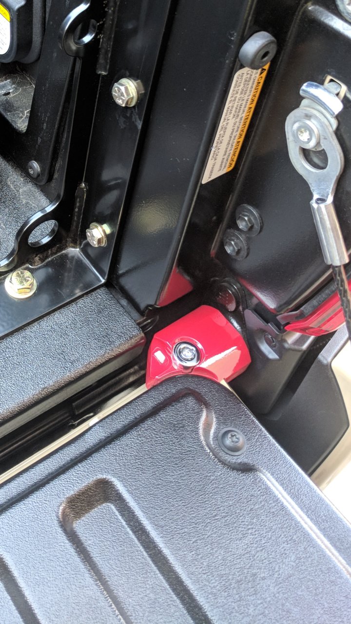

    Count me as another satisfied fan of the lock.
    The great thing about it is that you can securely leave your tailgate down while carrying long pieces of wood that I’m not worried about being stolen.
    The fit is perfect as it easily slides into place, and I think it needs no changes.

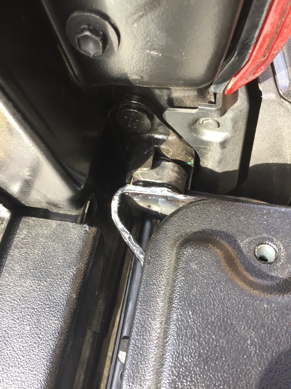

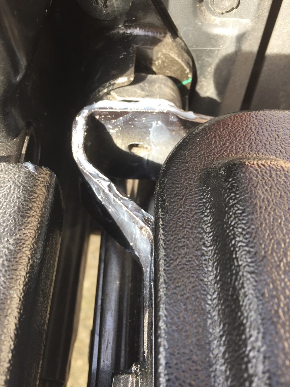

    I did notice that it does move around just slightly while in place, so I decided to place a thin bead of silicone caulk on the top edge of the tailgate hinge and also applied a thin layer of silicone on the mating surfaces of both the hinge and lock to isolate the lock from the paint on the hinge.
    I let silicone dry first and then slid the lock on and firmly into place. It’s nice and snug and I figured it would now have no chance of slowly rubbing through the paint by vibration and movement over the years.
    EBCEFCB5-D2E4-4475-ABC3-9D718A23E60A.jpg D3E2306C-B2C9-48E5-928C-817CDCD2FD92.jpg 97D4A20A-82B6-48B4-AD8C-C4E3FD49B27A.jpg 39438140-2FFC-411C-BC86-745E4885CDBC.jpg
