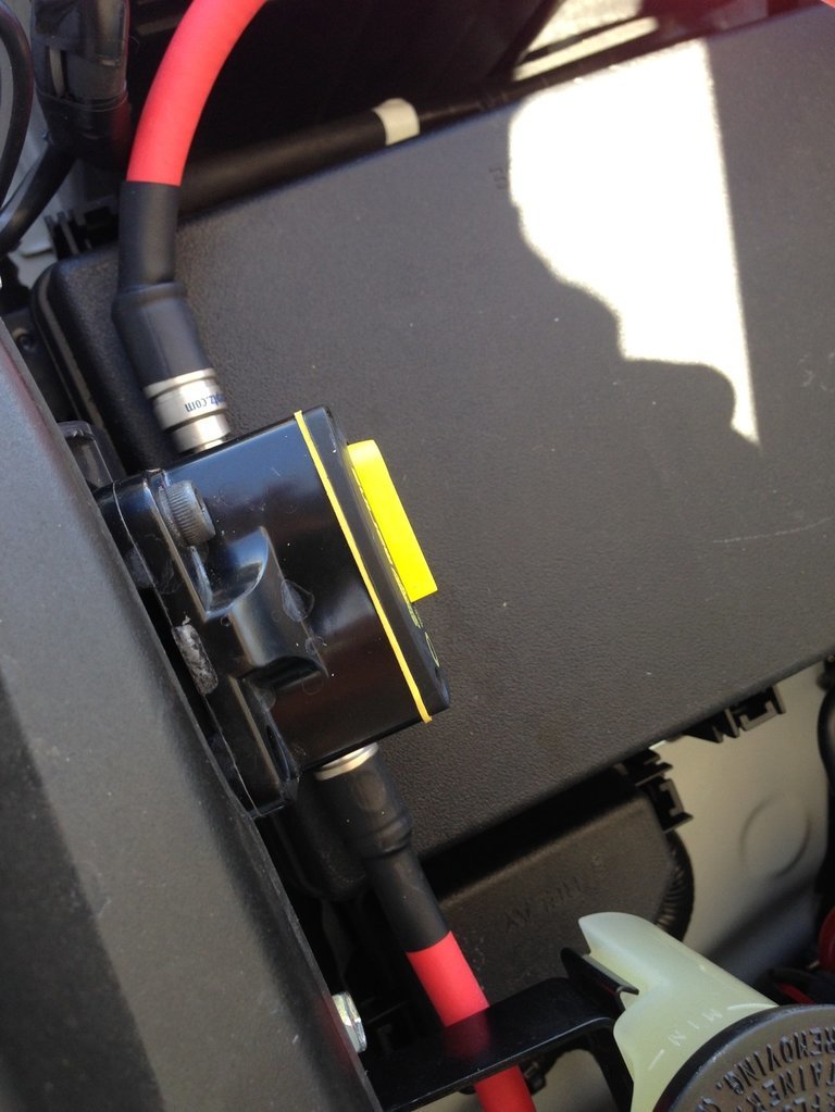

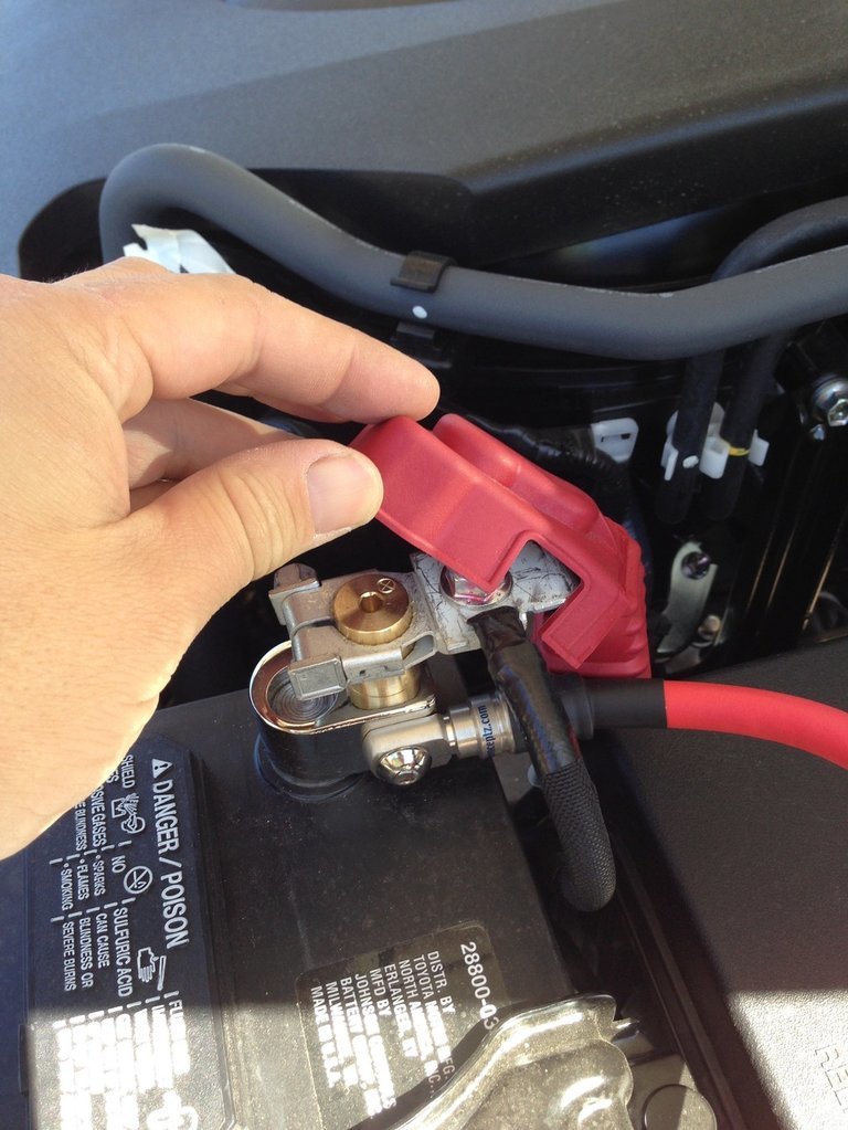

    The wiring under the hood is done! I liked how it turned out..

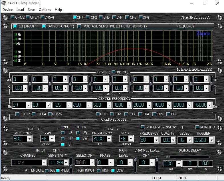

    For those of you interested; here's a snap shot of the Zapco DSP.. Nothing is set right now.. I've already played with it, works great.

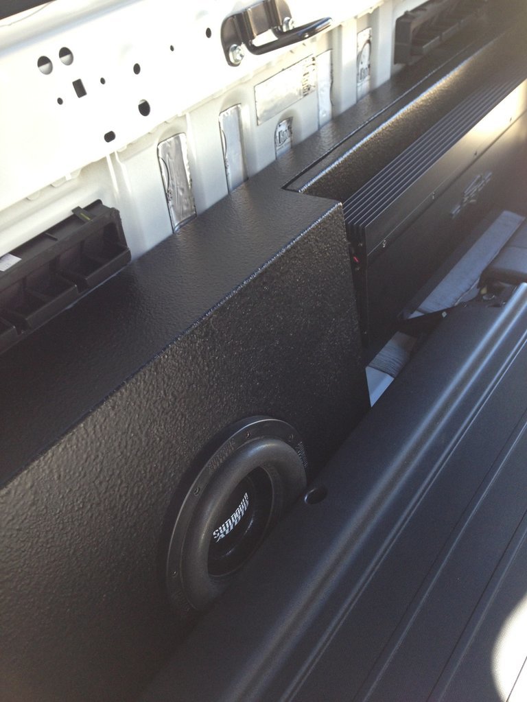

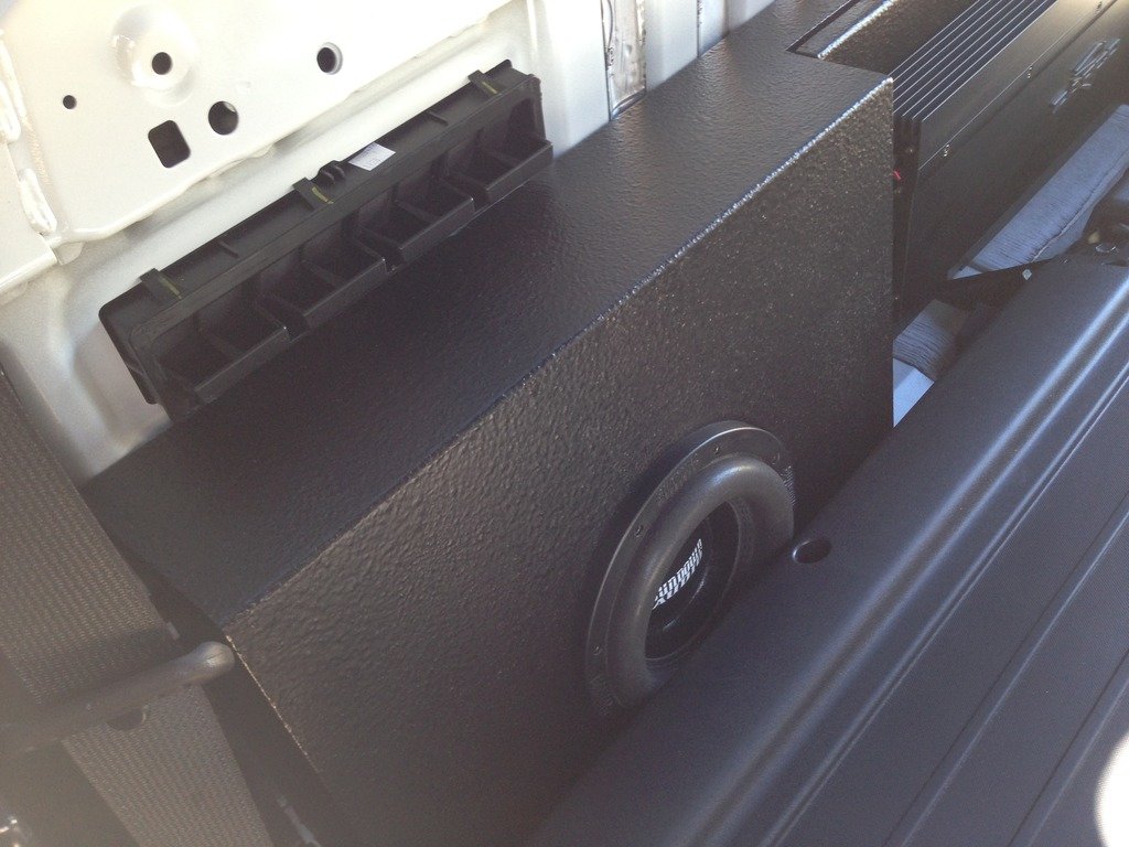

    My custom RCA interconnects are delayed, so I went ahead and finished the box! I really like the monsterliner product. Very easy to mix, apply, and get texture.. This stuff is going to replace carpet in my boat! It came out excellent..
    A few tips.. Installing screws..putting some lube on the threads (frame) really makes the galling issues go away.. Its very easy to strip dry threads .. I replaced the original ground terminal with a low profile one.. The box install went in much easier.
    I put ensolite foam on the back side, and CLD pads on all areas that the plastic can vibrate.. I should be good to go.. Anyway, I hope to turn on this system in the next few weeks!

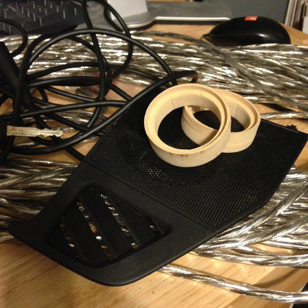

    Getting close.. when I get my interconnect cables, I'm going to take a day and install all the speakers, and connect up the system. I'm still pretty motivated in this project, so I decided to make some speaker pods out of the tweeter covers. And, hopefully, the sound stage will be amazing.. Much better than shooting up into the windshield..

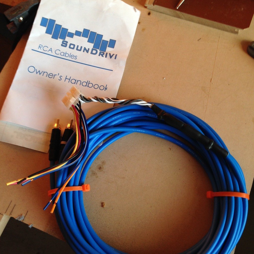

    my custom RCA interconnects came in!

    Here's a sneak peak of the speaker baffles for the front stage. I've been thinking about it for some time, and finally have an excellent strategy for building the pods! things are speeding up a little..

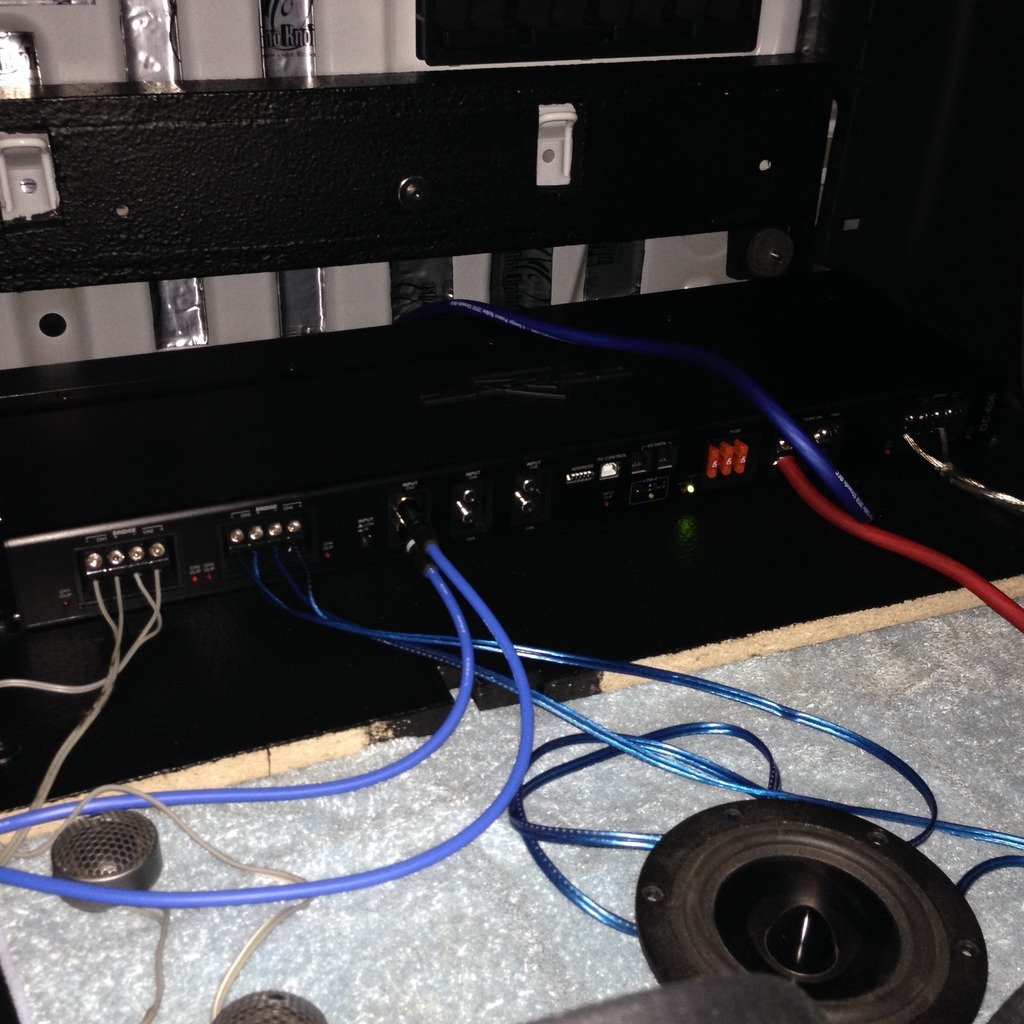

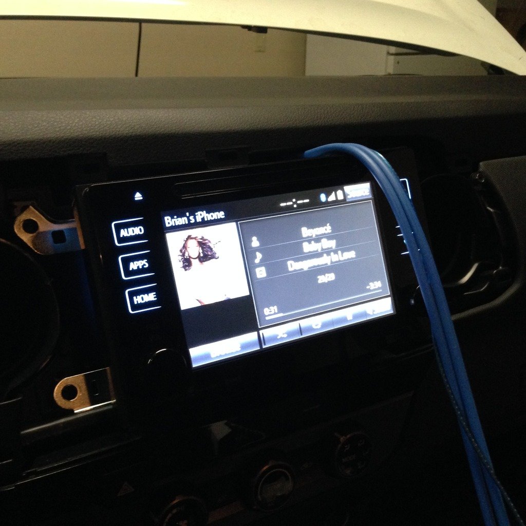

    I hit another milestone.. The wire harness works! I didn't want to get the aftermarket speakers installed , and have issues, so I hooked up the system tonight. Everything works fine so far..
    The sundown was hitting too! We'll see if I like the sealed versus ported sound better..
    As you can see, wiring is very simple (which I like).. I didn't need to worry about remote power.. turns out the hi inputs automatically turn on /off the amp. There's a delay, so no popping. Only minor issues like the metra harness into HU was tight and didn't want to lock in, and the RCA's were tight, so they were adjusted. Some amps, its easy to damage the internal RCA board connections if using too much force..
    I heard louder than expected noisefloor from the tweeters, but I think its just because the gains are not set. It was pretty loud at middle volume. :headbang:

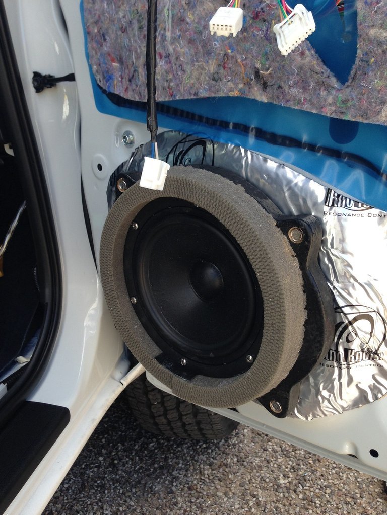

    I had a half day, so I installed the door speakers! Everything went in easy peasy..
    Installing the door wires was a breeze... The trick is unhooking the wire harnesses to gain access to the rubber grommet.. Just follow the pics.
    The system is getting there, running a one-way right now lol
