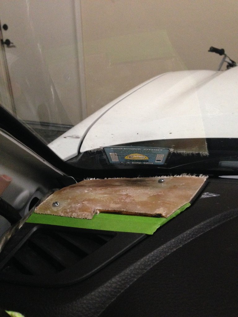

    Hey man, thx! Yeah, I did some rough 3M filling, but this stuff goes on thick.. around 40 to 60 mils.. Great stuff! Drys hard, not soft.

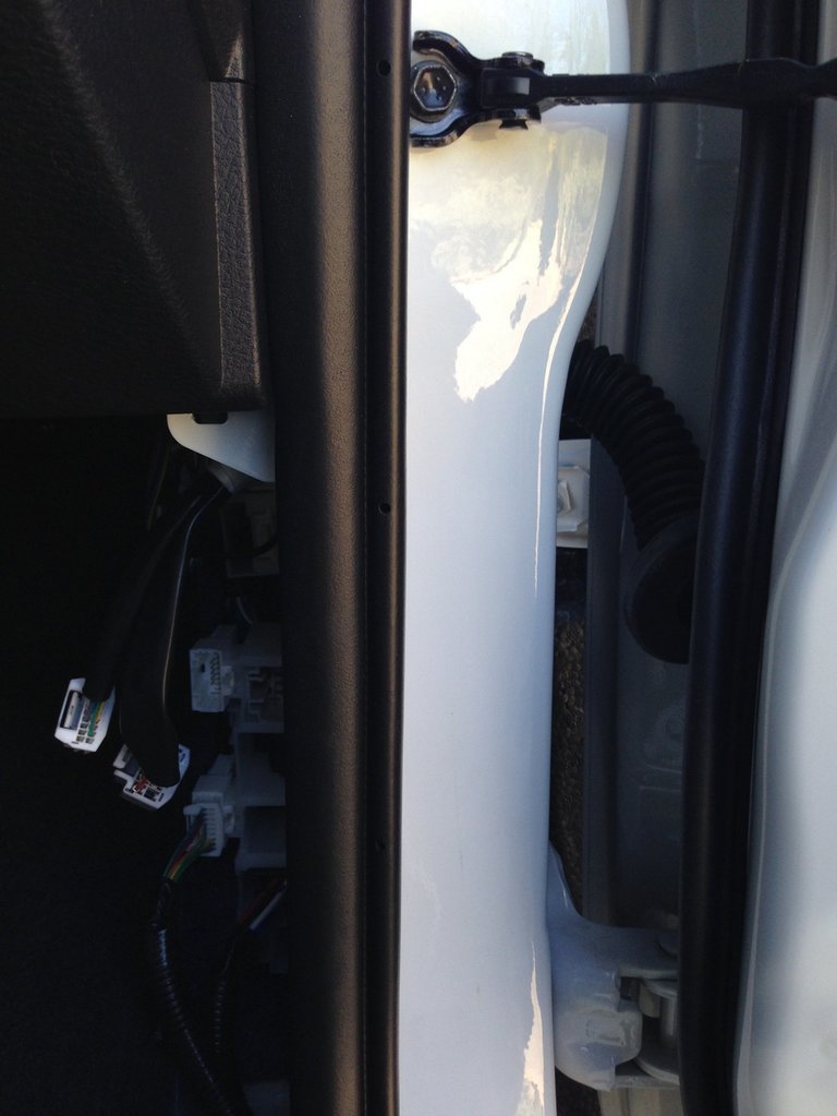

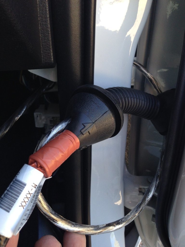

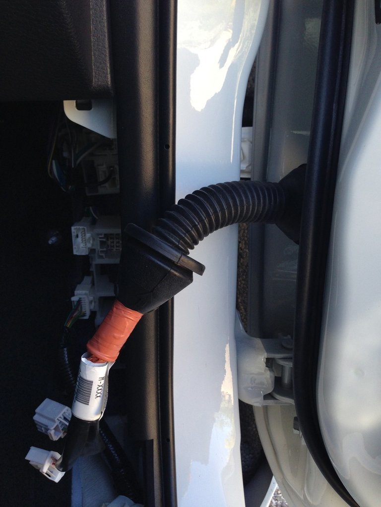

    Speaker wire?
  4. Apr 26, 2016 at 9:07 AM
    #84
    bginvestor
    bginvestor [OP] Well-Known Member
    Feb 5, 2016
    #177174
    127
    16 gauge KnuKoncept wire, twisted with plastic sleeve.. shown clearly in the third pic above..

    That's a thick ass wire! I've never seen something like that.
  6. Apr 26, 2016 at 3:39 PM
    #86
    zinger
    zinger Well-Known Member
    Oct 6, 2015
    #165960
    339
    2016 Silver Sky Tacoma SR5
    Tried to fish my front door speaker wire through the boot but gave up and just spliced into the existing speaker wire. Didn't think about doing what you did, wish you had posted this about 1 month ago :). Had no problem getting speaker wire through the back door boot.

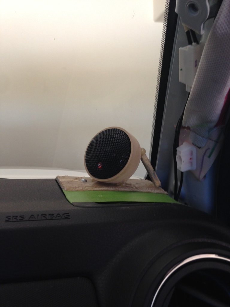

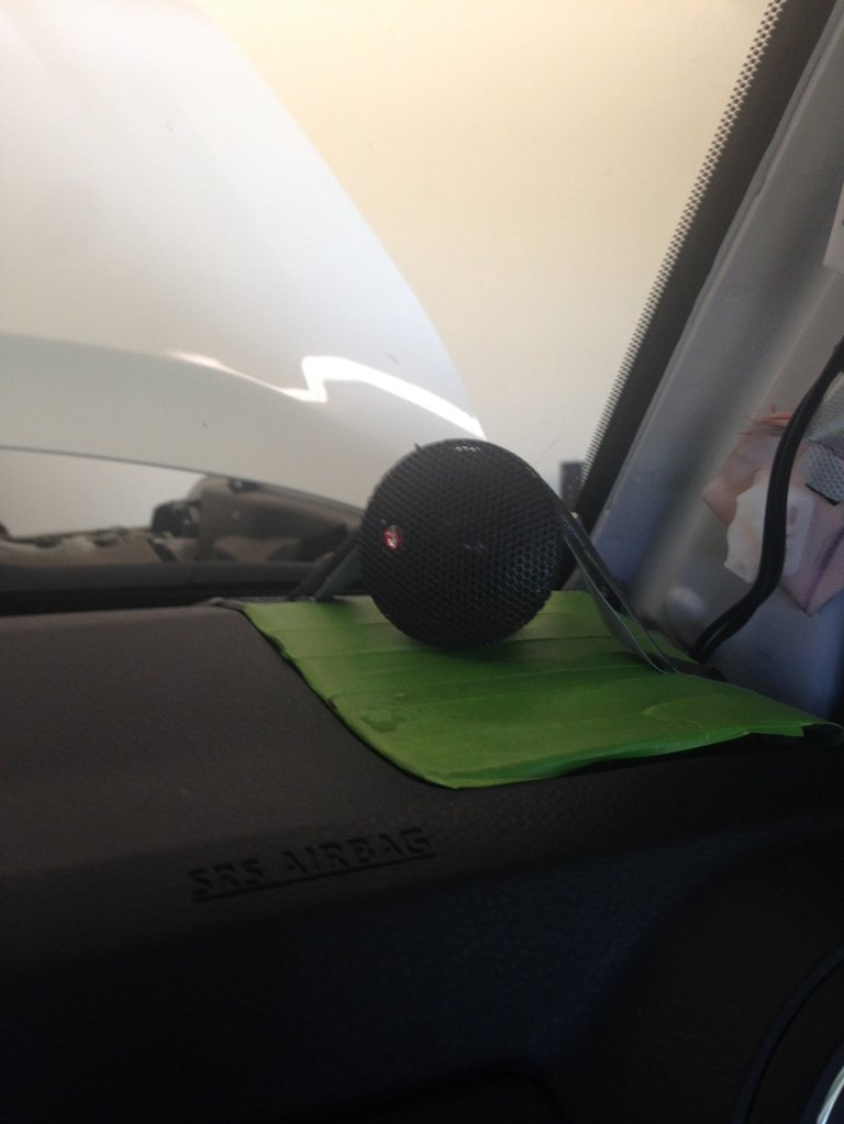

    I now have all speakers running.. currently experimenting with front stage speaker positions..

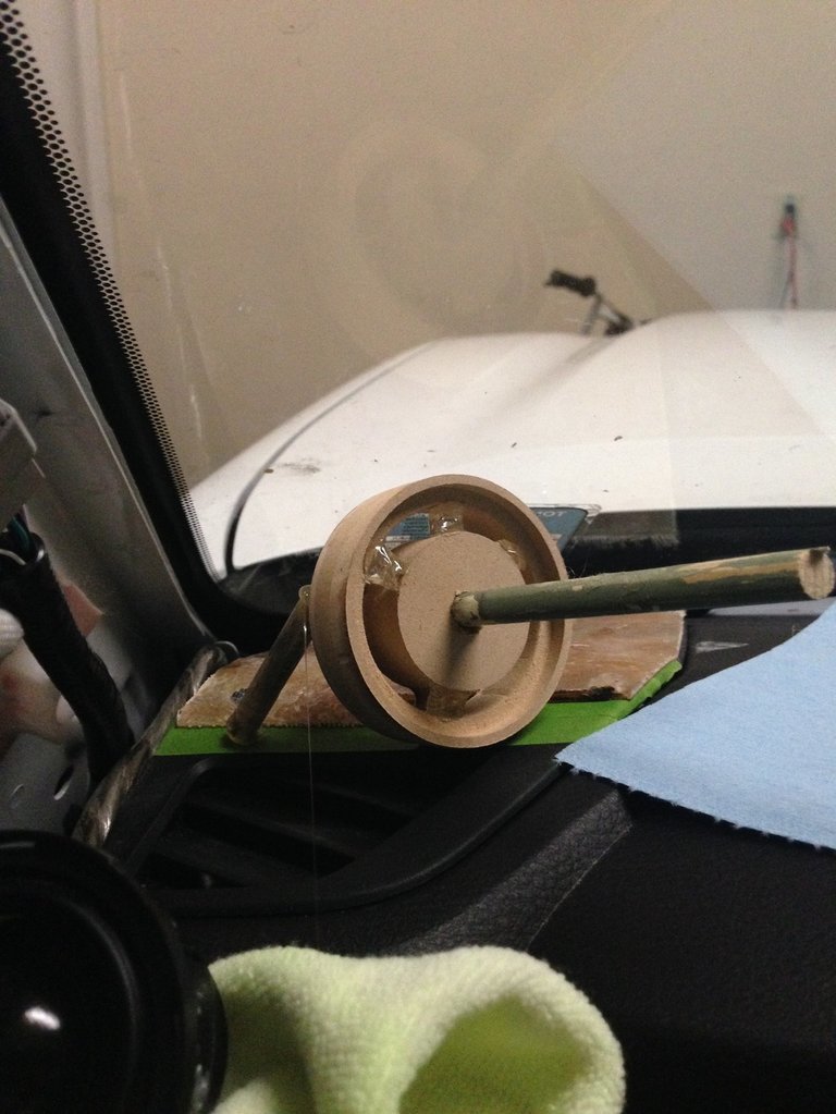

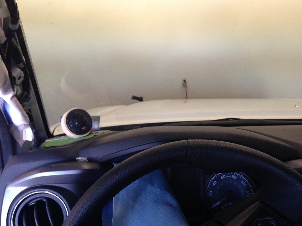

    Well, we have to be a little careful here.. I did test tones of a pure sine wave which is not the same as dynamic peaks from music; but yes, I got the HU to distort pretty bad. Its an indication that the HU is not capable of producing a clean signal all the way up to 60 volume. This is typical of most decks by the way.. If I get more time, I'll post up some pics. Its fishing season, and couple that with family, its almost impossible to give a lot of time at this audio project right now..
    However, so far, I'm very happy. The system is not tuned yet, heck the gains aren't set yet either, but I can already tell the final product is going o be great. I might even compete if I can find some local competitions..
    The sundown woofer is excellent! Very very nice SQ sub, and I do not miss having two either.. One is actually perfect. The door speakers are great as well, no vibration, and producing nice mid bass that I can feel!
    The front stage are the CDT ES-02c's. Very nice, and the stage is already excellent only just setting time delays. I believe everything is going to come together nicely..
    The only outstanding items are making dash pods, tune, and tucking in wires..

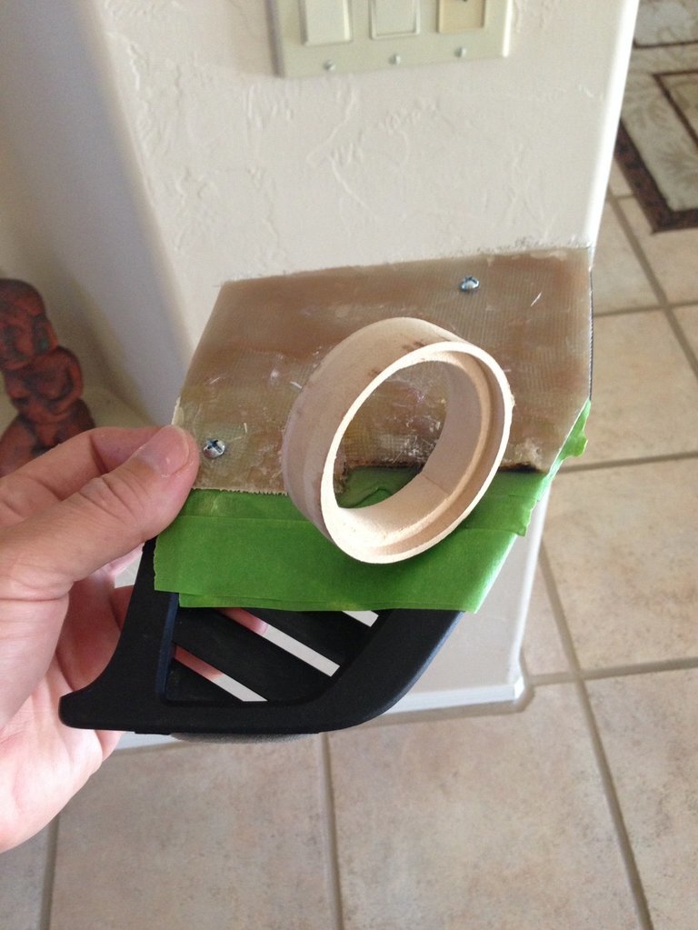

    Is there room in the dash under the stock grill for the 3" Hertz mid? I hope to run the HSK163 up front in my 16 however I'm 2 weeks from delivery so I can't check myself. Killing me!
  13. May 17, 2016 at 6:25 PM
    #93
    bginvestor
    Feb 5, 2016
    #177174
    127
    I had the 3" hertz mid in the last vehicle.. My guess is maybe with most likely some modification of the dash at some areas .. The depth will not be the issue..it's the perimeter..
