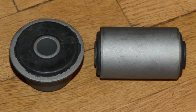

    Anyway, I brought the shackles (one aftermarket & one original) & mangled bushing in to a local spring shop & the owner suggested to go back to the original shackle. He said these bushings
    would work as long as they, obviously, fit in the aftermarket springs. I expect they will since they were supplied by the seller of said springs.
    Prior to talking with him & being unsure what to do, I ordered some energy suspension bushings, which I may run into a fitment issue with as well, yes?
    I have pressed the mangled bushing out, however the outer sleeve did not come out.
    Questions - which bushings would be recommended ES or the ones pictured above?
    If ES, am I correct in thinking the outer sleeve stays in the spring?
    One benefit to the ES is removal down the road. Those others look like a PITB to remove. I do know the ES ones need to be greased though.

    The outer sleeve and rubber bushing are one piece, when the OEM rubber style bushing gets pressed out the outer sleeve comes with it.
    The ES poly bushings go in and come out by hand
    Both should fit, someone correct me if I'm wrong. It's just a matter of whether or not you want rubber or poly bushings. Poly lasts longer but tends to make more noise, lube them up well with the supplied grease that ES sends with them.
    Rubber tends to not last as long but stays quiet generally.
    Also the rubber bushings need to be pressed in, poly you can do by hand as they are two piece.

    Since things change all the time last time I installed the Energy Suspension bushing the outer steel shell from the Factory bushing was used.
    Have Energy Suspension upgraded to supplying the steel shells??
    Maybe with the weight I carry most times the bushings don`t squeak I never heard them.

    The poly bushings for my leaf springs, both the Alcans and the Dakars before them didn't come with outer steel sleeves. You just slide the bushings in and put the inner sleeve through the middle
