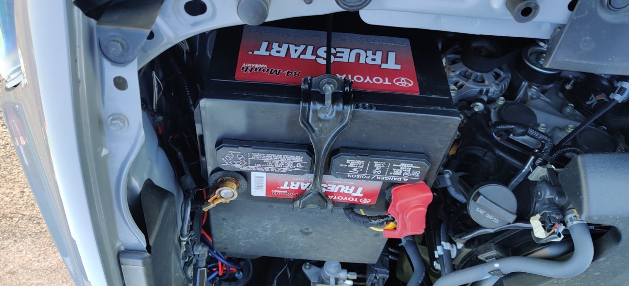

    After reading another posting about his leaky battery , I gave mine a peak this morning. And yes....... We've got a leaker. My truck has 4000 miles on it now. Its probably been leaking for a bit. It was under the tray. Popped the battery caps off and saw that it was full to the top practically. Have speakership appt Tuesday after the holiday. Costco has seal AGM battery for $ 154. I ordered it. I figured fuck it , what will they do Tuesday , tell me its '' acceptable leakage''. I did notice it was tightened down so much from the factory, that it was dented.

    Southern Ohio
    2017 MGM DCSB Off Road, 6 Speed MT, P&T
    Since you are under warranty send the receipt to Toyota and you will get reimbursed for it.

    Never posted update. Had appt with dealer. Couldn't loose the day waiting there. So I ordered a AGM battery from Costco. While waiting for battery, I popped the battery caps and it was literally full to the top. I used a few lint free rags and dipped them into each cell to lower the level to the bar on the inside. Put caps back on and its not leaking anymore. And on a side note Costco never called lol.

    Hopefully you removed the battery and cleaned the spill area with baking soda, rinsed well and dried before reinstalling the battery.

    My battery seems to leak a bit more than any lead acid battery I've had before. So bad that in under a year I was seeing corrosion on the terminals. Months ago I got some Noco cleaner and corrosion preventative. cleaned it up and treated it but still seems bit wet.
    this the products I'm talking about:
    https://www.autozone.com/wash-clean...-ncp2-all-in-one-battery-saver-kit/257146_0_0
    I might still say something at the dealer when I'm in for my 15,000 mile service next Tuesday.

    Well as I type this the dealership is going to warranty my battery. They said it is leaking and making crosoion even on the hold downs and they can tell I tried to fix it up and wasn't successful so I get a new one!
    Edit
    Not only a new one but an 84 month warranty one.
