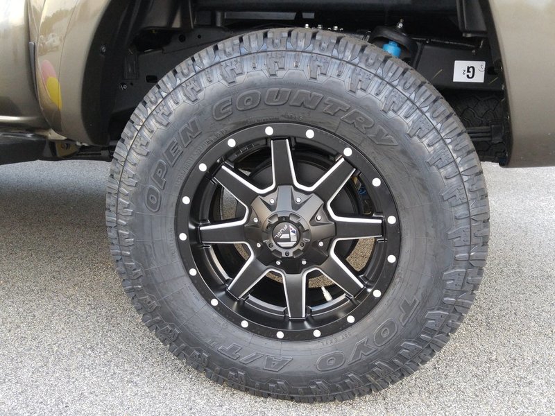

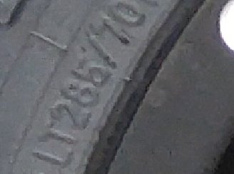

    I was just thinking of this(Carl's post triggered my dumb brain). How about the tires? those trucks at the dealer all have 285's on them. Before I waste more of your guys time could it just be the tires lifting it up so high? I wouldn't think so but I'm not a "big" tire guy either(never got into them).

    For some reason I see 265 :notsure: If they are true 285's, the front inner fender plastic at the bottom near the mudflaps would be trimmed just to drive it on the street and not rub. They also have the mudflaps removed. You will have to see tonight. If they are 285's there is definitely some kind of lift on it

    it is tough to see but I'mCapture.jpg almost positive they are 285's. I did a screen cut. Still tough to see. and I will double check tonight.

    285/70R17 added about 1.5 inches of lift I think... there is a tire calculator on this site somewhere that tells you the difference in size for different configs.... I really should have gone with 285/65R18 which would have given me the same hight but no wider than stock.
    Note you cannot put 285/70R17 on a stock truck without a 2.5 lift... infact, I had to remove a tiny bit of the inner wheel well liner (front rub on turns)... and I removed my flaps but I plan to put them or a aftermarket set back on.
