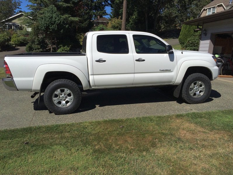

    Here is mine with OME 885 coils and bilstein 5100s in the front and a .5" custom AAL with bilstein 5100s on the rear. This setup leveled my truck. I'll be going to a full leaf pack in the rear by next summer. I'm running 265/75/16 Toyo Open Country AT2. I also have a diff drop kit and carriage bearing kit. I have ZERO issues with anything. Once you go over 3" of lift is when you could start having the issues the shops speak of.image.jpg

    So about how much of a lift did this truly give you? 2"

    2.5" front and .5" rear. I have my ground to fender measurements in another thread.

    Stock
    LF - 34.25"
    RF - 34.5"
    LR - 36.5"
    RR - 36.5"
    Lifted with 265/75/16
    LF - 37.5"
    RF - 37.5"
    LR - 37.5"
    RR - 37.5"
