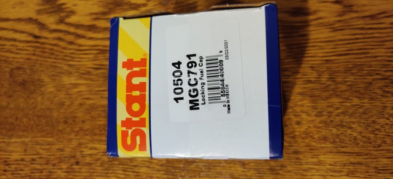

    Mine did come in a stant box and seems to have the thick rubber gasket that you describe. maybe I need to post pictures. still possible it's a counterfeit.
    #24

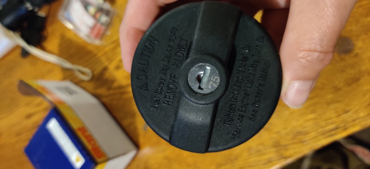

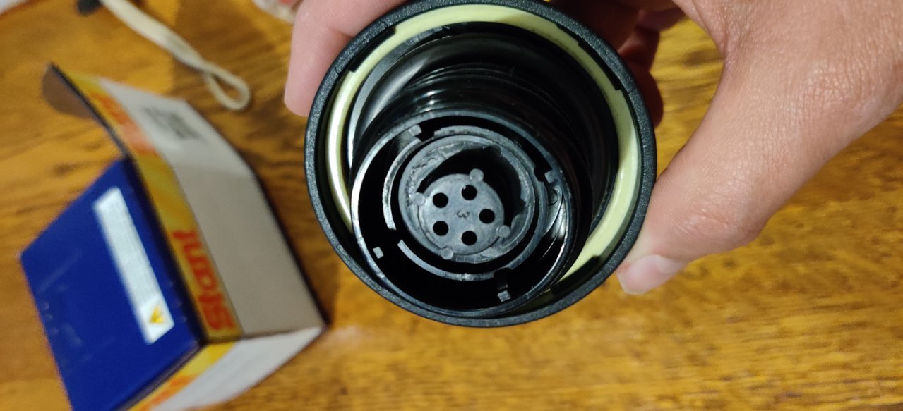

    So here is my cap and also again it caused a check engine light.
    And the cap. It doesn't have the brand name on the cap that I see.

    I have what appears the same stant cap...so far nearly 2 years its been working fine.
