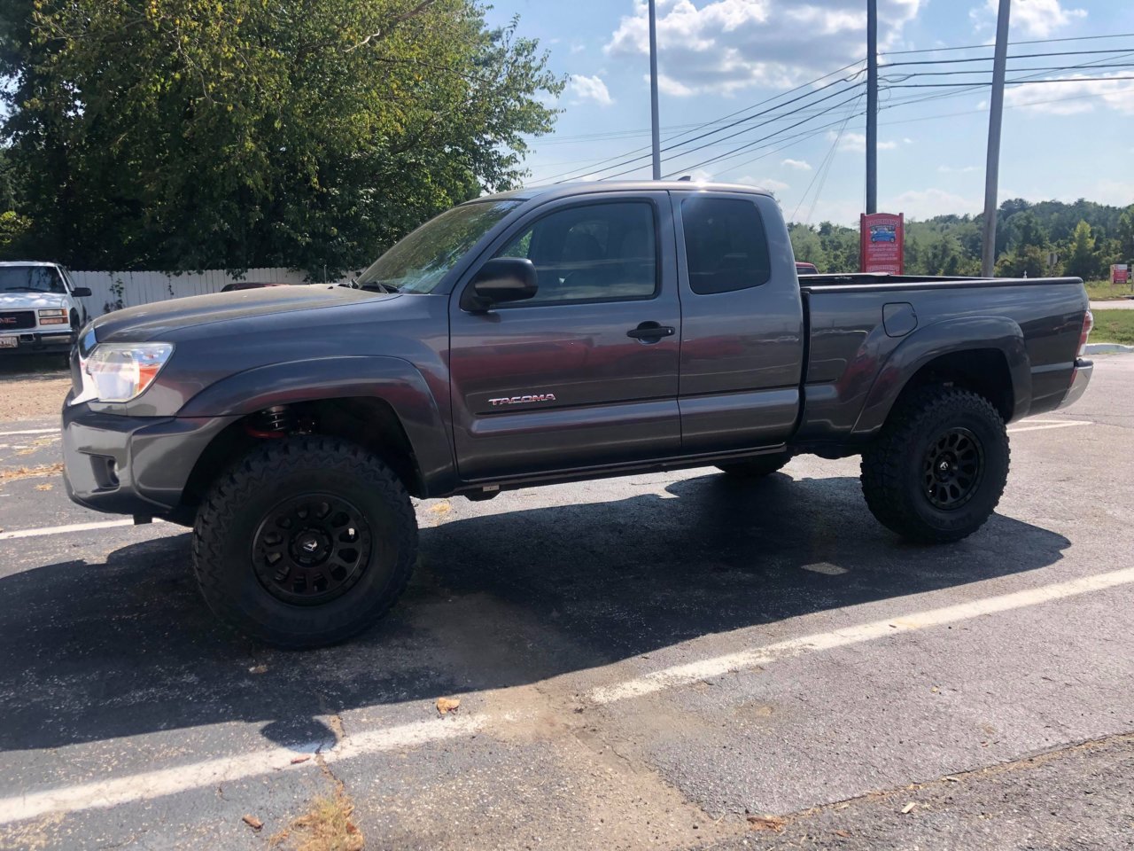

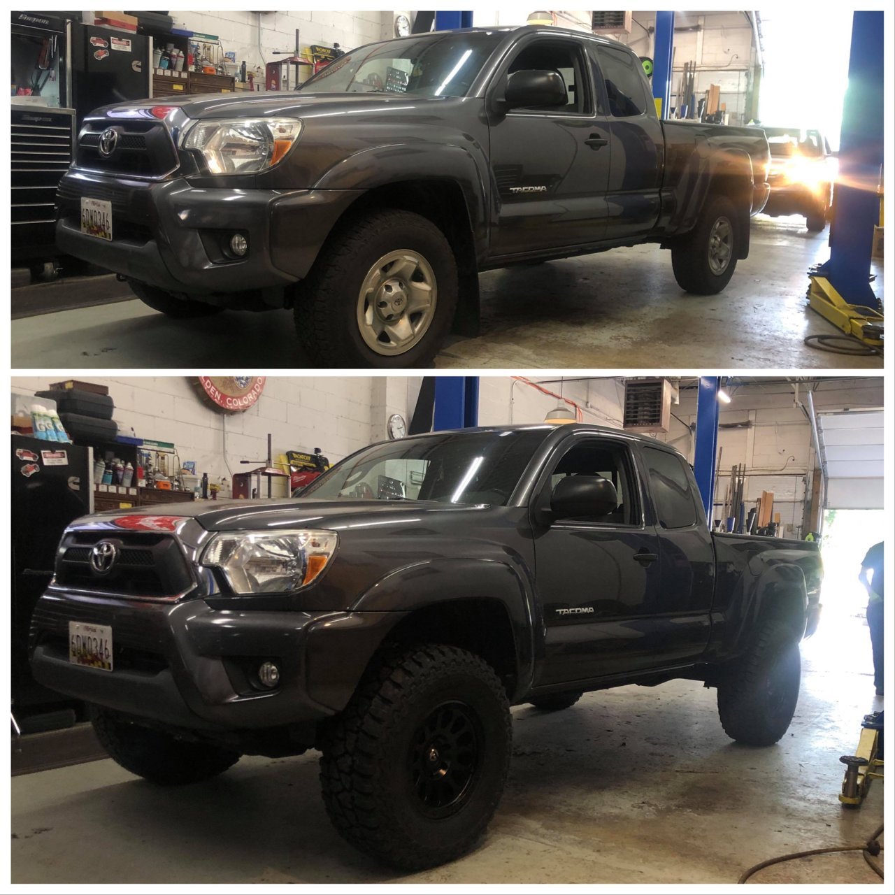

    2014 MGM SR5 AC

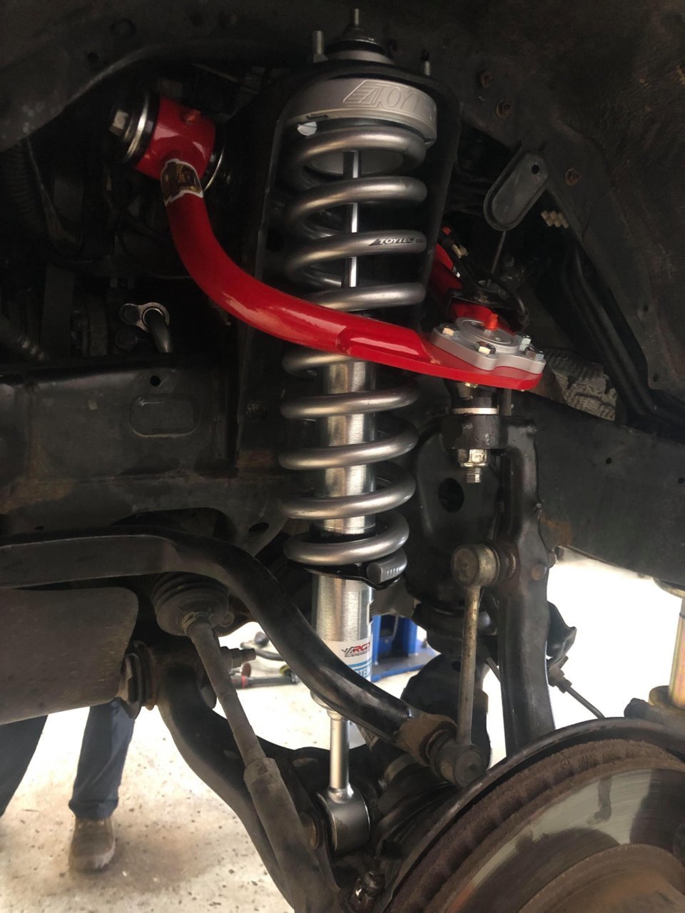

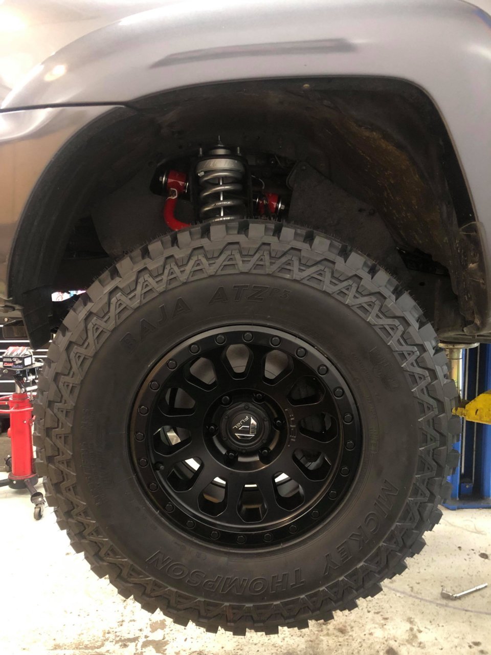

    Finishing up the lift now, while in the shop the front brakes were toast so replaced those, and the LCA bushings were frozen so replacing those with Moog LCA’s.
    3” Toytec Bilstein 5100 Coilover Lift with 2” AAL in the rear.
    JBA Offroad UCA’s
    Headstrong 1/4” Spacer on the driver side.
    Fuel Vector 16x8
    Mickey Thompson Baja ATZ P3 285/75R16
