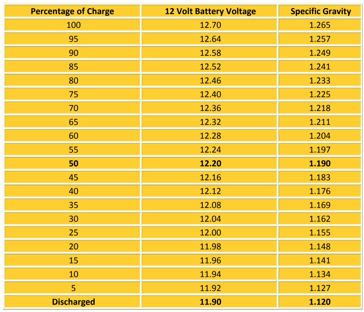

    While not Tacoma specific, Toyota's generic procedure for parasitic draw says less than 50mA. Procedure is attached and is dated Aug 20 so it's recent. Note that you have to latch the hood lock and wait up to 2 hours for all modules to go to sleep. I've had my Taco sit for several weeks and still had 12.3 volts at the battery.

    That's about 37% discharged at STP. That seems high, but could be totally normal for newer, more "electronified" vehicles. Thanks for the datapoint!
