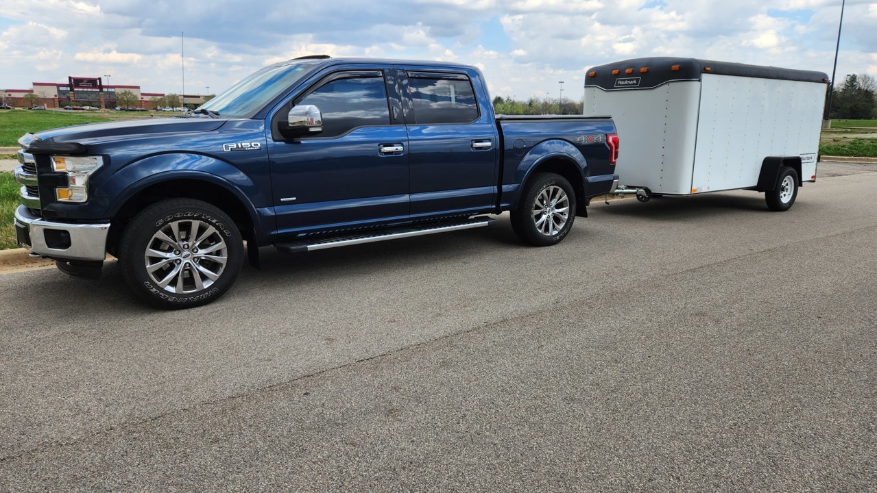

    Yeah I was also thinking of suggesting a Tundra or full size truck too. I know a Tacoma can easily tow 3k as I towed that or close to that in my 12'x6' enclosed trailer when I had my old Taco.

    Yes on paper it'll work but theres more too it. My current F150 blows my old 2nd gen Taco out of the water when towing my mowing trailer. Also are you accounting for added weight like pots, pans, gear, food, water etc? I'd really really really encourage you to read the towing section and be willing to consider a full size!
    This thread and post will help you see the calculations you'll need to make to see where you stand...
    https://www.tacomaworld.com/threads/the-tacoma-towing-bible.4031/#post-35020
    You could ask some questions in the Towing Section too. There's a lot more people over there that are knowledgeable in towing a travel trailer with a Taco.
    Reading that thread really helped me when I got my current trailer and knowing about my towing capacity. Going through my CDL class (I have a Class A) reinforced proper loading and needing to know how to calculate your weight.
