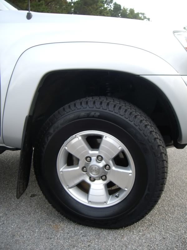

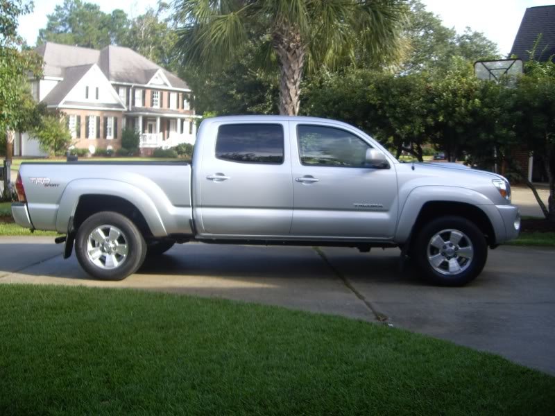

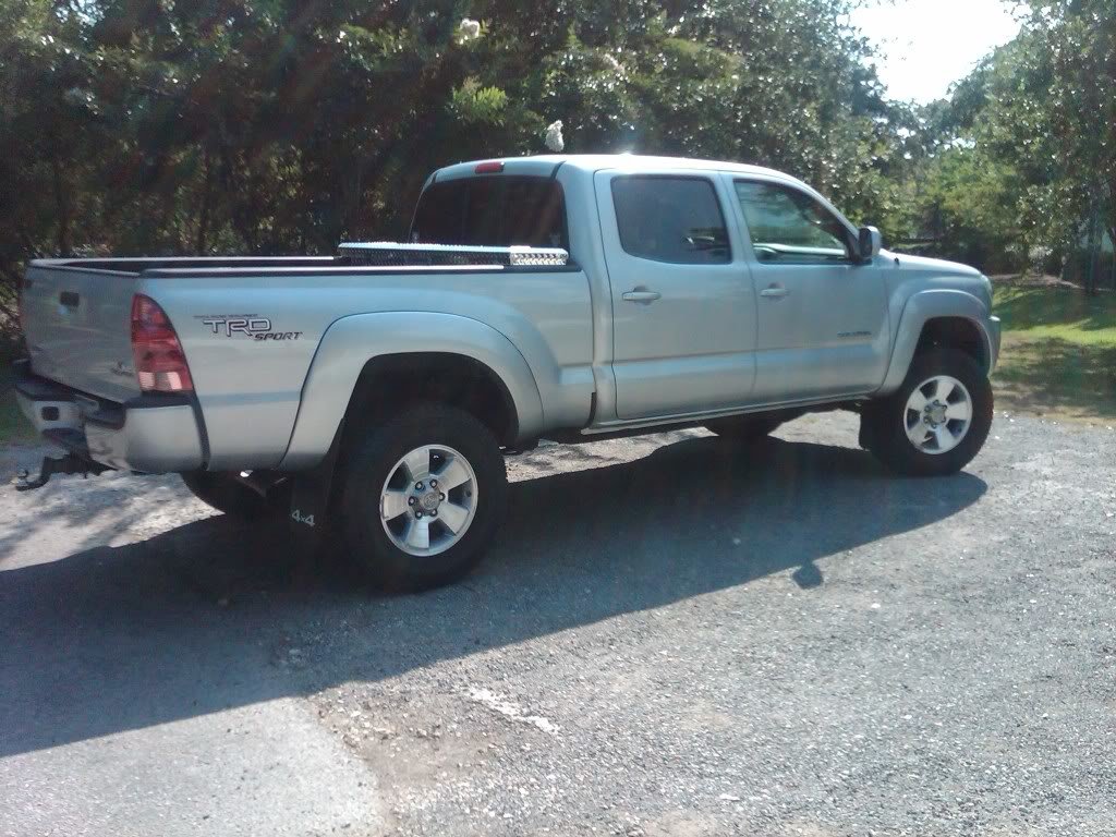

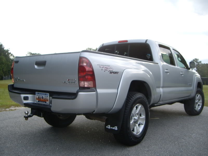

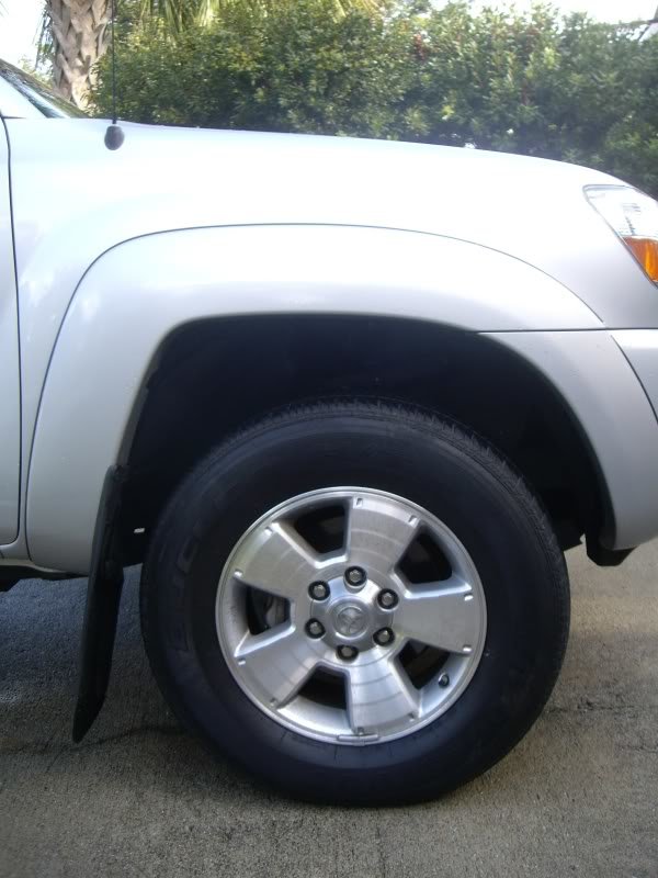

    With my new tires there is about 3/4 of an inch between the tire and UCA and they have yet to rub while cornering, parking etc. Off-roading may be a different story however my truck sees no serious off-roading. I had considered running wheel spacers however the periodical maintenance shyed me away. Wider tire stance would look cool though. Here are some pics.
    Before:
    After:
    Cheers

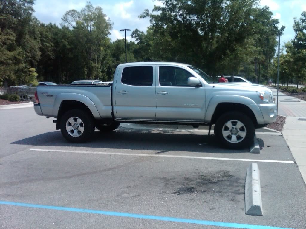

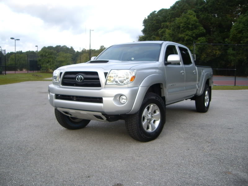

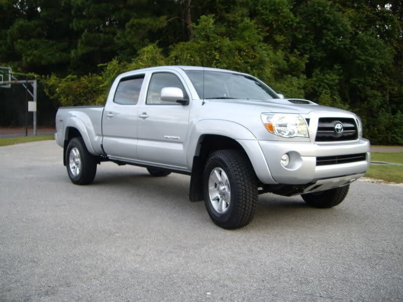

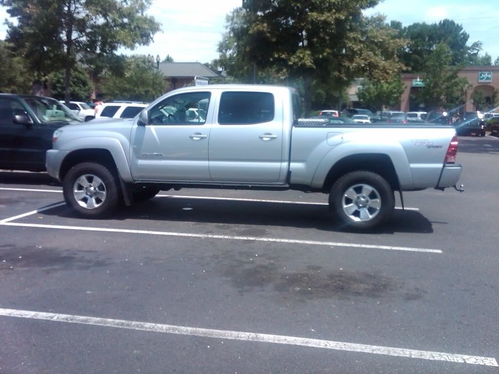

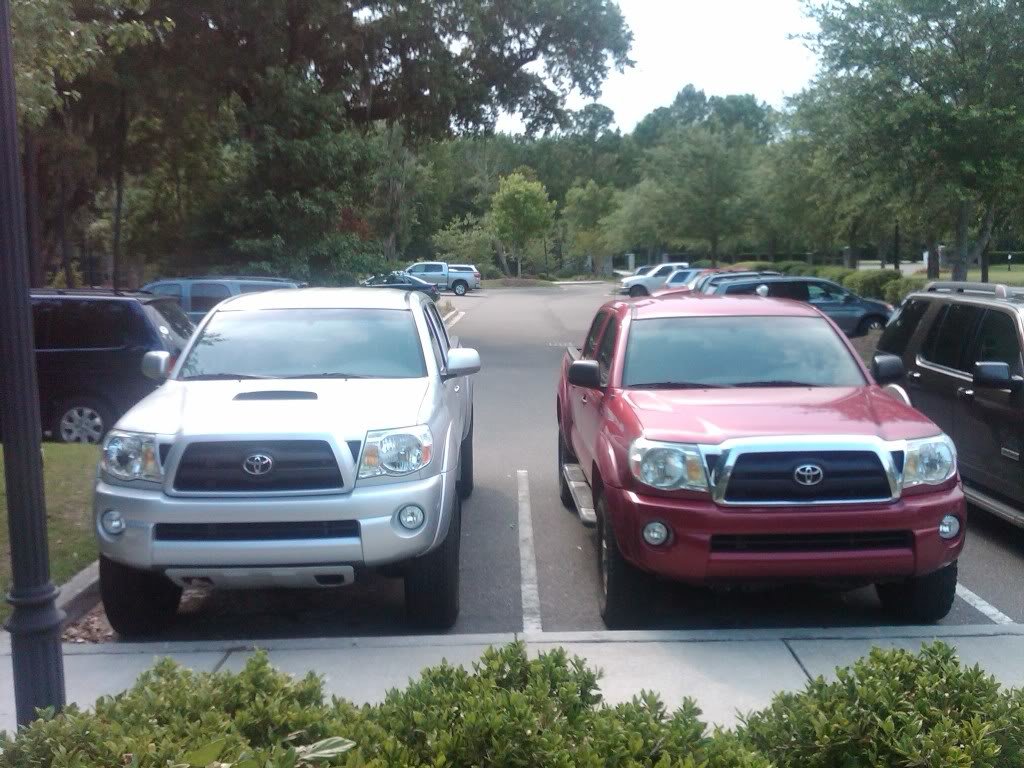

    So I went ahead and installed the ToyTec 1.5" AAL for TSB and also had the front Bilstein's cranked up to 2.5". Prior to this, with the TSB and Billies set at 1.75", the truck more or less appeared to sit even with approximately 1/2" higher in the rear. Now there definitely appears to be some noticeable rake but it still looks pretty good. In hind sight I would have rogered up for the ToyTec coil overs and cranked them up to 3" and it would be perfect. Last week I towed my 4500 lb boat which I thought may settle the rear leafs but it didn't; it does tow a lot better. I took some crappy cell phone pics to illustrate the new suspension.
    This last pic shows me parked next to a stock Pre-Runner and you can definitely tell the height difference when focusing on the side mirrors.
    I may ditch the mud flaps and I kinda regret not buying 285's now. Oh well...I can always replace them.
