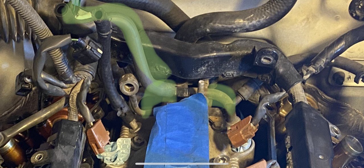

    Given the proximity to the valve cover gasket job- I’d suggest checking the three vacuum lines connected to the IAC sensor. One of them is easily accessible, but the other two are only accessible once the main wire harness is “out of the way”.
    I’ve done my best to highlight them in green.
    I had replaced all of my vacuum hoses prior to my valve cover gaskets, and the two lower ones under the loom were the only ones I couldn’t get to easily.
    I don’t think they were leaking, but the ends of the passenger side were dry and cracked. So I feel better about changing them out, and they’ll be good for another 20 years.
    You might be able to get to them without taking the intake manifold off. Possibly, just the TB and then anything holding the loom in place.
