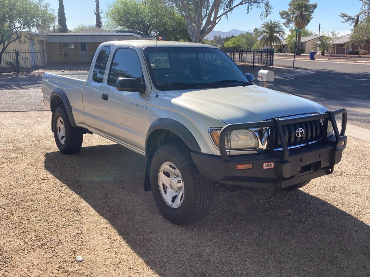

    Here's a pic from our first trip up to my parent's place in northern AZ.
    I'm dead set on doing a 4x4 conversion and also some light mods to make this thing exactly what I want it to be.

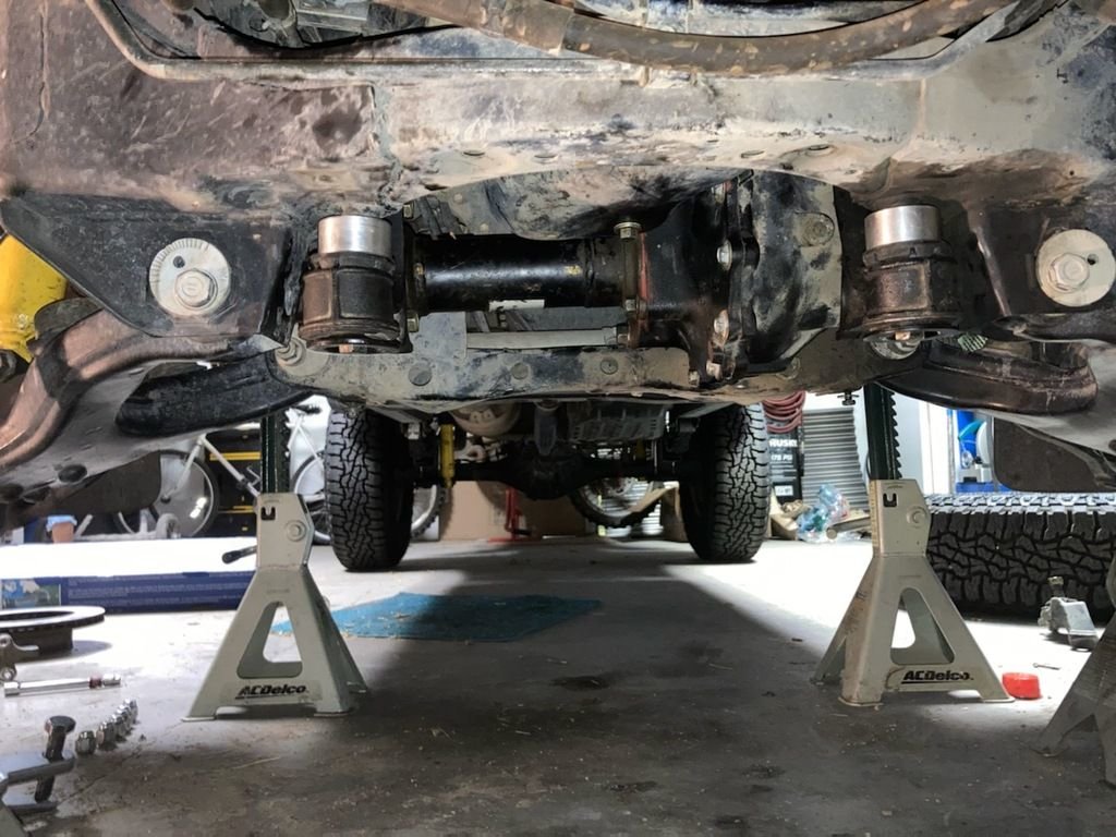

    Since the parts are all about, I'd suggest replacing the bushings in your diff mounts, and install a front locker if you plan on running one at all.
    yotadude520[OP] likes this.

    Solid advice! I'm trying to replace as much as I can while everything is out. Any aftermarket kits that are any good or should I stick with OEM?
    Nvm - did a quick search and found DuroBumps. I'll go with theirs!

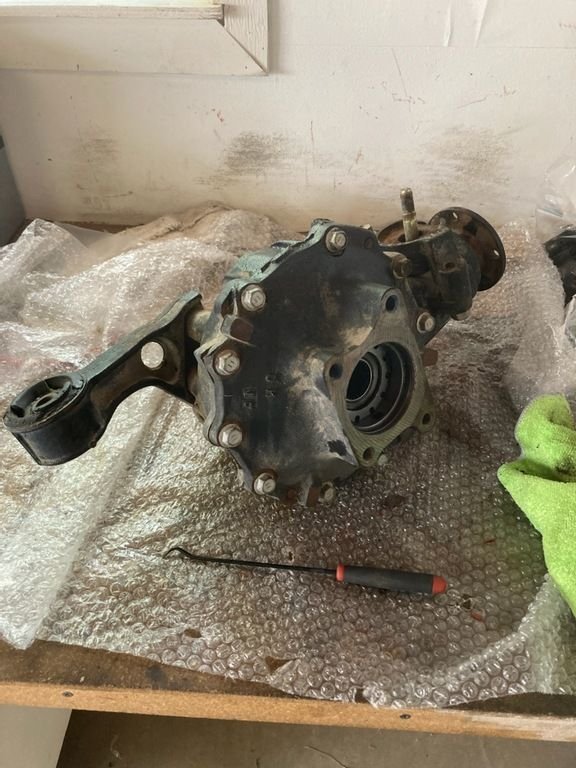

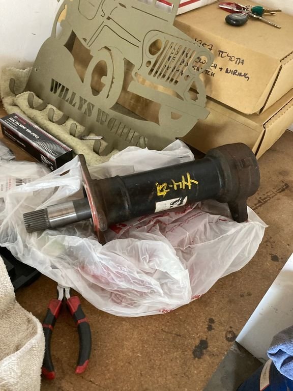

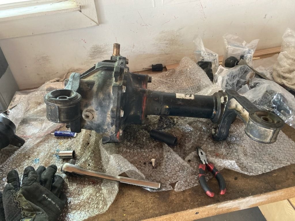

    Since I'm running manual locking hubs, I removed all the ADD stuff on the front diff and swapped over my manual locking hubs diff tube. It was pretty easy to swap over, except getting the small shaft for the ADD out was kind of a pain. I was lucky enough to be able to get it out with two prybars.

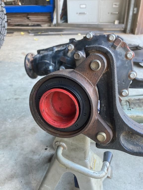

    I also installed new OEM CV shaft seals on the diff before installing it:
    And then up it went into the truck with the differential drop. It fought us a little bit, but finally went in!

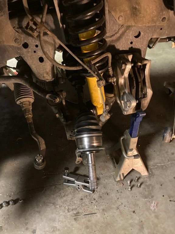

    I took the spindles off to get the bearing & hub pressed out and my new manual hub bearing/hub pressed in. Took this time to install the CV axles too as I couldn't wait to get them in.
    Once I get my spindles back I'll have the front end all buttoned up and ready to go!

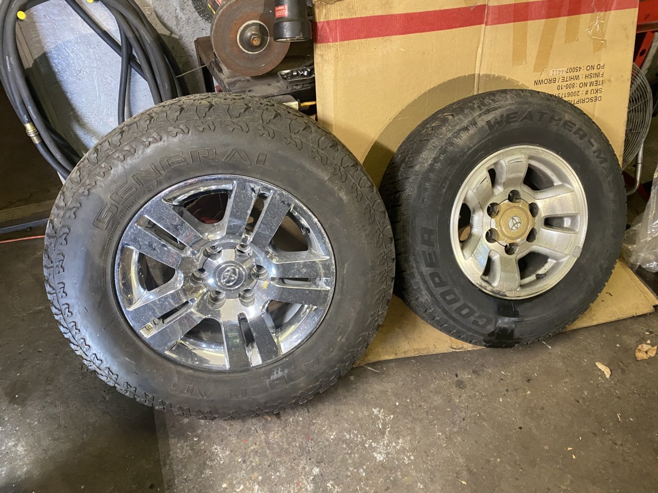

    I am running LT 275/65R18 on a 3 inch lift with the e-locker diff. and the 4.10 gear ratio. Pretty much stock use . No trails or 4X4'ing , occasional towing for supplies from home depot or lowe's ,Tractor supply. So, I should be fine. I like your conversion, looks like fun work. great work there! Thumbs Up!!!!

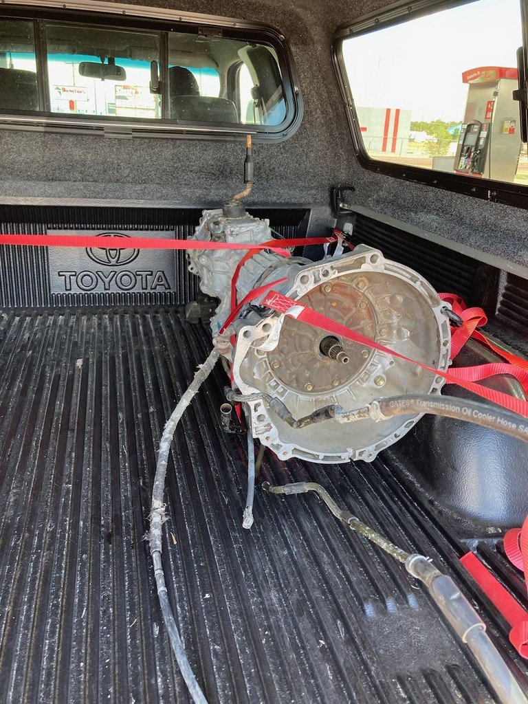

    I also made a quick weekend trip up to the White Mountains to meet @KingOfTheNorth who was nice enough to pickup my transmission in Salt Lake City. I was originally going to pull mine and have a shop swap the output shaft and tail housing - but I found a great deal on this tranny/transfer case out of a 2002 Tacoma from @vonellis . The transmission has under 100k miles and will keep the down time on my truck to a minimum.
    The only issue is that it is out of a 2002 Tacoma - and mine is a 2004 with the electronic throttle body. To fix this, I will have to pull the pans off of both transmissions and swap the valve bodies. Then my 2002 transmission will be ready to roll in the 2004!
