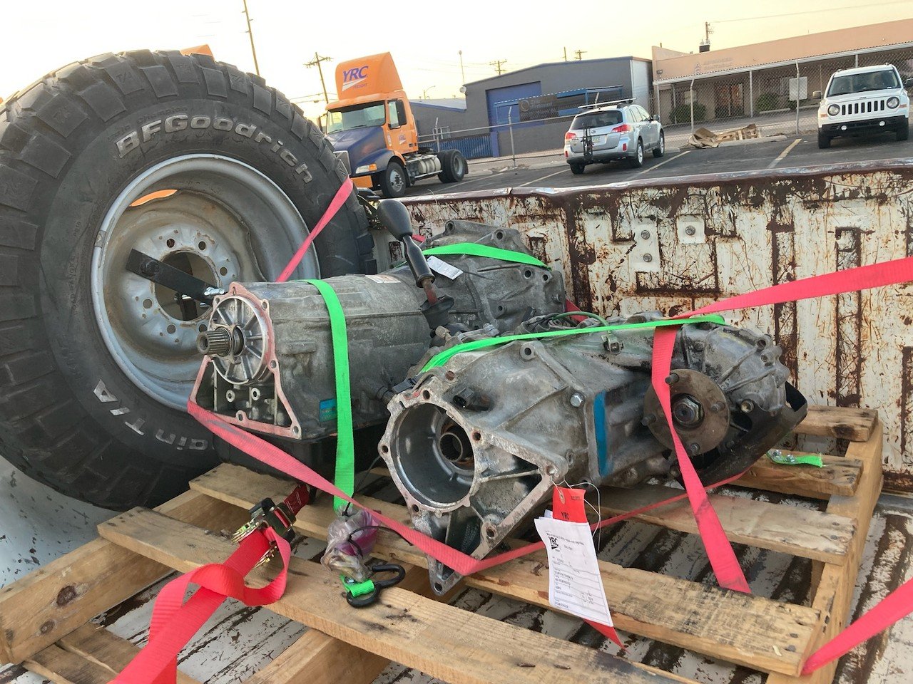

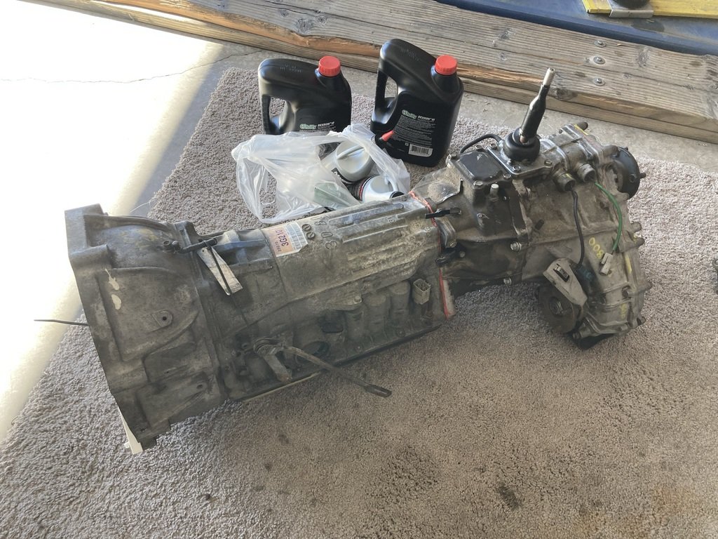

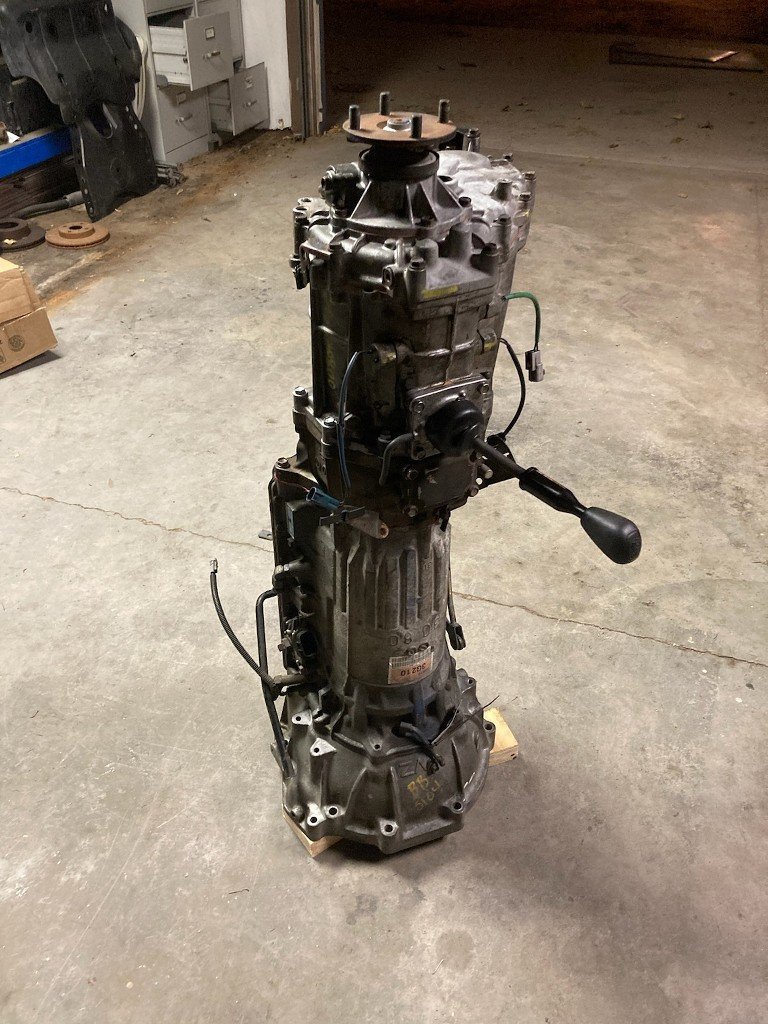

    Time for a little/potentially big update. Sold the 2001 trans I had bought previously as I managed to find one from another member here from an 04 with 125k miles on it. It also had a matching TC. When I picked them up they were apart
    I finally took the time last night to get them cleaned up and bolted together. Ended up using a tail housing from a different transmission as it was cleaner and had the ability to put the forward shift if I wanted to.
    Going to start the tranny swap tonight, hopefully we can get the old one out and the new one stabbed in by tomorrow afternoon. Lucky for me I get to do the work at my buddy's house who has a lift. :amen:

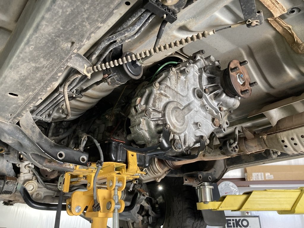

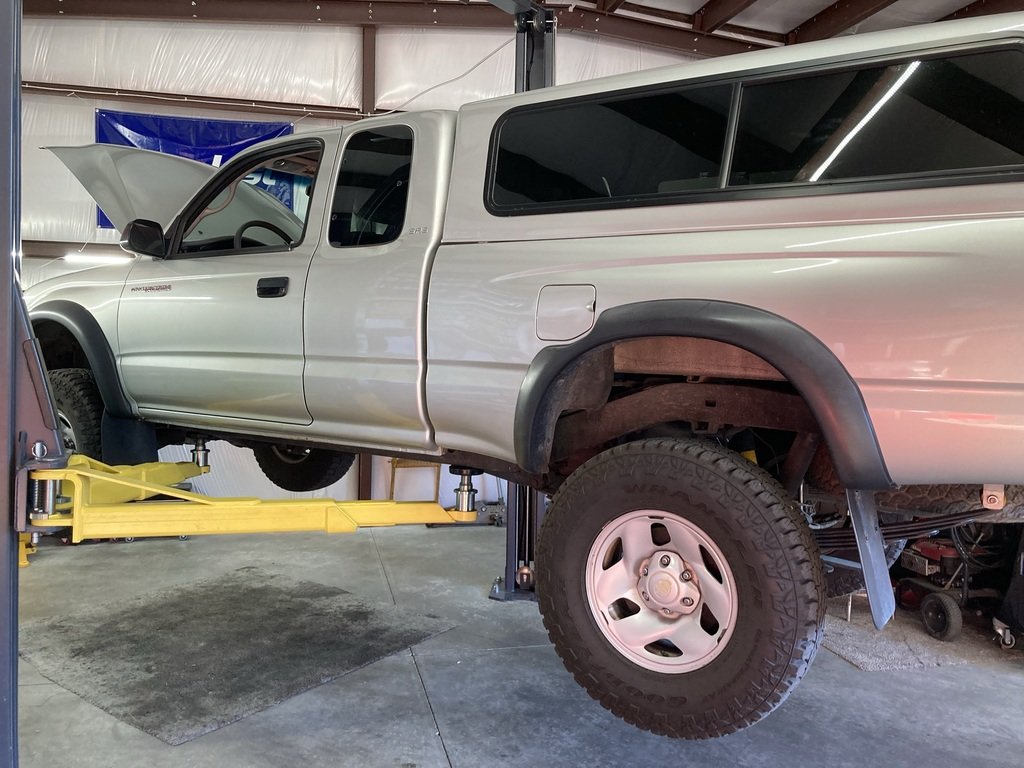

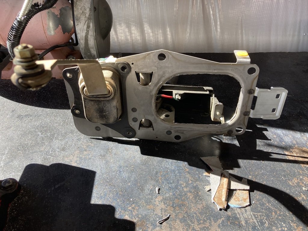

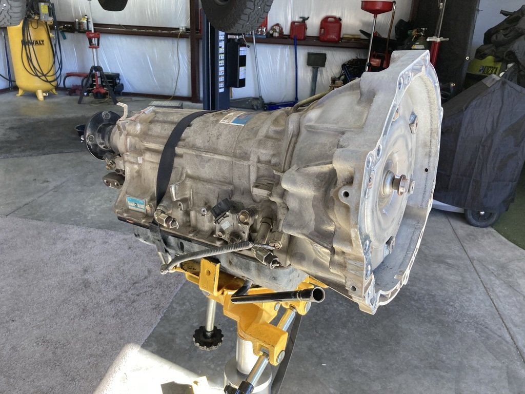

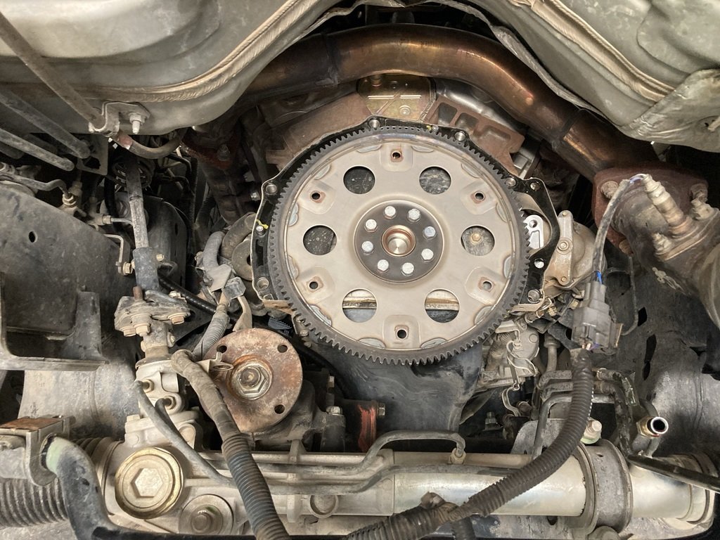

    Conversion successful! Got the tranny in last weekend - I tried to take as many pictures as I could but ended up working too hard towards the end!
    Up on the lift she goes!
    Cut the hole for the transfer case shifter out of my original shifting assembly
    Rw16ss_7c31ce96354412beb1b3c36ef17da8884c2f4b36.jpg n6oLvW_99eecb27f2da0accafebf3b58ba93996fbea41c9.jpg
    Old tranny out and into storage
    New tranny ready to go in and....
    Installed! Buttoned up the crossmember, installed driveshafts and off the lift she went. Overall it went well and the 4x4 works very well - so mission success! However there are two issues I still need to address.

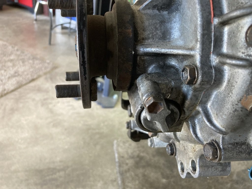

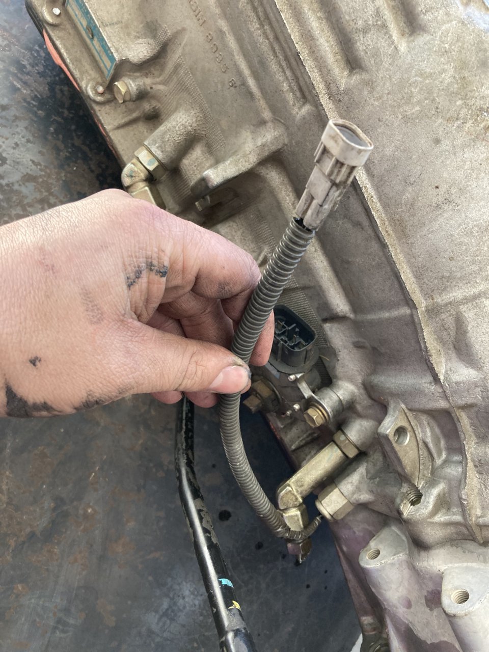

    We couldn't seem to find the other end of this harness for the tranny temp sensor, looked everywhere and it was as if it disappeared. Any idea where the other end is on the wiring loom?
    Also - I was told that the TC and tranny were out of a 2004 Tacoma but there is no speed sensor on the TC, just this plug. Anyone have any idea what the right speed sensor is?
    All in all though, super happy with how it turned out and it's officially 4x4!!

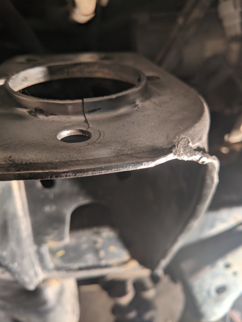

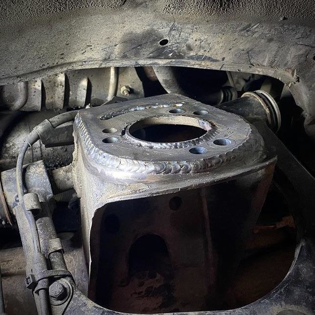

    You're probably looking at the gussets they offer; I'm referring to the top plate.
    The tower cracks over time, and is much more prone to failure than forged spindles.
    Personally I wouldn't bother beefing up a pair of spindles, but instead would focus on the coilover buckets.
    Some say it's much easier to weld with the motor up and out even.

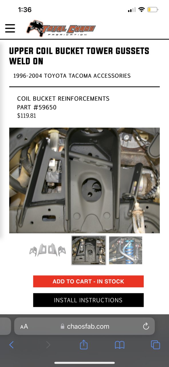

    Thanks for the info, I just looked it up and had no idea. Is this what what your referring to? I can’t really find anything for the top plate 014B3510-A6A4-432E-8299-487602CE1B1F.jpg
  12. Apr 24, 2022 at 1:53 PM

    Cause the spindles don't need any help.

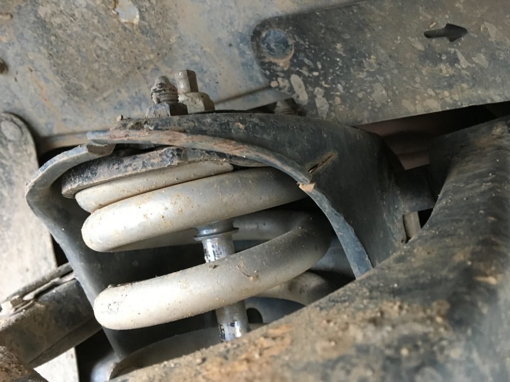

    Here are some random broken towers. There are many threads of this happening -

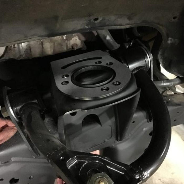

    And here's the reinforcement -
