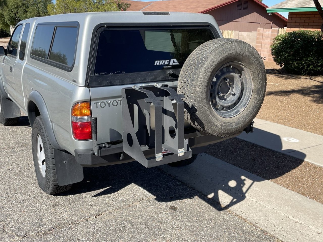

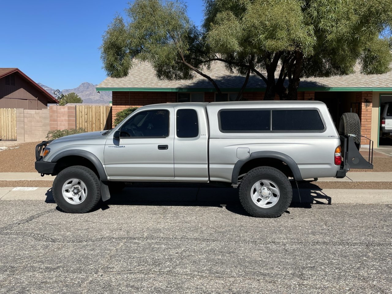

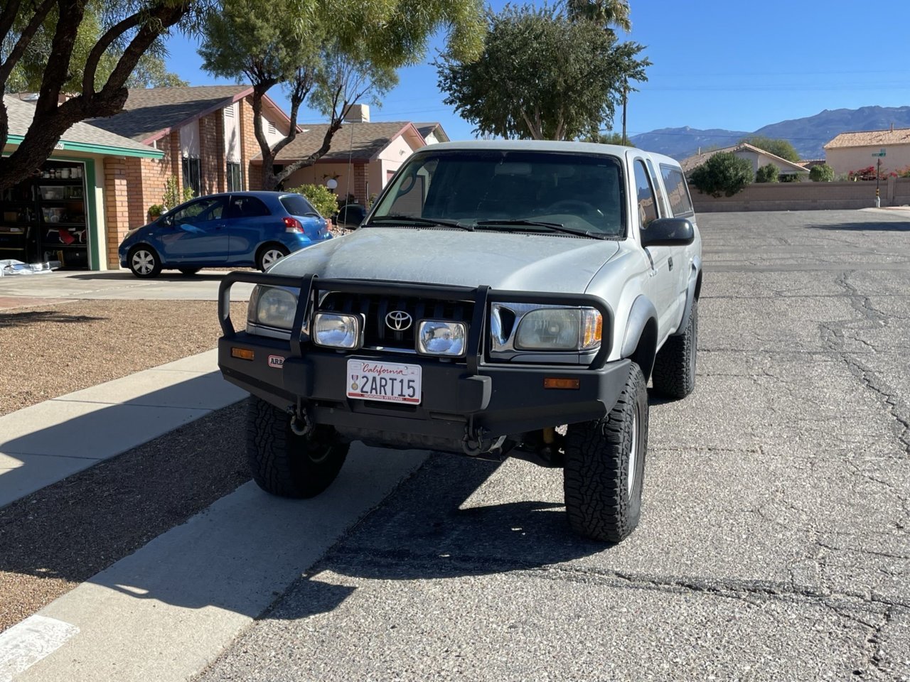

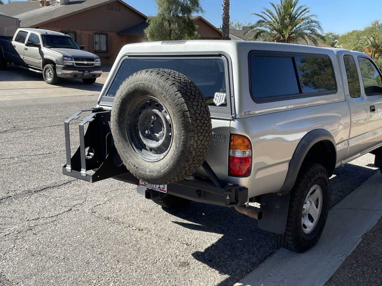

    So I sold this truck to my brother in law and bought a 3rd gen 4Runner but that didn't stop me from finishing out this build! He bought a 4xInnovations rear bumper & I installed some IPF's that I got from @KingOfTheNorth. Truck looks great and is finally on it's way back to CA for him to enjoy.

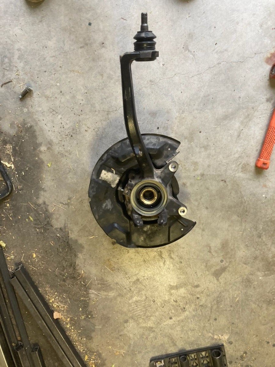

    Did you have to do anything special to keep ABS?
  11. Jun 15, 2023 at 3:47 PM
    #51
    Kwikvette
    Feb 27, 2019
    #284735
    81,513
    Fresno County
    4 run, 2 don't
    As mentioned in your other thread, look at the spindle.
    It has the tab on there.
    If you have ABS, just use your own spindle and get things pressed out and in again.

    Is this the only thing that gets pressed into the spindle?

    Also I noticed in your list @yotadude520, that you have the front wheel seal listed and the wheel bearing listed seperate but the link is to the same item. Is that correct?

    x2! That’s what I did

    Yup take that with your OG spindle and that should be all you need.
    if you buy that kit too you don’t need to get a new wheel bearing it’s included. I’ll have to check my list again but it is considered a front wheel bearing seal
