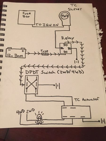

    38
    Also check on TTORA (not much activity nowadays) and Pirate since people sell off IFS shit there more often. Maybe Yotatech since there is a lot of 4Runner stuff there. You can easily swap transmissions in a full day or weekend if it takes longer than expected. The front suspension is easy enough as well. Probably clean and re-grease the spindles/hubs prior to swapping, just a good idea and not hard. Try to get the hardware for the differential too. Otherwise you will have to find some unusual sized bolts. Not hard to find, just be inconvenient.
    Try to get the trans/tcase together. If not be sure it is a 4x4 transmission, the tailhousings are different. car-part.com would probably be a good recourse to use for the trans/tcase/front diff. I bought two FJ80 axles using it with success.
    Since everyone wants gold for manual lockouts.... If you find spindles but no lockouts. Rock auto -> 98 Tacoma -> 3.4 V6 -> Brake wheel/hub -> lockouts, $104 a piece. Thats cheap for brand-spakin new factory Aisin's. I almost want to buy them in case I buy another 1st gen next year. You wont find a better price on those new.
  2. Jan 18, 2016 at 11:24 AM
    #22

  10. Jan 19, 2016 at 8:44 AM
    #30
    ZomBaja
    ZomBaja Well-Known Member
    Nov 12, 2015
    #169390
    96
    Dustin
    Central MS
    2002 Doublecab TRD Prerunner
    The "TC Actuator" is the actual connector on the T-Case.
    There's 5 pins. Laid out in that format. (In case you decide this route)
