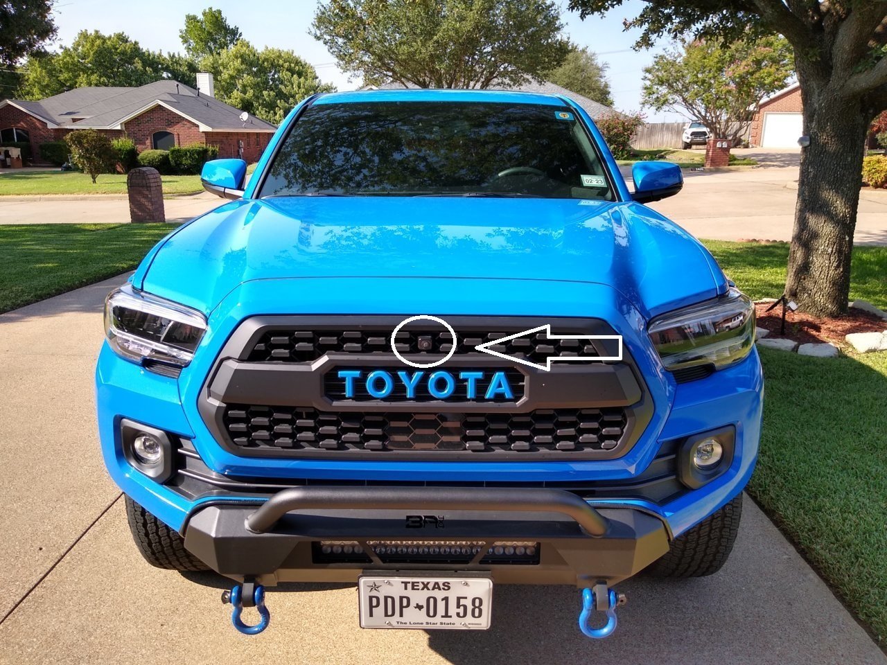

    I did what you did. I traded my TRD Offroad OEM grill (with TSS sensor & front facing camera), for an TRD Heritage grille. You will not have a TSS light on after you install it. It was very easy to swap out and install. Here are the before and after pictures:
    I like having the front facing camera up that high. It gives me a better angle of what is in front of me. Before (on the OEM), it was only looking directly at the bumper. Now I can see a few feet in front of me.
    I haven't had any issues at all with the camera or TSS sensor or garnish plate for the sensor.

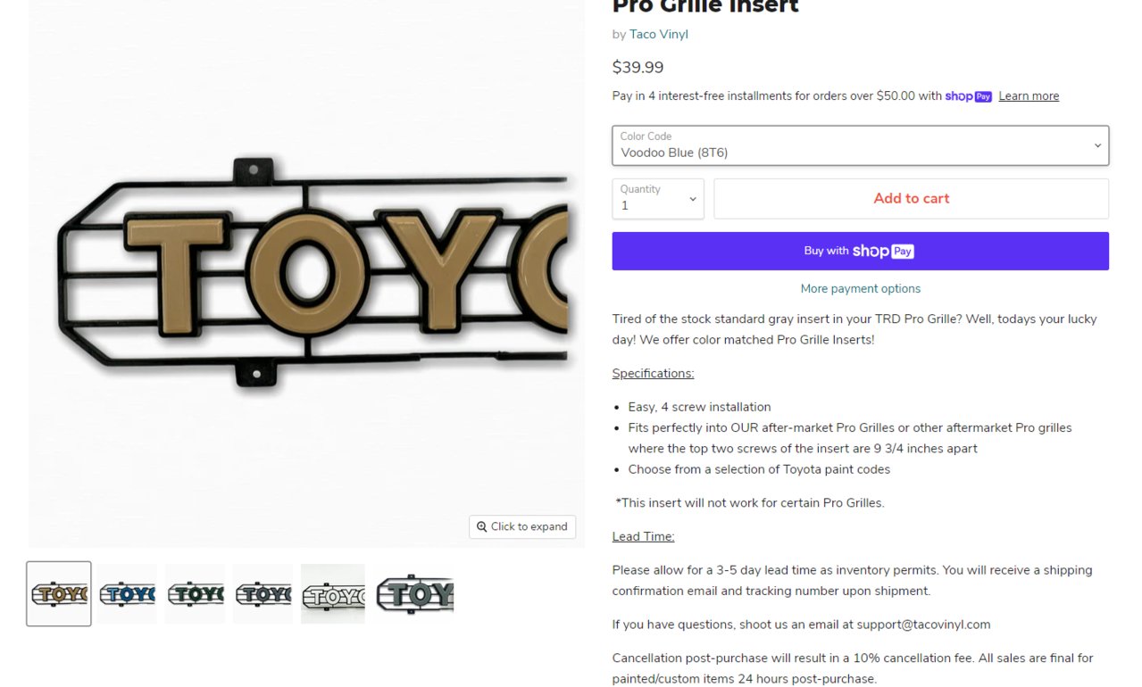

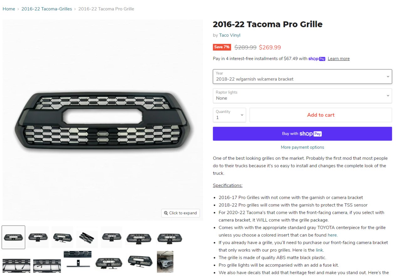

    Same experience for me. I went with the Taco Vinyl grille with that came with the garnish pre-installed and a front camera bracket made specifically for their grille. No TSS light and no problems with the front facing camera. Everything works fine. If I can install it and not have an issue anyone can, as I will be the first to admit I am mechanically impared LOL.
